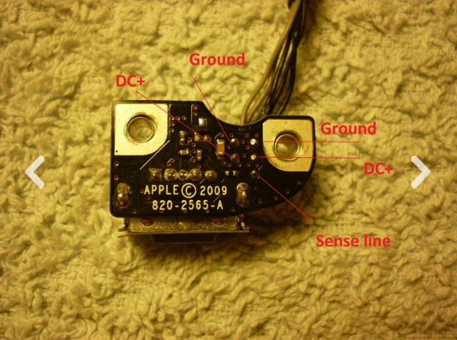

I found this picture that shows the outputs on the magsafe....So with the replacement magsafe that's currently installed in the MBP and while i had the charger hooked up to it, I took my DMM and looked at those points and the DC+ im getting 16.8V which i believe is accurate and is supplying power to the board....does the sound right? If so what else can I try/test to fix this thing?
