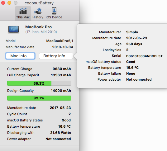

The battery arrived. I changed it manually. It works fine. But I have one question. According to CoconutBattery, it has 2 cycles. Is this normal? I am not worried about it, it is like a new one, I am just wondering if it is normal, and if they are delivered like this all the time, or it should be with 0 cycles.

Yes, it is common to have 2 or 3 cycles on a new battery as they were probably tested for a couple of charge cycles before being shipped.
Apple doesn't recommend calibrating the battery if it came from them. I assume it came from a third party so you might want to calibrate it.
