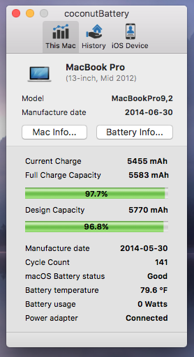

Thanks for the suggestions, Fishrrman. I'll try them and post the results.
Coconut Battery test - screenshot attached.
Have yet to run the battery down to 50% - will do so and let you know what happens.
Thanks.
Thanks.
Unless it has discharged to below 93% it will not charge back up again this is to protect you battery just don’t worry about it it is working normally we know what you mean this is just how they work.
Once it is charged to 100% it will not recharge back until it is below 93% again.
Take it off charge and see how it runs on battery check out how long it lasts etc and use it as a laptop. Then charge it back up and leave it on charge it will fluctuate between 93% and 100% as it slowly discharges to protect the battery while shutdown and runs off the mains when in use maintaining current charge while it runs on mains power.

Thanks for the explanation, Samuelsan2001. Greatly appreciated 🙂 I'll run it as you suggest. Any idea how many hours it should run on a good, fully charged battery?
Well it’s five years old assuming it’s the original battery and it’s not too intensive use (internet streaming, documents etc) and you have screen brightness at 75% then I’d say about 5-6 hours for a 13 inch machine but it’s almost impossible to say really. They originally quoted 8hours on that machine if I remember correctly.
Thanks to every one who replied. Very helpful. FYI I let the laptop discharge to 50% and then charged it back up to 100% - no problem. All appears to be well 😉
