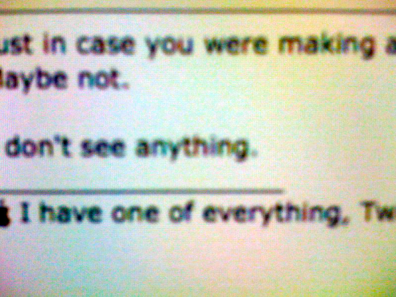

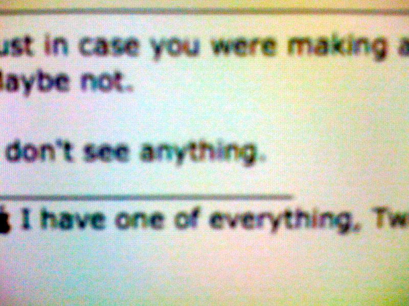

Okay I have a couple of photographs attached that sort of show the problem. Turning the sharpness all the way up to 100 exaggerates the problem, and turning it down to 0 makes it pretty much go away, however the text appears blurry.
The first picture is on 50 sharpness, and the second picture is on full (100) sharpness.

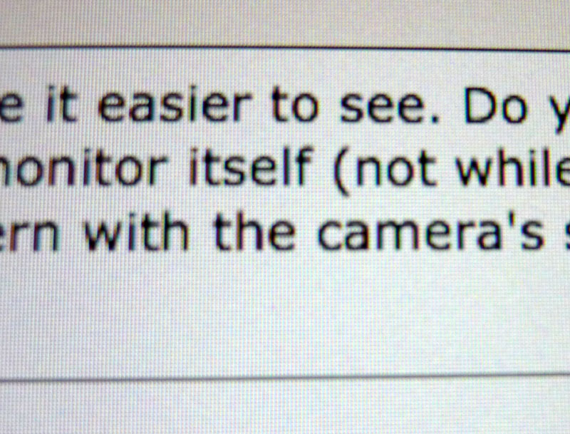

Here's the photo after some enhancement to exaggerate the colors and make it easier to see. Do you see the large blotchy colored patches (pink on the left, blue in the middle, and yellow on the right) on your end on the monitor itself (not while looking at this picture), or is that just the camera? (it's possible that the LCD's pixels are creating an interference pattern with the camera's sensor that could cause that effect.) If you are seeing that, there might be a problem with the monitor itself.

The iPhone camera is making it worse. The individual colours are not so noticable it looks more like a pink outline against certain letters.
In the sentence "Just in case you were making a funny":
The "J" and "t" in "Just", the "i" in "in", the "u" in "you", the "g" in "making" the "f" in funny" and also the first "n" in funny, but not so much the second one all have a pinkish haze around them.
I sit about 1.25 feet away from my monitor, and in the first picture I posted, that is what the problem generally looks like, but from the distance I am sitting it appears more subtle.

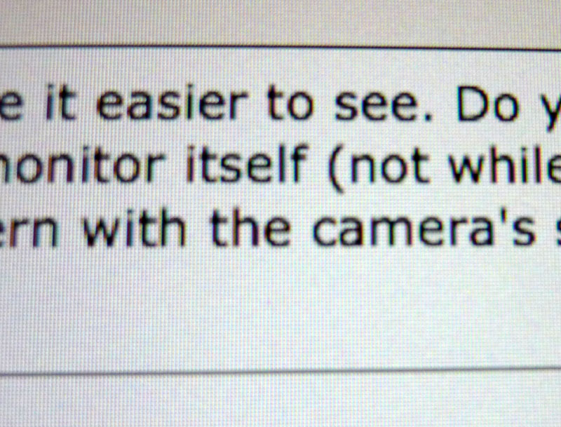

Here's what mine looks like. The colored edges are noticeable in the picture but not when I'm using the monitor.
That's pretty much an enlarged version of exactly what I'm seeing with my eyes.
