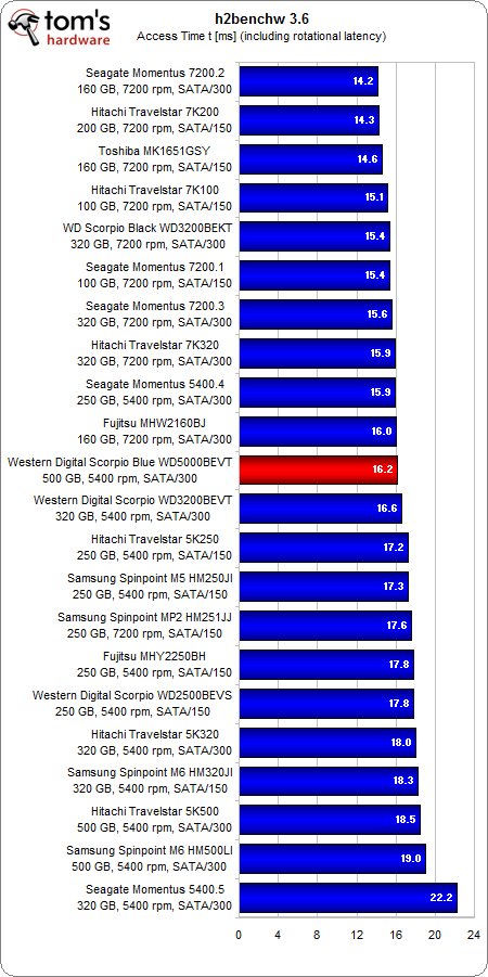

This isn't really true, the WD Blue 5200rpm 500gb drives are as quick as the 320gb Scorpio Black.
http://www.tomshardware.com/reviews/scorpio-notebook-hdd,2109.html
Really? I beg to differ.
http://media.bestofmicro.com/L/U/173154/original/h2benchw-read-performance.png
Down .2MB/s to the 7200rpm Black
http://media.bestofmicro.com/L/V/173155/original/h2benchw-write-performance.png
Up .5MB/s over the 7200rpm Black
http://media.bestofmicro.com/L/T/173153/original/h2benchw-interface.png
Down 9MB/s on a theoretical test against the 7200rpm Black
http://media.bestofmicro.com/L/S/173152/original/h2benchw-access-time.png
Down .8ms from the 7200rpm Black
http://media.bestofmicro.com/M/0/173160/original/pcmark-file-write.png
1.7MB/s quicker than the 7200rpm Black
http://media.bestofmicro.com/M/1/173161/original/pcmark-xp-startup.png
Down 1.4MB/s from the 7200rpm Black
The point is they are neck and neck in performance, and you get an additional 180gb extra storage for the same price.

That said, my first comment was in comparison to the stock 5400rpm drive the 13" MBP comes with, not the Scorpio Blue.
Hey, it's your link!
What would you have preferred I used when it comes to faster access to your data on a HDD? And both the Black and Blue versions have the same amount of throughput, so which benchmark would you have used?
No doubt that a 7200rpm drive is quicker than the stock drive, I was trying to show that a Blue will perform just as well at lower RPM. But yeah, it seriously makes a huge difference over stock.
