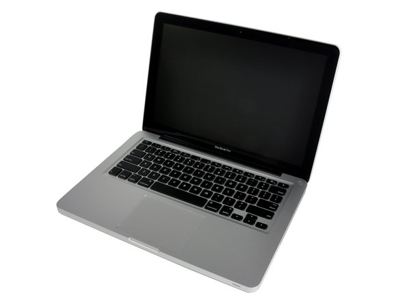

I looked everywhere but I can't find how to "reseat the speaker connector(s) on the logic board."
I think now that reseating the speaker connector is not a fix. After reviewing disassembly steps, left and right speakers have separate connectors on the logic board. I wrongly assumed that the 13-inch had both speakers in one connector.
If you want to check that out yourself, here's a link to iFixit's online repair steps for your MBPro.
So, no sound, no boot chime, even after a reset. No boot chime, even after a PRAM reset is a hardware issue, not software.
The "disconnect", or common point, if there is one, is a broken headphone port, so that's what I'm thinking, as you don't get any response from the system when you plug in headphones, and no audio there, either.
The damaged port is on the logic board. If that is actually good, then you are left with the sound chip, also on the logic board. The result from either is no sound from the normal audio output.
The fix is to replace the logic board.
Another fix, with much less expense, would be to use a USB sound card of some kind.
But, that leaves your portable, well, less portable, as you would need that external dongle, plus external speakers/headphones if you want to play to any audio whatsoever.
There would also be possible solutions with bluetooth, or thunderbolt external interfaces, but your internal audio is, so far, dead.
