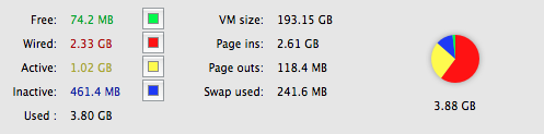

Hey guys,
I have been using Vmware just for some MS Office stuff, and the i7 processor runs it fine it doesnt get hot, fans arent running too loud but after looking at the memory info it seems there is none left? OSX also becomes laggy too.
I am running WIndows 7 Standard, 1.5 GB Allocated and 2 Cores allocated.
But the memory for some reason reaches up to 26mb left?
I have 4GB Standard, is this just common when virtualising as the wired ram reaches 2.5 GB and i thought wired ram was just ram allocated to osx?
thanks
Just a few screenshots...
The bottom screenshot shows my mbp running just normal e.g. internet but it only says 2gb free, the other 2gb is distributed to inactive, wired etc but i am only running safari? can anyone help me with this?

after spending his much on this mbp i cant afford to fork out £400 on ram! 😀 but is this just due to lack of ram, i thought 4 gb would be plentyyyy!
also remember that OSX will start using some of that 'inactive' memory when it needs to. On my Win7 VM, I've allocated 1GB due to similar experience.
thanks for that so inactive ram is basically free ram ... ok.
but why do have 1.5GB of active ram when the only thing i have open right now are safari?
would resetting the pram solve this?
reset the pram - got 2.5 GB free memory back.. still cant get my head around where my other 1.5 gb goes? i have 1.5 GB allocated to Vmware .. does this mean i cant access the 1.5GB it when using just OSX?

Your RAM's fine if that screen shot is of when your VM is running. Your Page Outs is a small (<10%) fraction of your Page Ins. When it gets to 1-1, get more RAM.
8GB in your MBP would be better, but you probably don't need 1.5GB assigned to your VM. This does get fully reserved by VMWare.
I find 1GB works pretty well for Win 7.
Don't worry about how the RAM is allocated. Safari will release it if it's needed. If it's not needed it'll look like it's taking up increasing amounts.

tbh man im not seeing anything wrong there....
once RAM is allocated it takes while to be "released" from OSX - thus why a whole chunk of Inactive RAM is taken up.
as plinden has said, your page outs are minimal at best. no need to worry at all! 😀

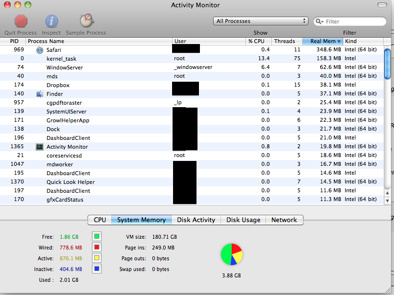

Post a screen shot of the entire Activity Monitor window with the System Memory tab selected, and sorted on the Real Memory column.
yes i began to believe that the virtual machine kept the ram.. screen shot says 2gb used. but where is it going?
could anyone else just upload a screenshot of activity monitor with just safari running with 1 tab to compare?
That looks pretty standard. Nothing to worry about.

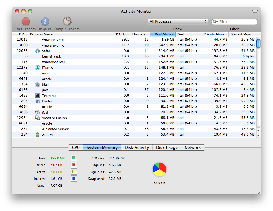

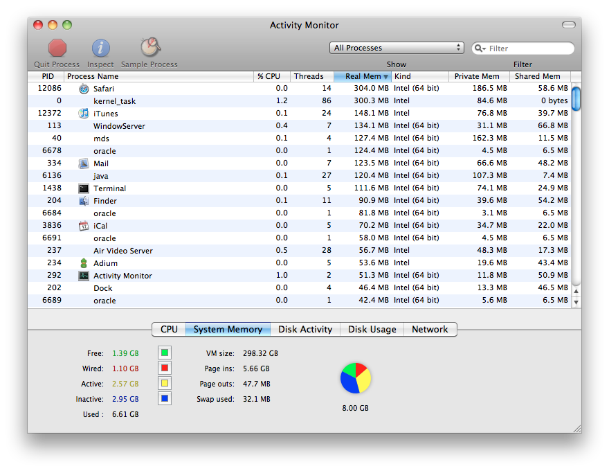

Here's mine with a 8GB RAM MBP, with a 1GB Win 7 VM and a 512MB Linux VM running. And after shutting VMWare down.
By the way, VMWare doesn't release RAM immediately. It writes the VM to disk in the background and can take a couple minutes to completely shut down.
