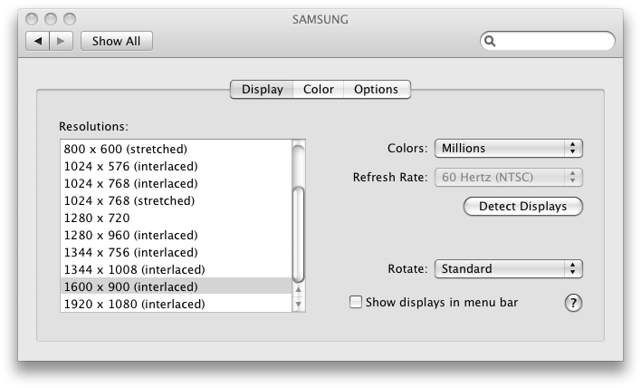

So I just got an LCD TV with HDMI and VGA inputs. I originally had my laptop running with a DVI to HDMI connection in to the TV. For whatever reason, I couldn't get a good quality picture... it was alright, but just off... hard to explain I guess.

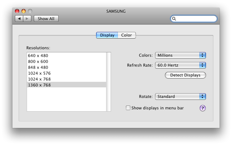

I figured that using a VGA cable (With a DVI-VGA adapter) that I could get a much higher resolution. What I end up with is 1360 x 768. I can't select any higher resolutions in Display Preferences so is that as high as it can go?
I had a 20" LCD monitor (not TV) previous to this and I think that I could select a higher resolution on that. Is it just a limitation of the TV?
The resolutions I got with the DVi-HDMI were:

The resolutions I got with the DVI-VGA were:

It depends on the maximum resolution of your TV.
My TV is 1080i, so the maximum resolution (the actual number of pixels on the display) is 1366 x 768. For some reason, the MBP only ever does 1360 x 768 over VGA, but I'm not broken-hearted about losing three pixels' worth of vertical resolution per side.
It looks like your TV is 1080i like mine, because even over HDMI, the maximum resolution you were allowed was 1920 x 1080 interlaced, which is 1080i. There's really nothing you can do to bump the resolution higher; the TV simply isn't capable of pushing more pixels than 1366 x 768, because that's all its display has.

Jon,
Try the DVI->HDMI connection again and this time try setting the overscan option under "options" (see the screenshot in your 1:07 am post). When unchecked (in 1080p mode) the picture is letterboxed all around and not crisp since everything is squeezed.
