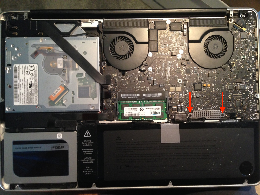

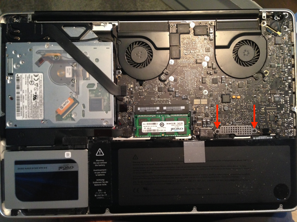

Sorry to revive an old thread but if anyone stumbles across this thread and is having this issue I found a band aid "fix". Same vintage laptop and symptoms as the OP. Loosening the screws for the keyboard and trackpad connector shield (arrows) largely caused this issue to disappear. Not sure why this would have this effect...
