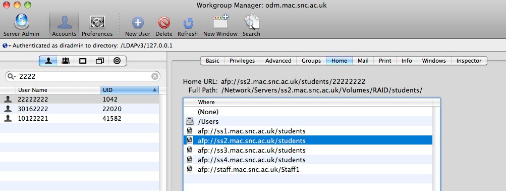

Are you the server administrator? If you are, you most likely don't have the user accounts' home folders configured correctly. Can you post a screen shot of the Home tab in Workgroup Manager after selecting a user?
Should look *sorta* like this
Checked the Home tab in work group manager and the user onlt has /user
no other drives or shares.
I take it this isn't correct?
