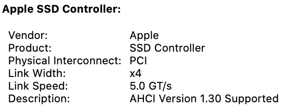

You may have to remove the drive to see. I ask because I was asked to have a look at a mid-2014 15" i7 that would shut off randomly. Turns out changing the drive from a ssuax to ssubx stopped this from happening.

Actually, look at the SATA option of system report and look at the link width. If it's 4, it would probably be an SSUBX.
The link width is 2. The model shows as Apple SSD SM0512F.

It's a Samsung SSUAX as I don't think Apple used Toshiba or SanDisk for their 512 GB SSD.
I know it seems strange but, as I said, I had a mid-2014 15" i7 16 GB and it would randomly shut off. It did not matter how full the battery was or wasn't, whether the charger was or was not connected, or whether it was running High Sierra, Mojave, or Catalina. I could install the OS and it would not power off. Once I boot to the desktop, start using Safari, or just look at my preferences, it would power off. It could be anywhere from a few seconds to a few minutes after logging in that it just powers off.
Switching from an SSUAX to SSUBX stopped this from happening and has worked perfectly for weeks since the drive swap.

All I had to do was change the SSD from a 2-lane model to a 4-lane model. I already had a spare 4-lane drive so my fix was free 🙂
