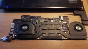

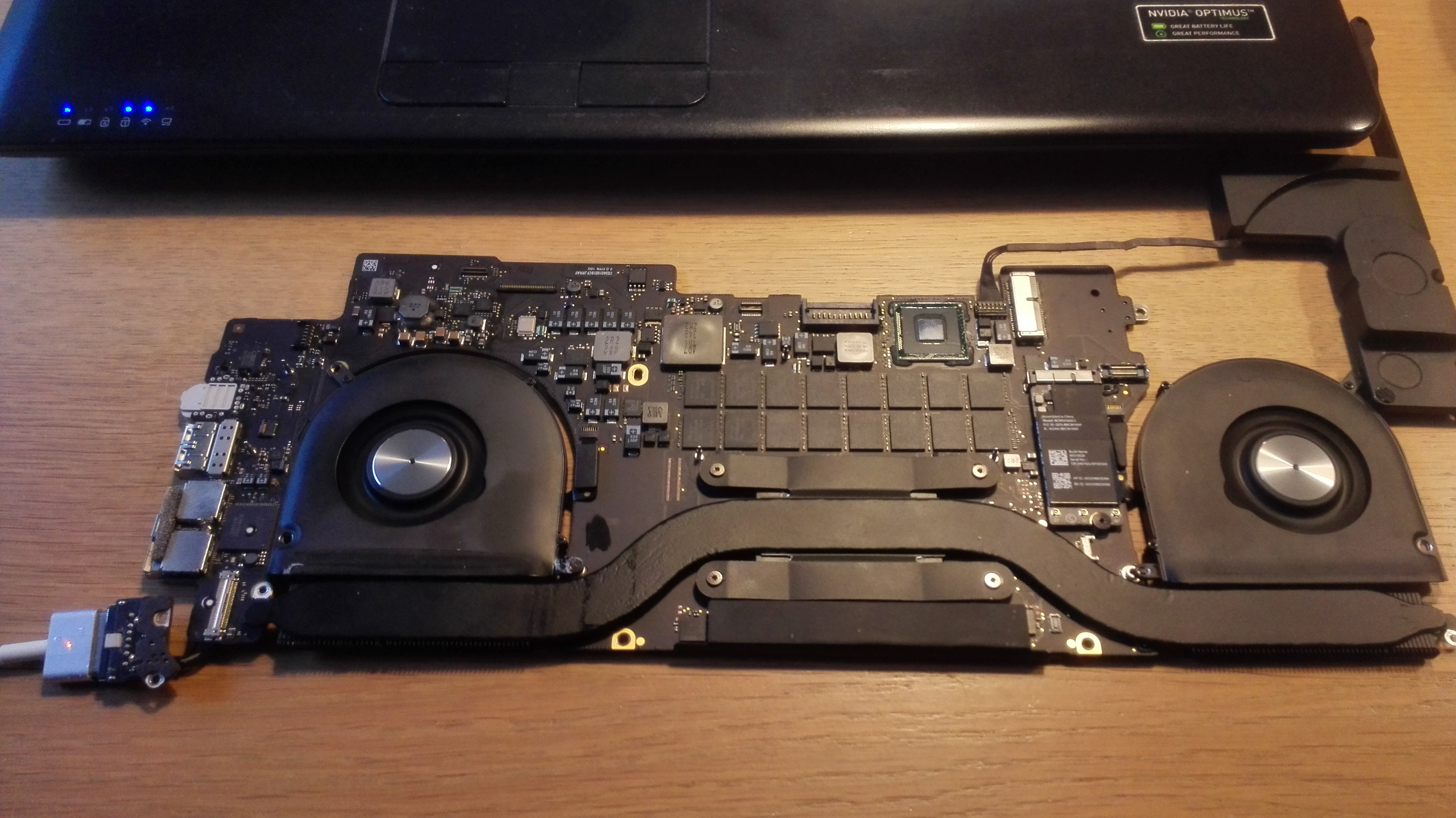

Hi everyone,
I have the following problem, see photo how i test the motherboard.
Adapter start with green light and goes to orange and the fans are running directly and goes to high speed.
I have measure a lot of points but , i don't know where the problem is. No chime and no display. Backlight is well on the screen .
I think it is an heating problem but which components and where to look?
I bought this macbook pro and it was with a cracked screen. I replaced the lcd but no screen only backlight.
Can somebody help me or give some hints to look further
