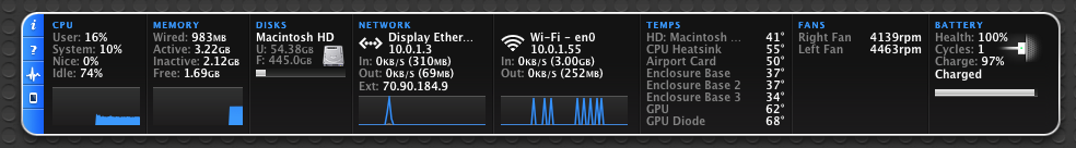

Attached is a picture of my iStat with the computer sitting Idle connected to the Tunderbolt Display with clamshell closed.
GPU is almost 70C degrees!
Anyone else seeing the same stats or different?

OK, I installed iStat. Those numbers look normal for this machine. Editing photos in Aperture with the rMPB currently undocked from the Thunderbolt and using the retina display, may GPU is at 63 degrees and the diode at 68 degrees. Fans are running about 3,2000rpm, but at that speed I can barely hear them. They could be kicking in more significantly in clamshell/docked, but I really haven't noticed. Maybe it is just because this machine is SO much quieter than the 2011. Have you installed all updates?
Yep. And like I said, the fans are quiet, it's just once they past 4000rpm they become noticeable, and they are constantly at that speed connected to a TB display.
I'd like to see someone else's stats when connected to a TB display as well.
The ONLY reason I bring this issue up is because my 2011-MBP was more silent at idle than this thing is when connected to the TB Display. It's slightly a step backward in that sense.

What are you doing to get it that hot? Idling my laptop's GPU is at 40-50°C, and rendering a 1080p video in After Effects barely got it above 60°C. By any chance are the vents on the sides covered? Also, what's the ambient temperature in the room?
Do you guys all have the 2.7GHz model? Are you connected to a TB display with the clamshell closed?
I'm not doing anything but browsing the web. No the vents aren't covered. Temp in the room is 71F.
