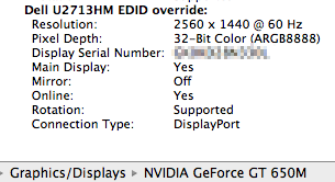

I have a U2713HM hooked up to my thunderbolt port with a miniDP to DP cable and it's using YPbPr instead of RGB.
Here is the relevant snippet of ioreg -l.

I was looking into overriding the IODisplayEDID but I didn't know which bit to change to force it into RGB.
Which problem did you fix? The color issue or the wake from sleep?
I fixed the color issue when the display is connected via DisplayPort. I don't have any issues with sleep.
Please try the file I sent you (copy to /System/Library/Displays/Overrides/DisplayVendorID-10ac and reboot). Now you should see "Input Color Format: RGB" in the color settings of the display and "Dell U2713HM EDID override" in your system report. Please tell me if that works.
Worked perfectly. Thank you!
Great work. But I can't find the /Displays folder in the Library?
You're probably looking in the wrong 'Library' - there are several. You want
Macintosh HD -> System -> Library (not the one at the top level of Macintosh HD or the one in your home directory).
