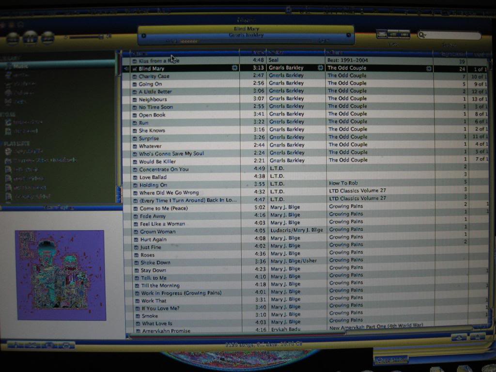

So I decided to install Windows because I needed to use a piece of software and I didn't feel like using the software on our 9 year old HP desktop. I've installed Windows/BootCamp before but that was back in the Tiger days. I had no issues and removed Windows promptly after I was done with it.
Anyway, I used "Startup Disk" in System Preferences to start up in Windows, and my screen looked blue/greenish/fuzzy. I restarted the computer (back into Windows) and everything looked fine. Fluke I thought. Windows doesn't belong on a Mac anyway right? 😀
Did what I had to do, went back to OS X, no issues.
Then I went back to Windows again, there goes that fuzzy issue.
But guess what? Now it won't go away. 🙁 And the issue appears in OS X now!!!
Here's what it looks like:
But here's the kicker... it doesn't happen on an external monitor...
What do I do here? 🙁
I saw a similar problem with an old Dell laptop a customer brought in. I believe it could be either the LCD panel itself or the LVDS cable that connects it to the logic board i dont remember exactly. But take it in the applestore or service provider and have it looked at. The dell outputted fine to an external monitor like yours, eliminating a bad GPU/VRAM and other components.
As far as Windows causing the issue, it probably was a fluke.

I found this on Apple Discussions.
It absolutely appears to be related to installing windows on bootcamp, and then installing the drivers from the leopard DVD. Sad, but maybe apple can fix this.
Resetting the PRAM or something like that fixed it.
Do this:
Restart,
At Restart Hold Down cmd+option+P+R It will reboot again pretty quickly if mine is any indicator, let go, and mine looks perfect again!
Woo Hoo!
Best, and hope it works,
Brian
