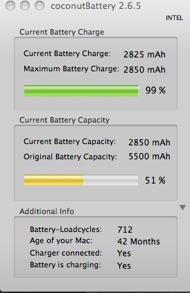

I have a 15 inch Macbook Pro (bought in 2006) so, pre-unibody design.
There has been a long time that i've just though my problem was due to the battery being old and all, but today while *attempting* to use it away from the charger, it shut down at around 90-80% like usual. Then i flipped it over and checked the battery indicator on the underside of the computer to see if it truly was the battery, and it's indicating 4 out of 5 lights are on, which means almost a full charge! 😱
any ideas as to what could be causing this, and any fixes to it? no money for a new macbook at the moment unfortunately 🙁

Try using it without the battery and see if it still shuts down. Also, what does coconut battery say about your battery?
eek. 😱 that explains a lot.
and it doesn't happen when it's plugged in, but the picture tells me exactly why it's happening. the battery is crap/:
Yep. Time for a new battery. Though you could always attempt a SMC reset it will probably only help temporarily along with a calibration.
Wow, time for a new battery...years ago! Haha, thats a lot of charge cycles my friend. I don't think resetting SMC will do anything, that battery is shot.
Congrats on getting that kind of life out of it
haha ^_^ yupp. i'm long overdue for a new one. but i just did the SMC and it seems to have fixed the problem where it completely dies at 90%. not absolutely sure it completely fixed it, as it may die any second though. haha 😀
i'll post something on here if it continues to die at 90%, but thanks for all the help everyone!
wow. i'm impressed and happy 😀
i just went out to the park with my little sister, and came home expecting it to be dead as usual. i go and it just went into sleep mode! amazing ^_^
thanks for the help everyone!
