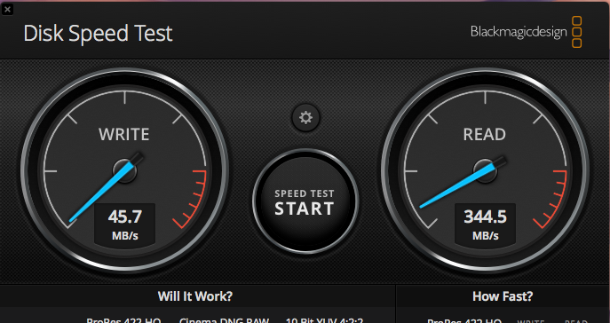

Have TRIM disabled does this make the computer faster/slower? Searched online but opinions are like 50/50..
Also this ssd speeds are normal?

That SSD write speed is way too low. That's slower than a spinner. Either your SSD is bad (not likely), or the SATA cable is bad (very likely). I'd RMA that SATA cable. The symptoms you describe sound like a bad SATA cable (I've seen this before).
If it's slow after replacing the cable again, then I'd try a clean reinstall of macOS. Also, replace that battery if it is saying "Service Now"
This is what i have been thinking, the Sata cable might be the problem, already contacted the store lets see what they answer back. Also enabled TRIM as saw many mixed opinions but for this laptop boot takes like 2 min so deactivated it.

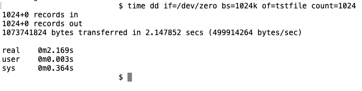

How much free space does the SSD have? Is there anything running in the background (FileVault encrypting or if you turned it off decrypting, etc).
Boot into recovery mode (command-r while turning on Mac). Select English if you have to, open disk utility click on the Macintosh HD volume (or whatever you've called it) and click first aid. If first aid is greyed out you'll need to mount the volume by clicking mount, selecting the admin name (it might not be the default) and enter your password, then click first aid. Click show details as it runs.
This will run fsck_apfs where the drive can be unmounted to check and repair errors.
Close disk utility with the volume still mounted and click utilities > terminal from the menu bar at the top and type:
cd /Volumes/(volume name). Example, if its Macintosh HD "cd /Volumes/Macintosh\ HD"
Then type:
time dd if=/dev/zero bs=1024k of=tstfile count=1024
That is a timed write dd command that is making a file (tstfile) from an unlimited source (dev/zero) mostly outside the influence of the MacOS and user data. The results will look like this....
499914264 bytes/sec = 499 megabytes/sec (btw that is my aftermarket SATA3 SSD installed using APFS with FileVault turned on and is roundabout what your SSD write speed should be).
Keep in mind this does leave a 1 gb output file (tstfile) in Macintosh HD that you'll want to eventually delete from Finder in MacOS or in terminal while you are still there by typing "rm tstfile".
If the SSD speed is still slow there I would likely pull it and test it in another machine just to absolutely verify its the cable or logic board and not the SSD.
Good luck.
