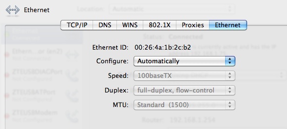

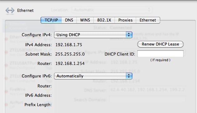

I have a horrible feeling that this will get resolved by a reinstallation of my OS, but if any other ideas I'm very happy to try them out! Only other thought is if I have any network settings that are off - I've attached what they are at present....
