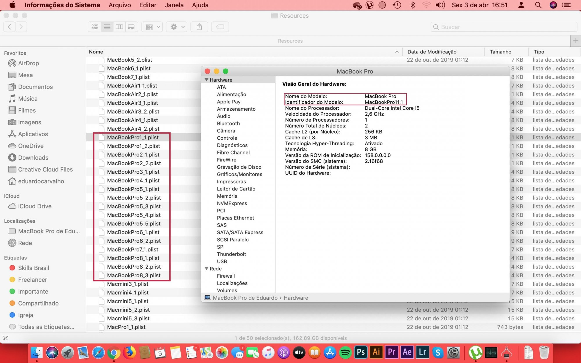

A few days ago the battery of my Macbook Pro - End 2013, collapsed and does not work anymore, but it turns on and works "normally" since plugged in.
It turns out that, the performance of the notebook plummeted (A LOT) after that.
From what I researched there seems to be a relationship between: removed battery directly affects performance.
It seems that the original mac source is not powerful enough to keep the machine running at full load and when it happens it uses the power from the source and battery together, so when the battery is bad the SMC limits the performance of the machine so that it is not possible to achieve peak performance and thus avoid unexpected shutdown or crashes.
Some tutorials on the web have delete a plist file.
BUUUUUT when following such a path, the model of my mac does not appear there.
According to the System Information I have a MacbookPro11,1 and do not have this in the list of plist.
Could someone help me?
There's no chance for me to fix it the battery now (its really expensive in Brazil).
P.S Has already reset the SMC and yet the slowness remains
