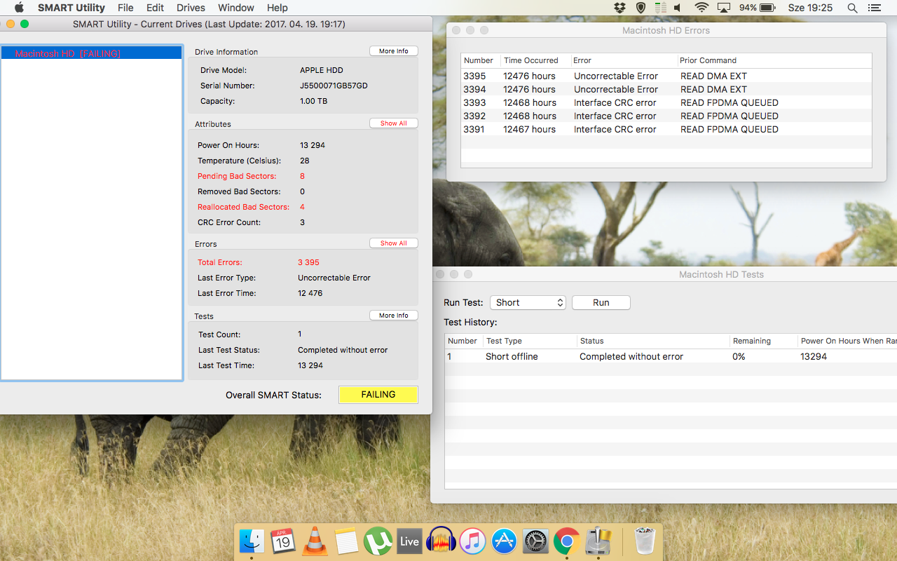

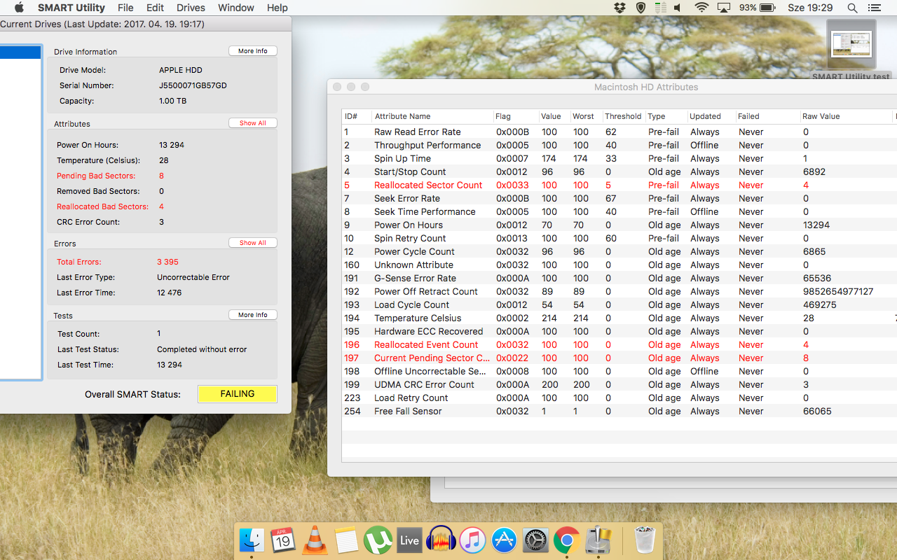

run the SMART Utility test, i assume it‘s the HDD cable
thank you guys, it has been a big help!

It's both! A load of CRC errors indicates the HDD cable is failing. 8 pending bad sectors and 4 reallocated sectors means the HDD itself is failing.
1) Pop to an Apple Store/AASP, get a new HDD SATA cable fitted for free.
2) Swap out HDD for SSD.
3) Good as (well, better than) new!
