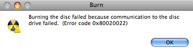

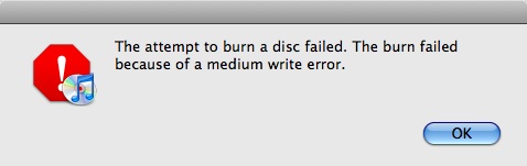

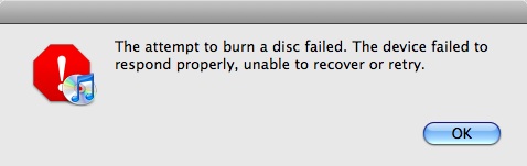

Anyway mine gave this error shown in the first screen shot. I took out the battery and held the power button for 10 secs and then turned it back on. I burnt a small file in finder but when I tried to burn from itunes it gave me the errors in the last 2 screenshots at two different times

Mine also show that it failed to caliberate at some point
