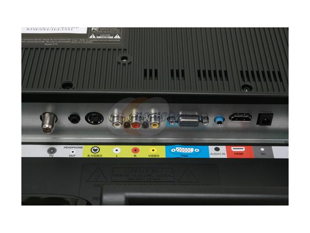

However most (if not all) HDTV have an VGA input and a minijack input, what you need to do then is to get a DVI-> VGA cable and a minijack->minijack (both sides male minijack) cable.
If you use minijack -> RCA cable it will not work since you are conecting the computer to two separate inputs in the TV (the same you are doing now, in fact I bet if you select the input of your HDTV to RCA1 or RCA2 or RCA3 or howerver is called in your TV you will be able to hear but not see the image, quite the oposite you are experiencing in the HDMI input)
I know it is annoying but is your only choice.
This is a random HDTV
Notice the VGA port and right besides it the minijack input.
