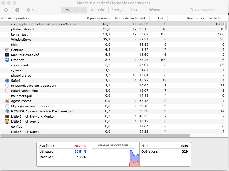

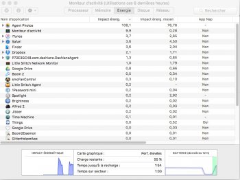

I'll add these two screen caps, maybe the reason why my computers so hot?

Hmm have you recently upgraded the OS? Photos is busy doing it's thing which can take a long time depending on how many photos you have. If that's been hanging for a while there could be something wrong with it.

Good news and bad news. The increased temperature in general is lowered to 56 celcius, however when i opened photos again it jumped to 90 celcius. I suspect this might be related to the fact that I haven't opened the software in some time, it has been updated and it looks for faces, etc. In the photos.

It's more than likely Photos scanning through everything and updating, which can take days.
