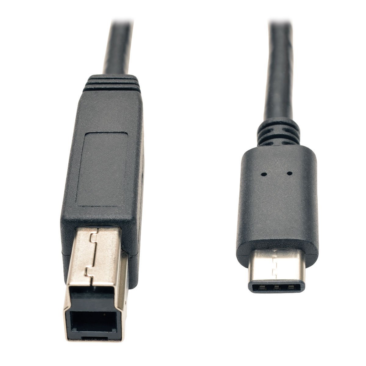

A replacement cable should work great, you just need to make sure it's USB 3 rather than USB 2 (which is why they label some of them as "printer/scanner" cables)... that's assuming your DAC uses USB 3. One like this one should work.
Or you can get an adapter for the end of your existing cable like this one.
Or you can get a USB hub like this one. (I've used one of those to connect a MB to a DAC).
Good luck!

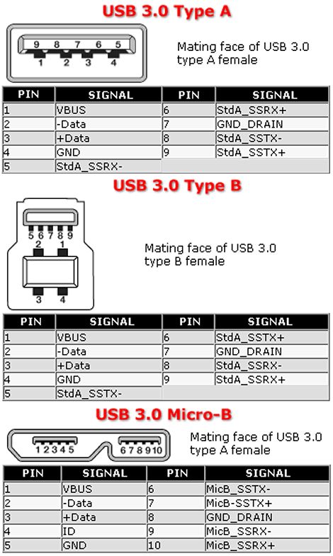

This is a USB3 to USB-C cable.
note that the B-connector has an extra row of pins.
https://www.amazon.com/Tripp-Lite-T...1509301236&sr=8-13&keywords=cable+usb-c+usb-b
(example only, buy at your own risk, etc, etc.)
I don't think it will physically fit into a USB-2.0 device.
(The USB-3.0 A connector hides its extra pins inside the connector.)
The SSRX and SSTX signals are associated with Superspeed USB aka USB 3.0.
If you could share the make/model of your audio device, a more definitive answer might be possible.
This is a great point, but I'm concerned you buried it inside a lot of tech jargon that is just confusing. The USB3 Type-"B" connector is not backwards compatible with the USB2 Type-B connectors, so if the DAC is USB2 Type B, a USB2 Type B cable is required - USB3 Type B wouldn't work.
So as you suggest, the USB type needs to be identified if going the replacement cable route.
