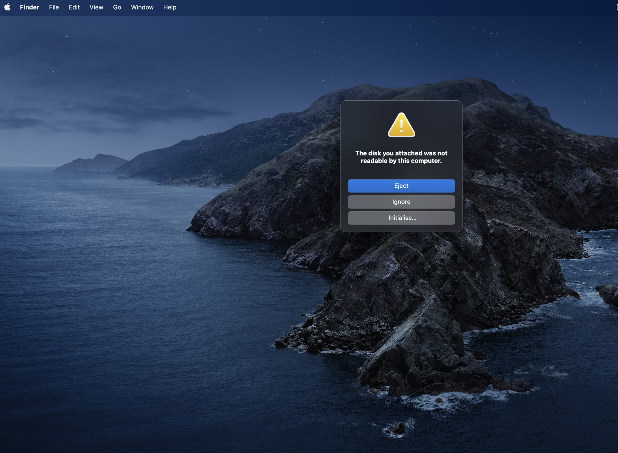

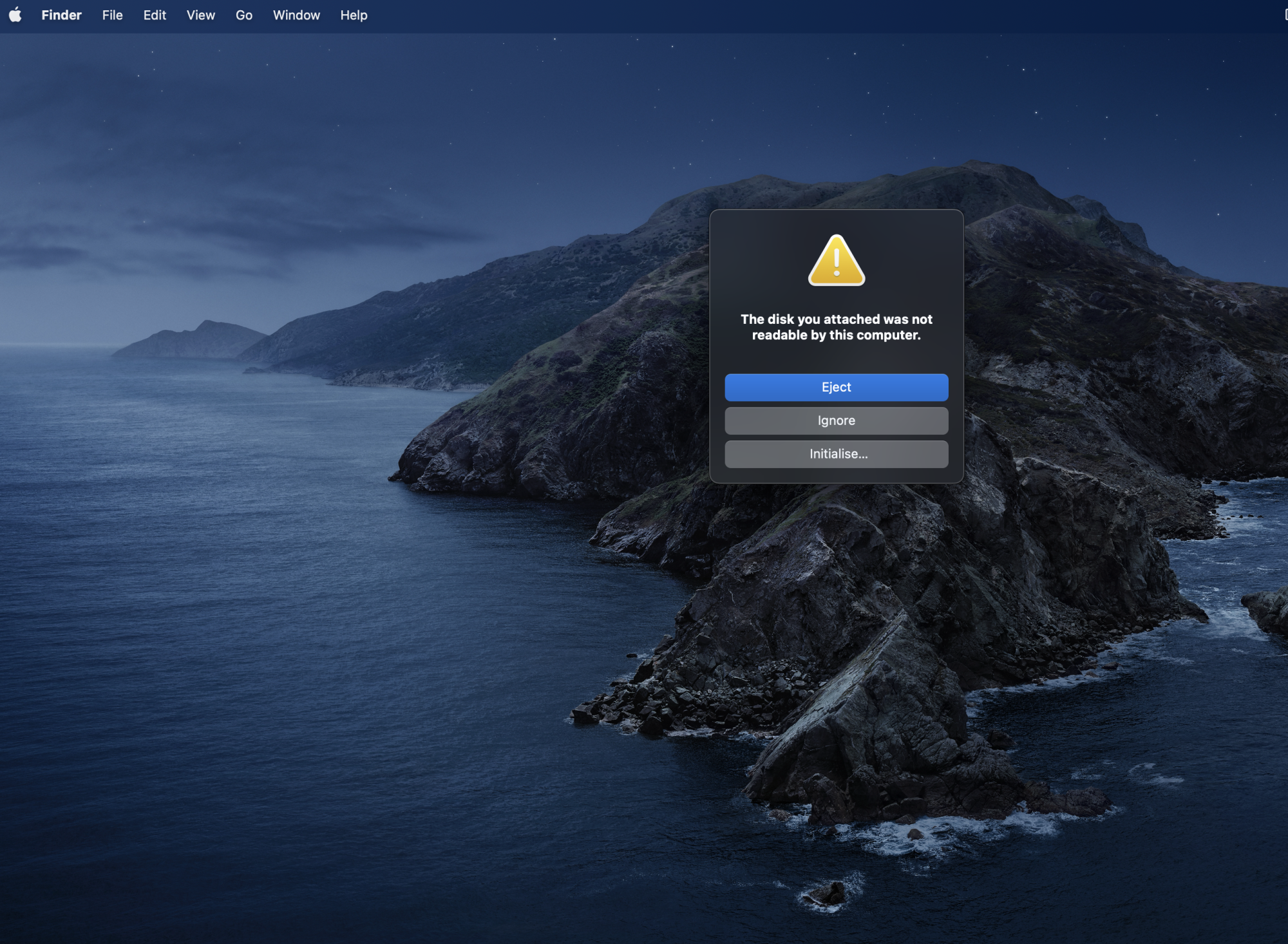

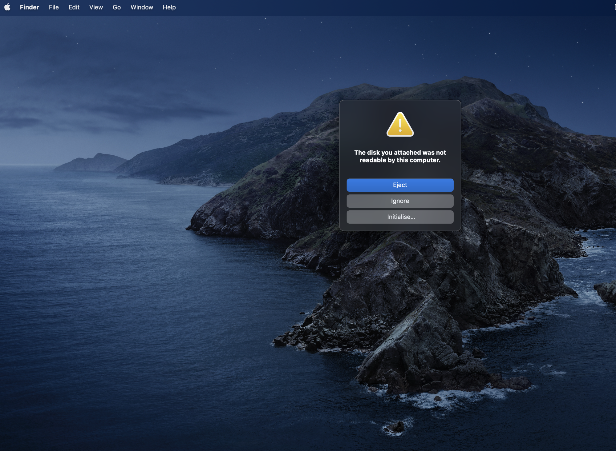

Team Kindly assist , my MacBook Pro is unable to read or accept my Samsung T5 SSD. This is the error I get immediately when connecting the SSD.
Team Kindly assist , my MacBook Pro is unable to read or accept my Samsung T5 SSD. This is the error I get immediately when connecting the SSD.View attachment 2146511
Have you checked/changed connection cables ? If the drive is in a case remove and replace back in? Try connecting to a different port on the Mac? Also, is it a new drive that you haven't formatted to APFS yet? Can you open Disk Utility with the drive connected?
