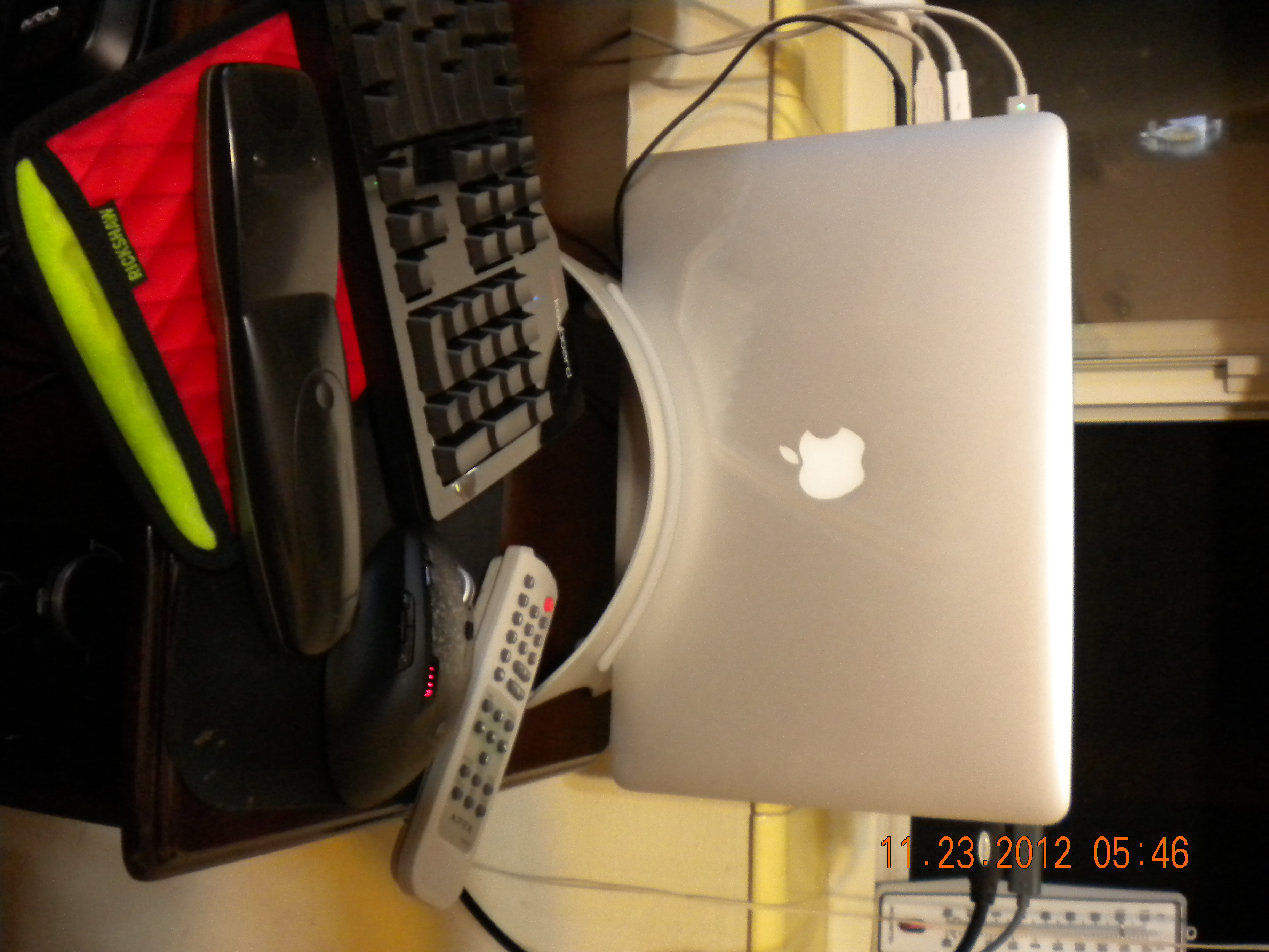

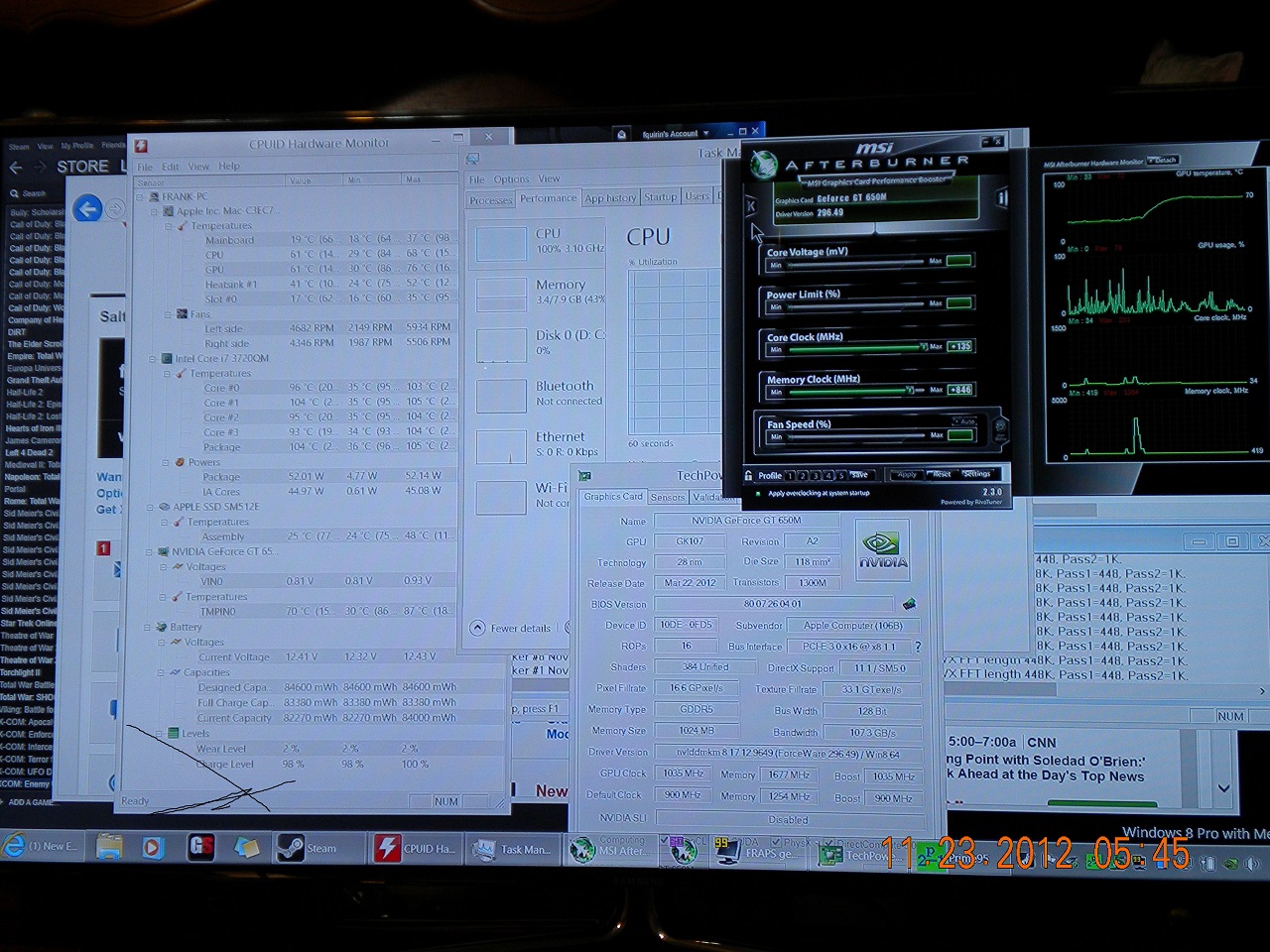

Mine has been going for a few weeks between games and benches so usage is pretty high I do have my computer docked and stuffed in a window for cooling. No problems and IMO these computers will last for a very long time no matter what you do, but if your going to run anything at close to 100 percent for extended periods you will shorten the lifespan.
