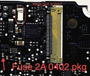

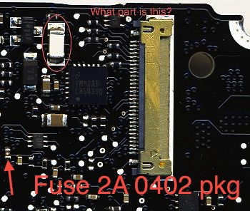

I have been aiming my efforts at the QFN package also until I came upon this thread. I have a fuse (closed) on the MB but it's not as small as described above. Can you give me a description of where about on the MB you found the tiny fuse. I'm at my macbook for at least two weeks now with no luck. Tks.
See image below. This is a 2A fuse in an 0402 package. I think it is 16V but can't remember. It carries 12V normally. Look for the little white dot on the top. Use a multimeter and check if it is an open circuit (unplug the battery first).

@Dadioh,

In you original picture circled the white box, mine has some discoloration in the center. I took my multimeter and checked if current can pass through and no luck.
I did the same to the tiny fuse you circled and i heard a beep - indicating there was no break. I'm not too sure on what you mean by "open circut", but i'm assuming it's an incomplete connection.

The white device is a capacitor. It will not pass current so it will show as an "open circuit" (that is your multimeter will show a large value for resistance in the megaohms or more). Some multimeters (like my Fluke) can do basic capacitor measurements but most cheap ones will not. However, the capacitor is not likely to be the source of your problem.
If you measured across the fuse and the meter "beeped" then it means the fuse is good. However, that is not good news. The fuse is a relatively easy fix (with some decent soldering skills). I have had 3 cases of this circuit having a blown WLED driver. That is the square black package down and to the right of the white capacitor. That is a 24 pin QFN package and they are VERY DIFFICULT to replace. The part is relatively cheap however. If you buy the part you will need to find a professional to remove and reinstall the new one. This is not the sort of job someone new to soldering is going to learn very quickly. If you want a sense of it just search on "QFN Soldering techniques". Here is one example below.
http://www.youtube.com/watch?v=c_Qt5CtUlqY&feature=fvw
There is also the possibility that it is not the WLED driver and some other circuit inputing to the driver (like the enable pin) but the most likely cause is blown WLED driver.
Hope that helps.

This is the fuse that I bought. I think that any fast acting 2A fuse in an 0402 size would be fine.
