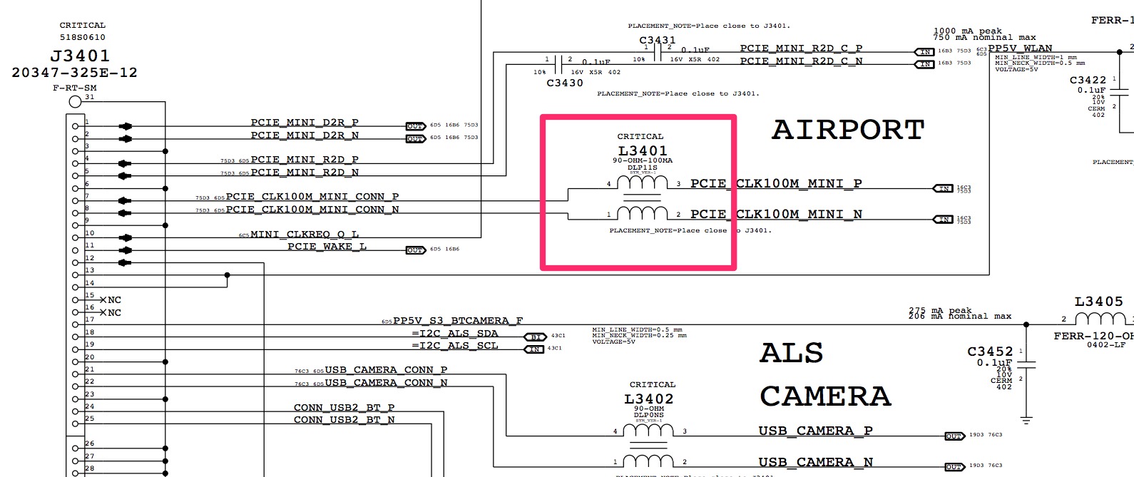

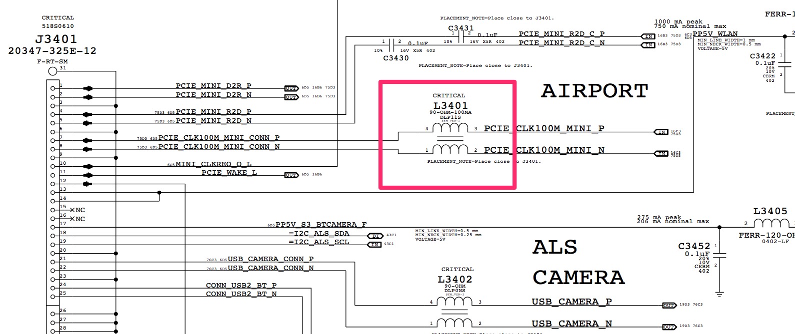

I just checked and there is 5v at the red dot in this pic. So i guess its not a power issue?
Right you are. It is 5V powering the Wifi. I was going from memory and thought it was 3.3V. The other thing to check is the common mode choke that leads to the data signals. That is the device just to the right with 4 leads (circled in my attachment). You should read almost 0 ohms across the device (north south). I have seen these guys blow open.
Thanks for all the advice Dadioh. I checked the resistance between the choke and it was close to 0 , so that seems to be within spec. I have an extra airport card that I am going to put in just to rule out that.
I replaced the airport card still no luck. I also checked the two capacitors to the right of the choke they have .5v coming in an 7mv coming out of them.
Did you check to make sure there are no shorts between adjacent pins on the connector? Also make sure none of the pins is grounded that should not be.
The caps are usually reliable so I would not expect those to be the issue. Caps don't pass DC current so you expect different voltages on either side. If they are symmetrical (both have the same voltages) that would be a good sign since they are carry balanced signals.
I have had cables fail on me in the past so that is another possibility. But the fact that you had that inductor blown off the board suggests that the issue is with that part of the circuit.

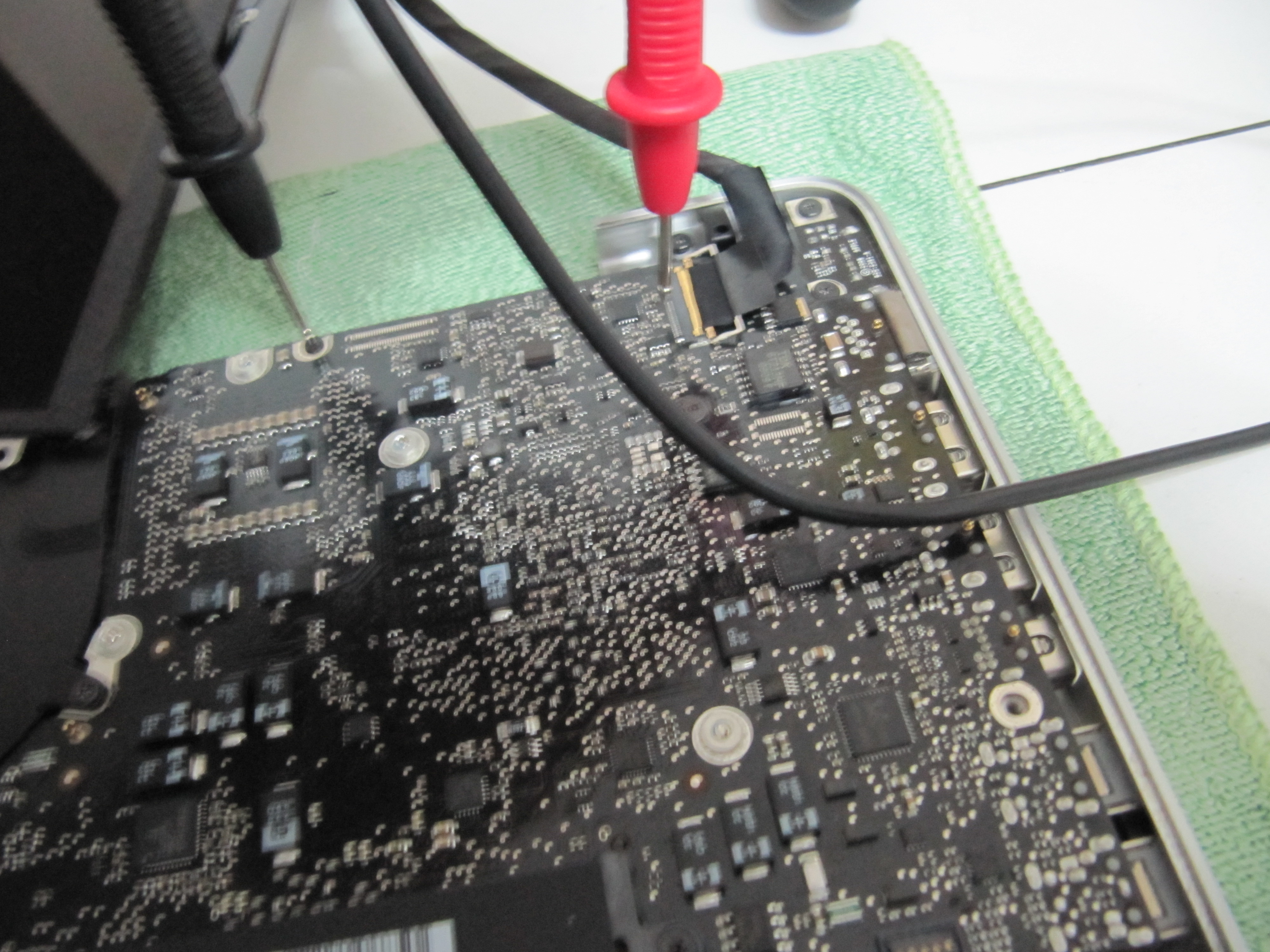

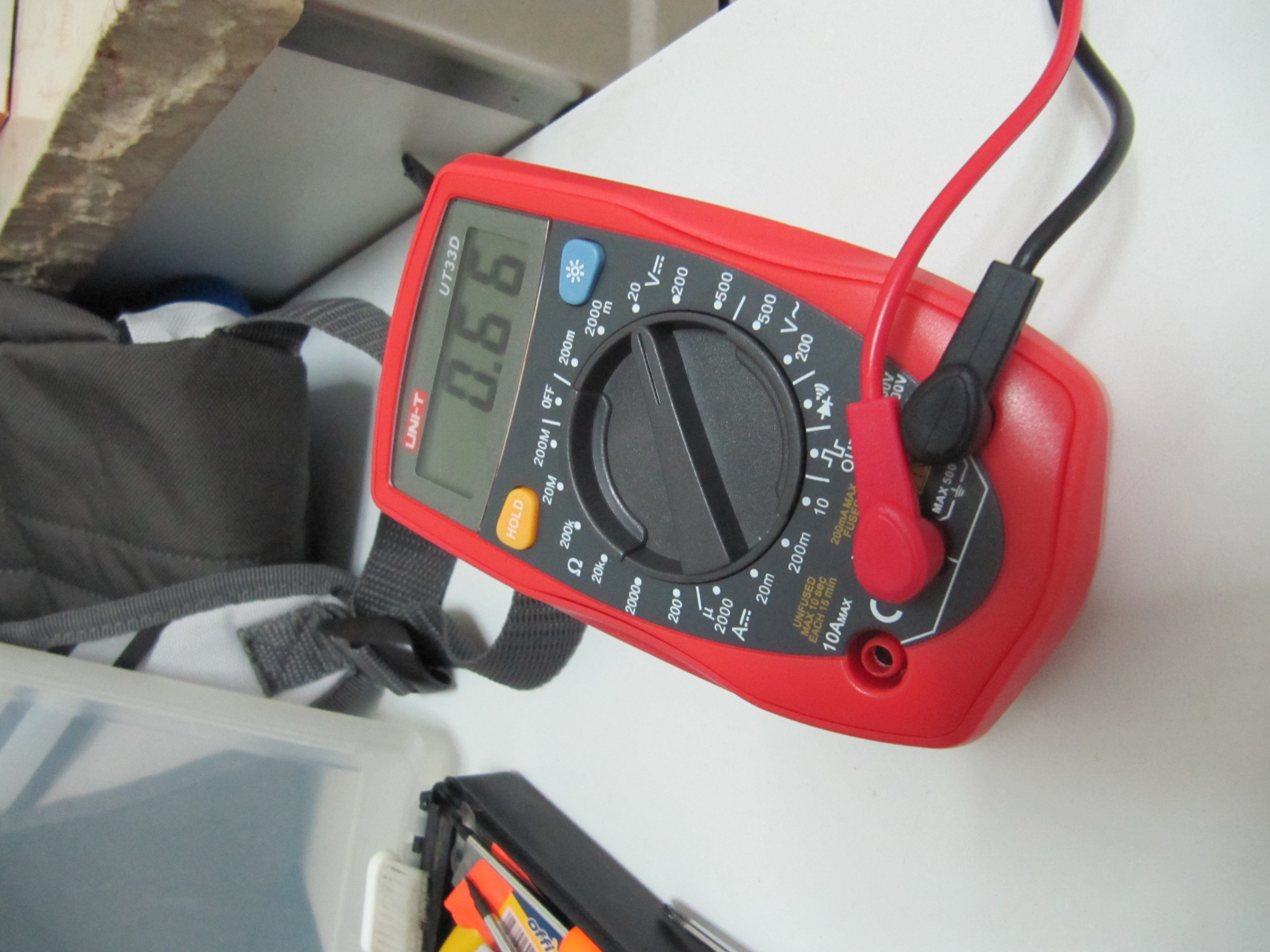

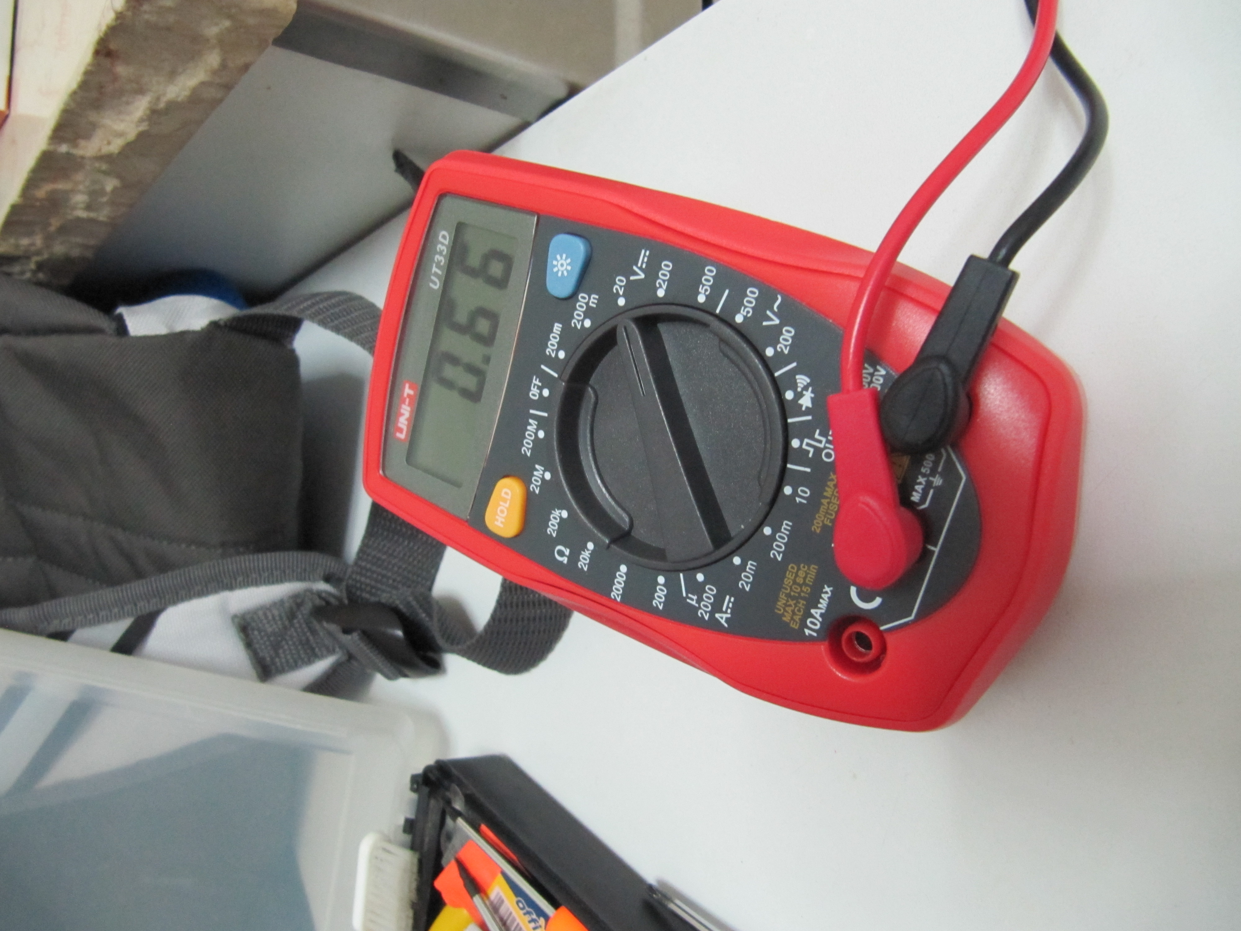

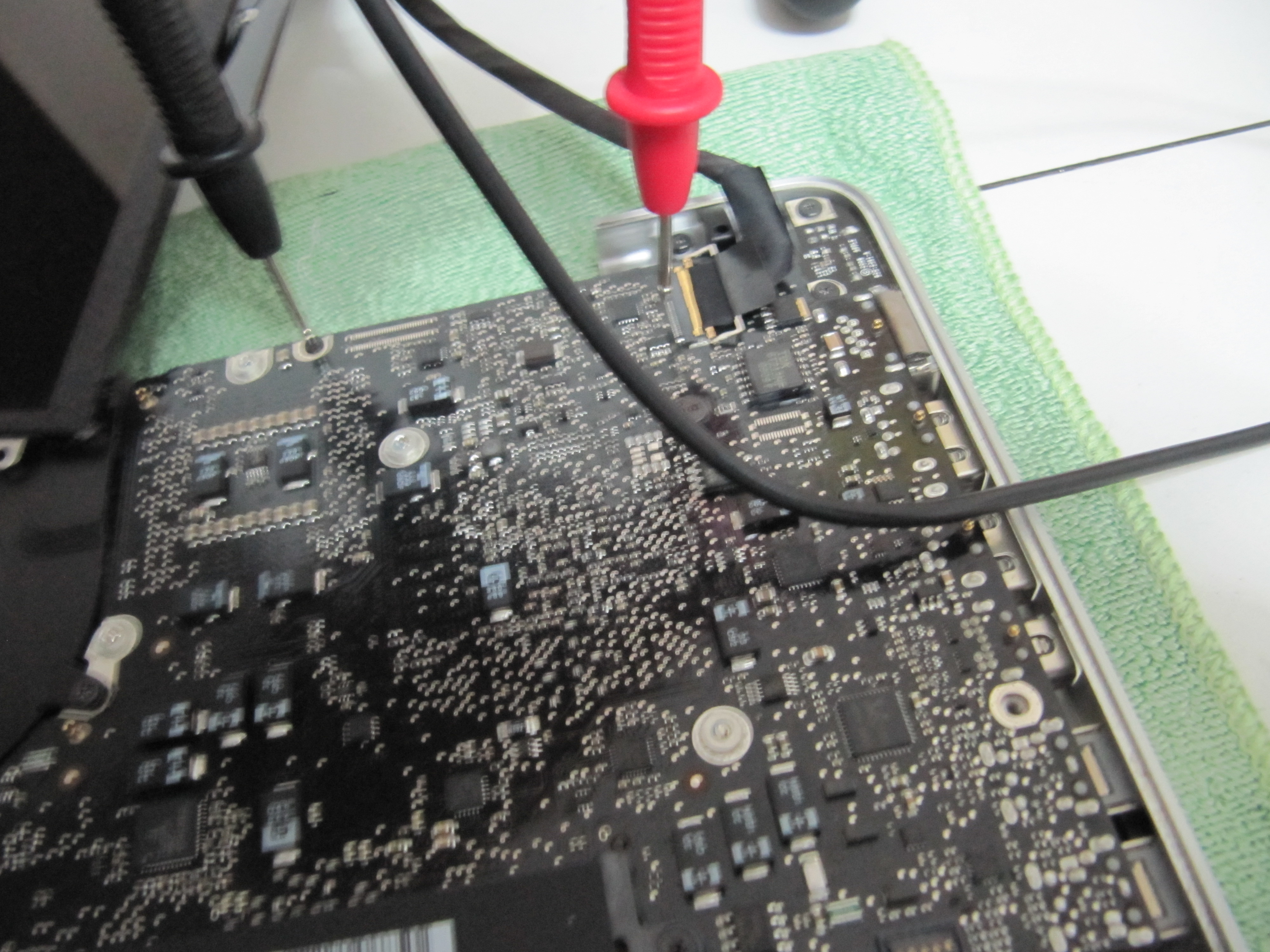

I measured
One foot in the second screw on the resistor 125
Measured 0.66 v
This counter is invalid?

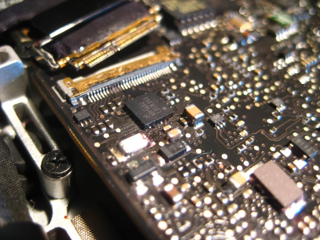

Hello everybody,
Unfortunately, I'm another person with a liquid spill problem in my computer... this time with a glass of red wine.
This as happened more then one year ago, and since then I've been using my MBP 13.3 (mid 2009) throw a external display. After I went to the apple assistance, I conclude that there was nothing I could do, because the price they ask was just to much for me... And now I can see a little light in the end of the tunnel, because I saw this forum, and I'm prepared to give it a try. 🙂
In my case, the LED backlight doesn't work, but I can see a faint image in the display. Sometimes I even close the lid to put the computer to sleep, and I bring it back to life throw an external mouse, so the faint image turns off.
I read all the posts, and this week I'll start to perform the tests in the logic board. I would just like to know if someone have some information about the 30 pinouts of the LVDS cable.
I'll post some images of the internal disgrace... 🙂
Thanks in advance!!

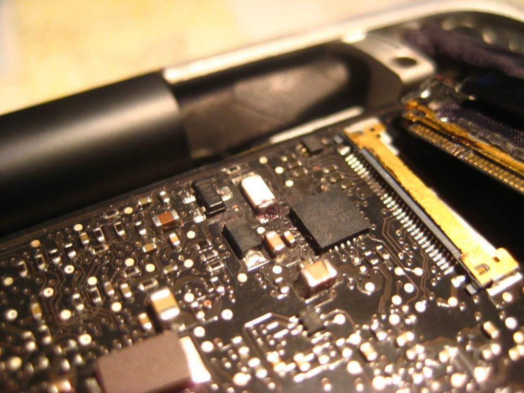

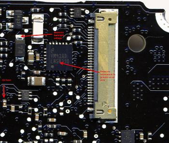

I have fixed this issue a few times by replacing the connector and LVDS cable. Assuming nothing else is bad in the backlight circuit you will need a new ipex 30 pin connector soldered to the board and a new LVDS cable which involves opening the LCD.
If you replace these and you still get no back light check for an open in the fuse. If the fuse is good the problem may be the WLED driver chip (that square one next to the lvds connector) also as I see some goo on the solder points.

Those are the backlight pins so you need to replace the lvds cable. That requires removing the glass on the display. Tricky job. You may also need to replace the connector on the logic board. You need to examine it under magnification.

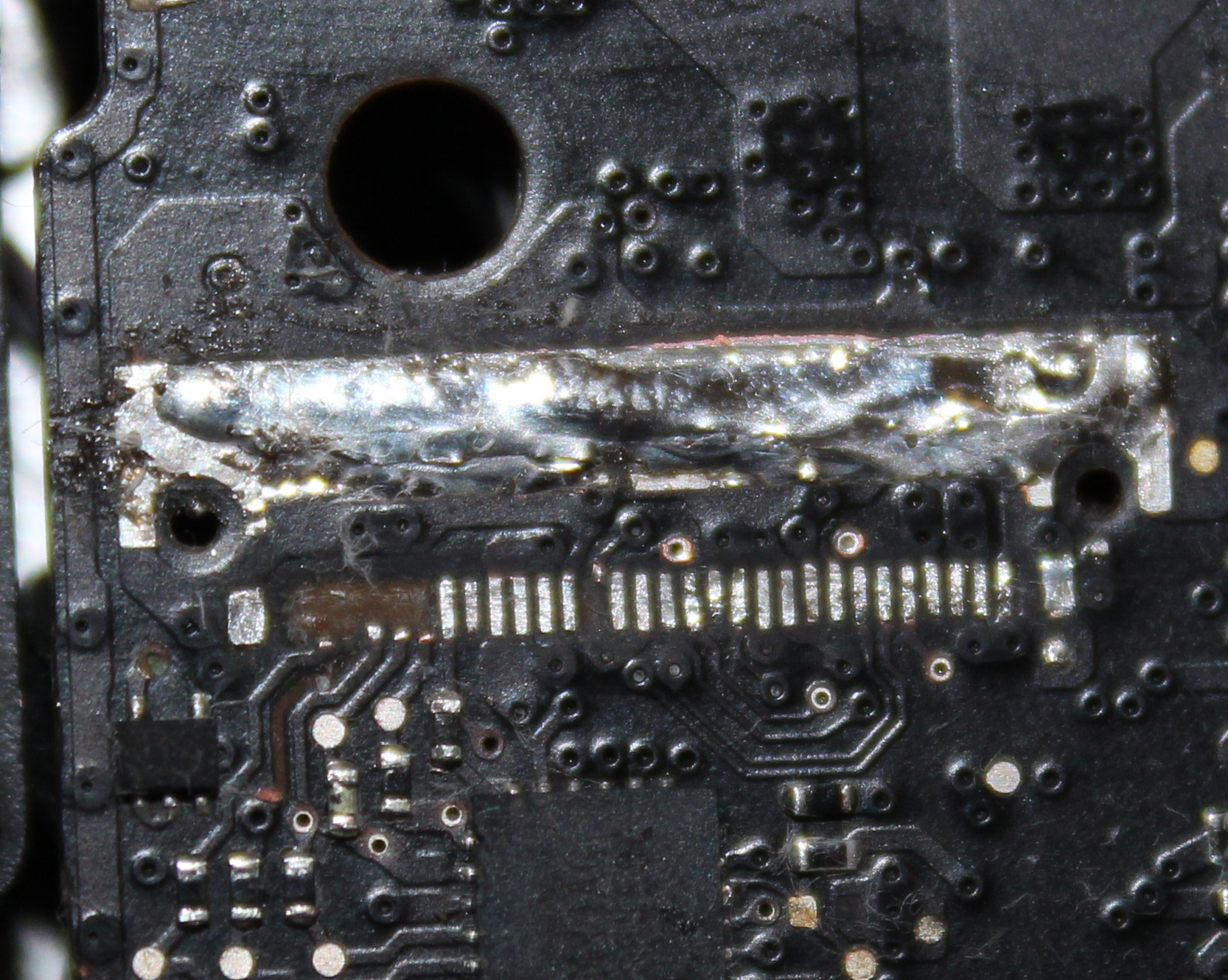

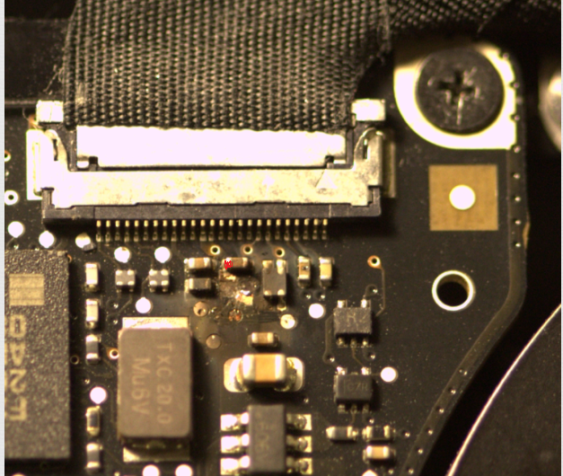

Can you post a picture of the damaged traces on the logic board. There is always hope 😀

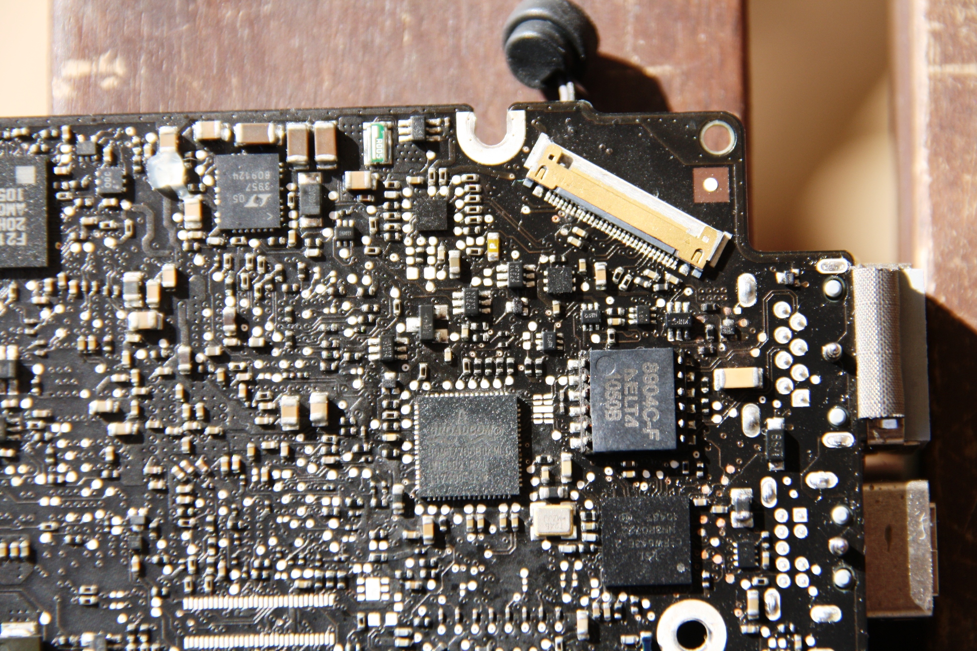

backlight problem
i have macpro mc 466 without backlight... where can i find the backlight high voltage supply on logic board?
MacBook Pro 13 2009 no backlight

Hi all,
I also have no backlight on my 2009 mbp, but at least I know what caused it. While i was replacing the lcd i accidentally shorted power and ground pins on the lvds connector and then the backlight went out, but the display still works without a problem.
I hope this is just a blown 2A fuse form the picture below:
I have measured the resistance across the fuse but i get no signal at all, and certainly not in megaohms or kiloohms.
Is it safe to short the fuse with a screwdriver tip just to see if it really is the fuse?
Thanks to anyone who could give me some clues on how to proceed.
Given that you "know" the cause of the blown fuse is now removed then it is probably OK to temporarily short the fuse to see if it solves the problem. However, proceed at your own risk. If you want to be extra safe then measure impedance to ground on all the WLED driver pins and compare to the chart to ensure nothing else is failed. In particular measure the impedance from the 27V backlight pins to ground and make sure that it is not shorted.
Of course the "really" safe way would be to replace the fuse and then, if there is still something wrong it just blows again. If it works then you are good to go.

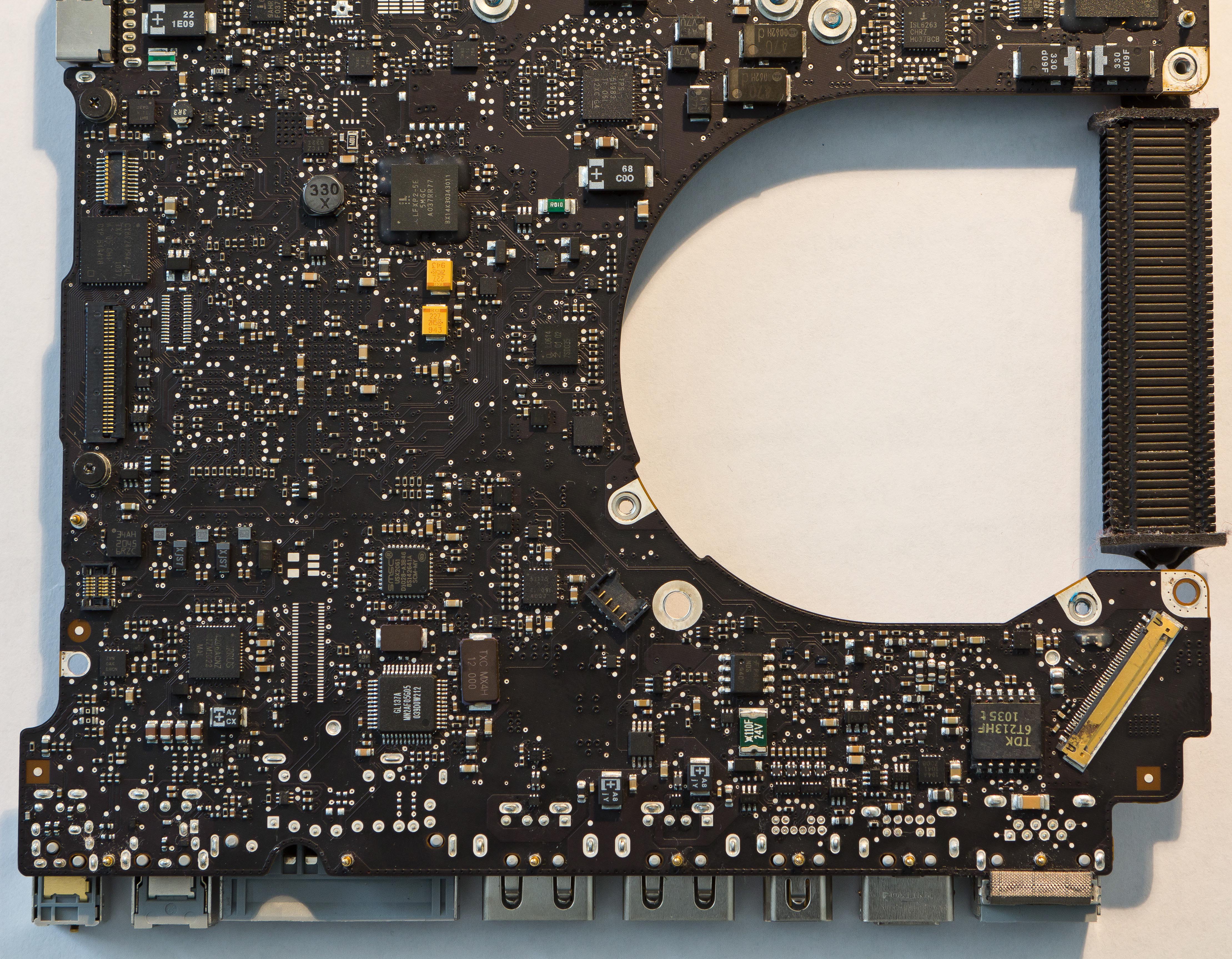

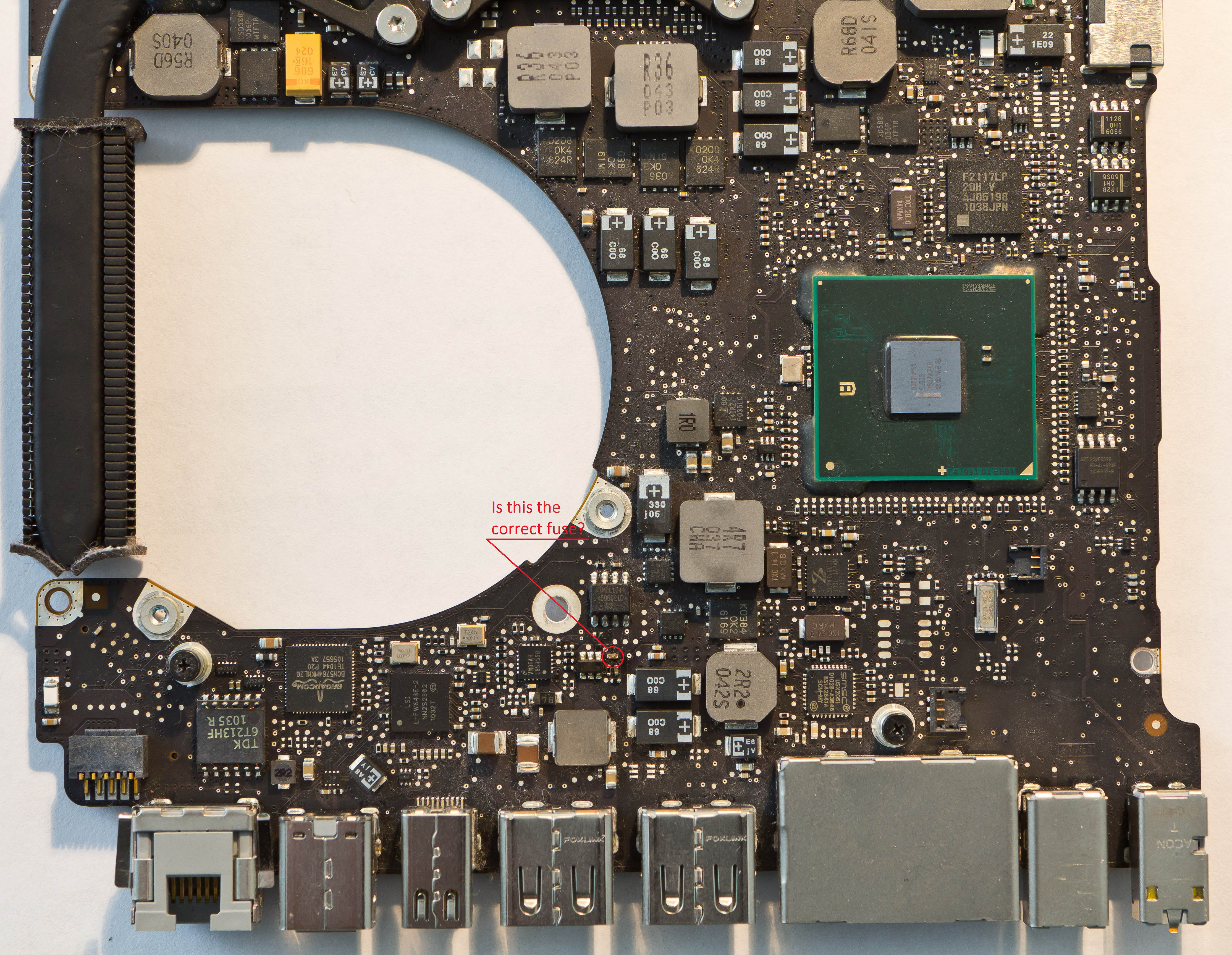

Hi all,
at first, thank you for all of your great work.
This thread is awesome and brought my panic down after I've changed a broken LCD from my "new" macbook pro 15" mid 2010 and still have no backlite.

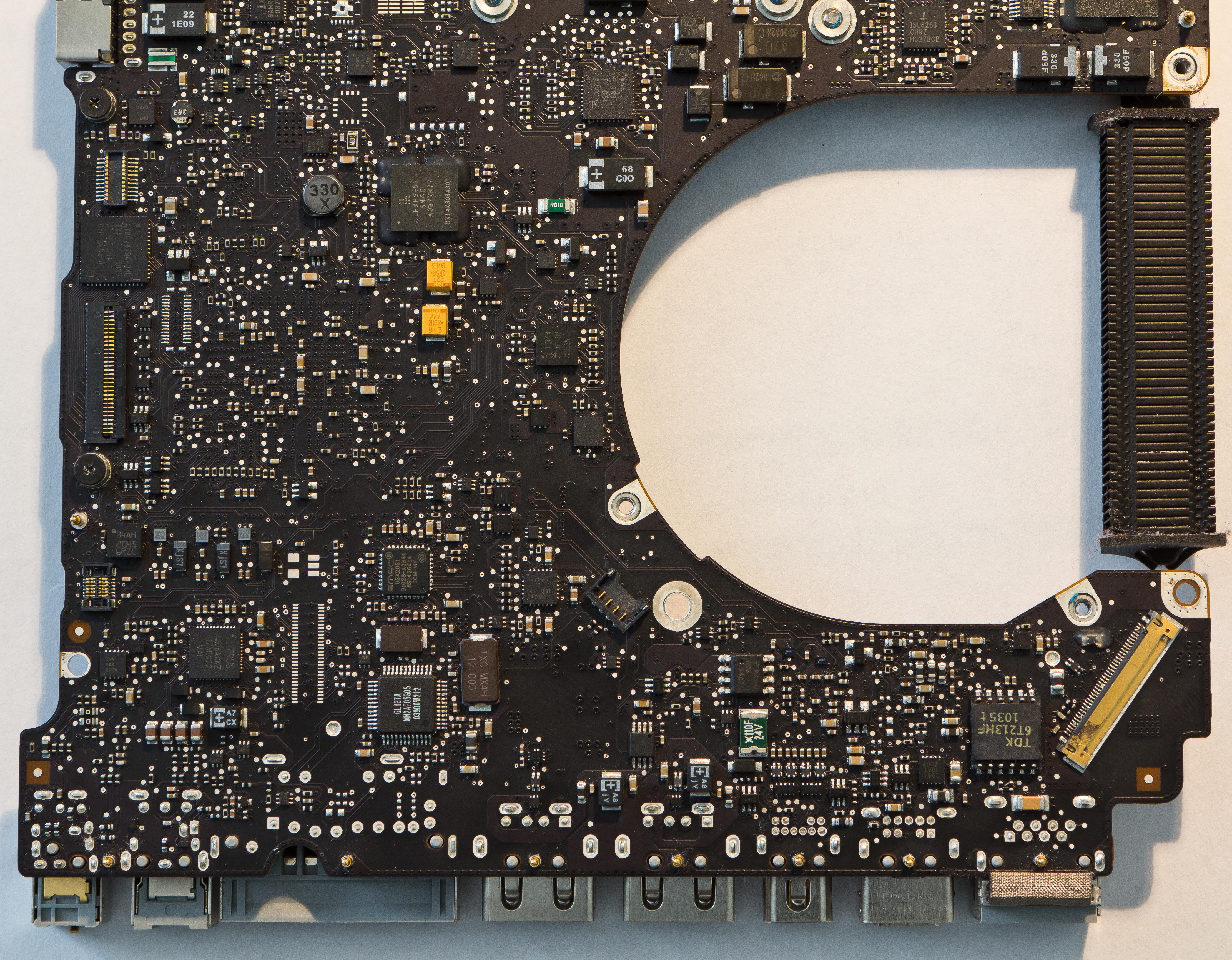

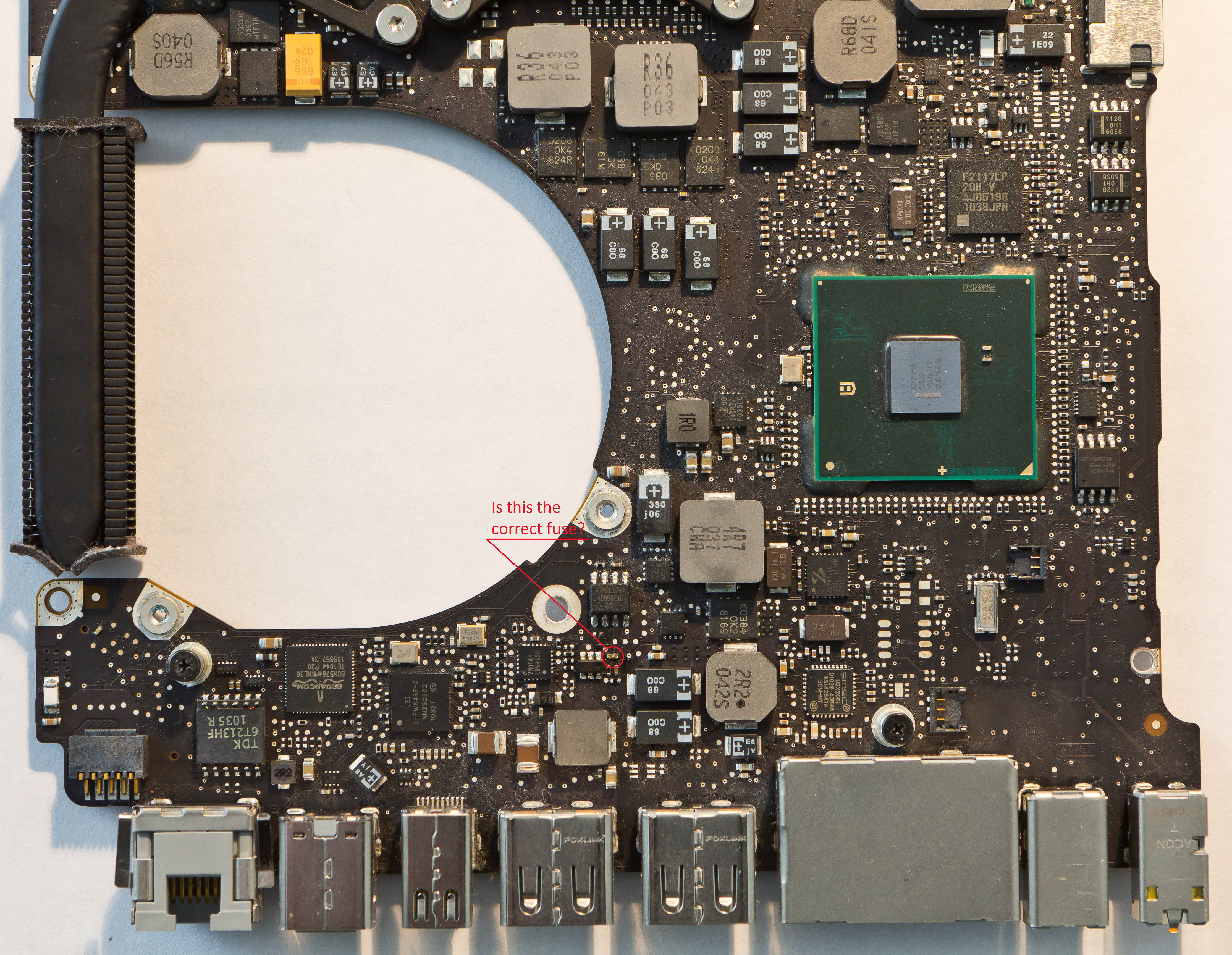

I've read the whole thread but I couldn't find a picture of a Mid 2010 i5 board with a marked fuse.
I've made pictures of both side and I think I've fond the fuse but I'm realy not shure. The fuse looks damaged and some kind of coating is arround the fuse.
I've linked the pictures due to theire size (5184 x 3456).
http://imageshack.us/photo/my-images/685/macbookmid20102.jpg/
http://imageshack.us/photo/my-images/10/macbookmid20101.jpg/
It would be nice if someone of you could please have a look and give me some help to find the fuse.
Many thanks in advance for your help.

Dear friend
It is poor quality of photo, you need to upload a better photoes

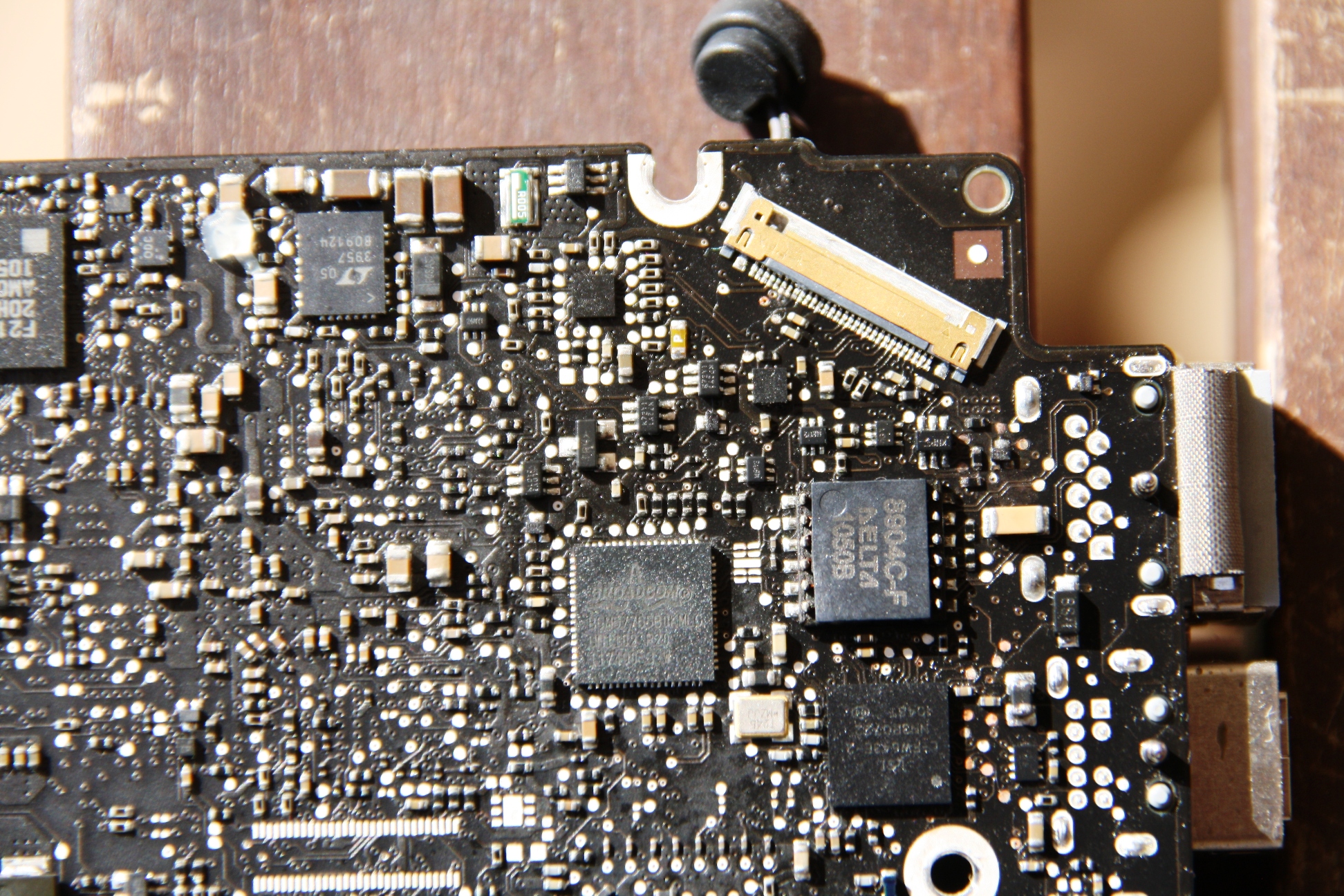

Hi Mori3000,
thanks for your fast reply.
Must be a problem with ImageShack.
I've attached it diretly to this post, should be in full res now.
Thanks for you help.
It seems like there is some thing on it,so not possible to see exaktly, But the device you have marked i think is the right thing.
You can checkup if there is a little white dot on it so it is the right fuse.

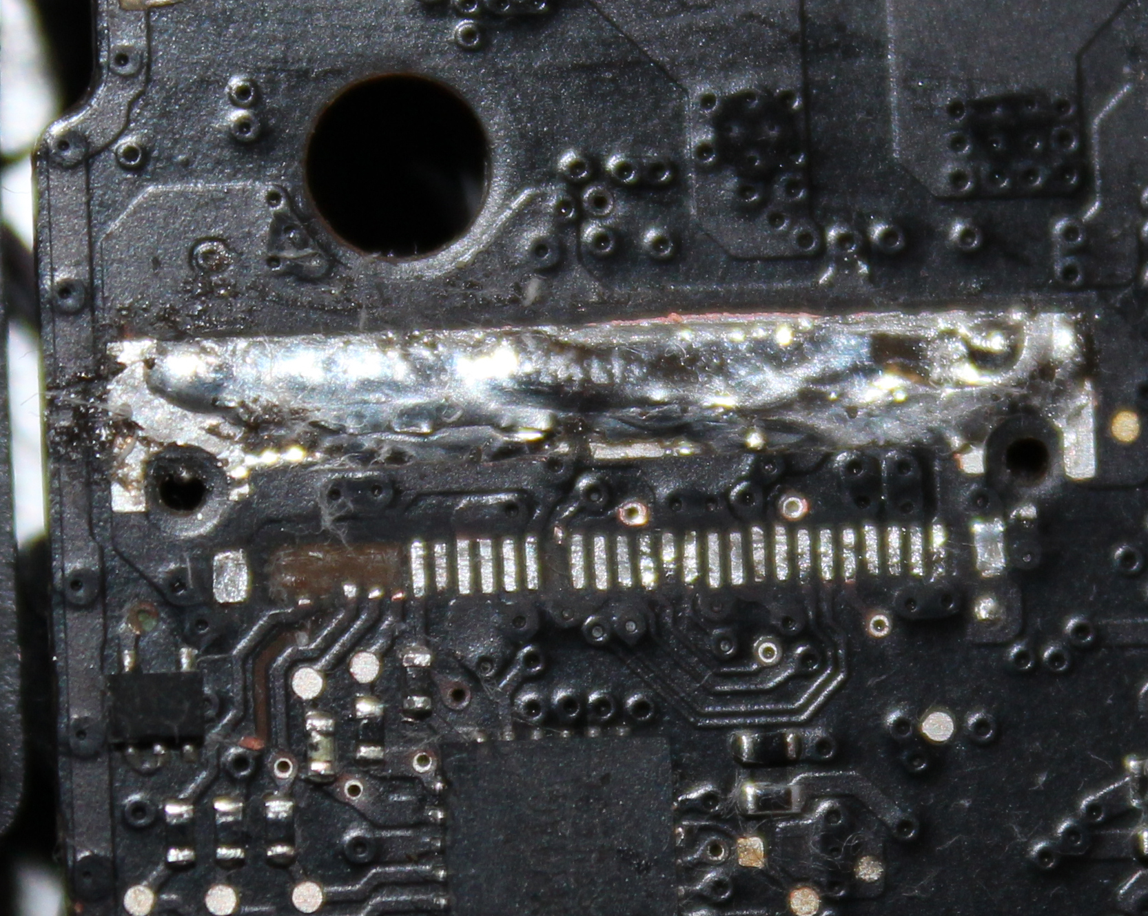

Dadioh, sorry for the delay. Been preoccupied. Here is a pic of the connector with some missing traces. Any suggestions would be greatly appreciated. Thank you again for your assistance.
