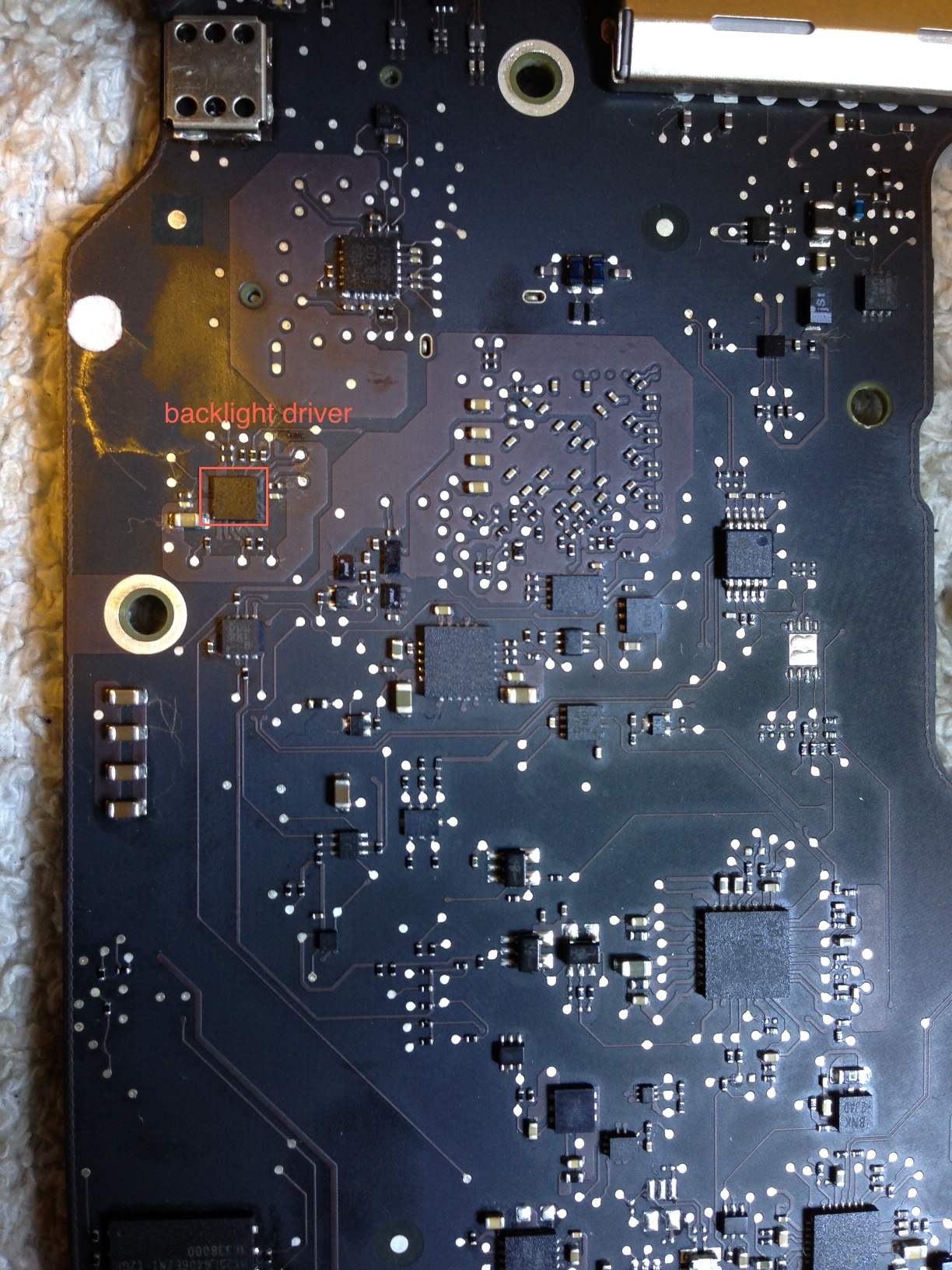

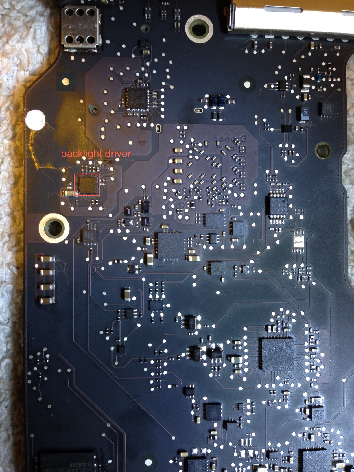

Where is the WED driver?
Look left from the Fuse. A tiny BGA package surrounded by resistors. See picture.

Hey Dadioh, thanks for your effort!
I could not really trace the connections because I don't want to remove a potentially healthy WED chip just yet. A friend of mine has the same board as I do and I did some measurements on a healthy board (everything around the WED).
Then I measured on my board, and I noted some differences.
I marked every different reading in the picture below. What really bugs me is the resistance just below the chip, which is like 9,5M Ohms difference, and the one right next to the fuse. Which has no continuity to ground at all.
Do you know where I can find the boost diode?
Is it the black package on the left, labeled F03AY5?
When the macbook is running, I measure 0,2V there.

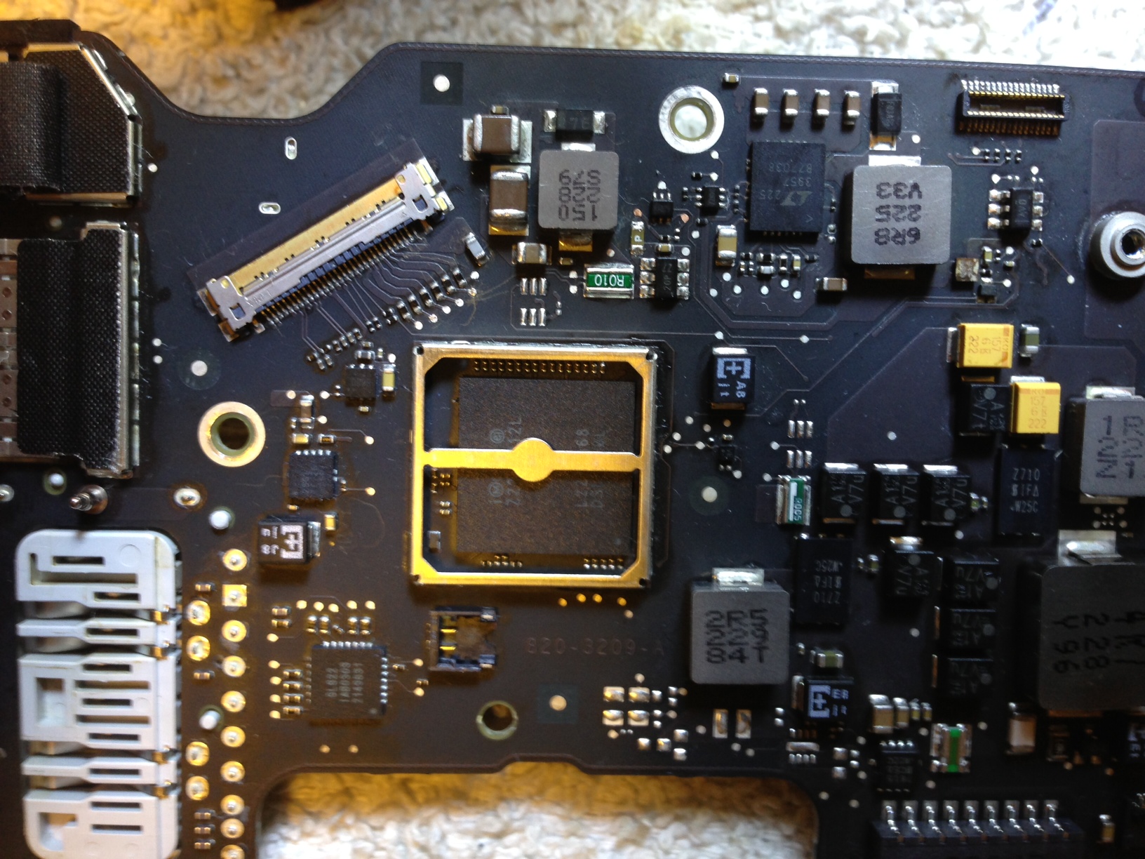

Dadioh, I have the same motherboard as Mori3000. its a 820-3209A. seems like the WED chip is not the typically used LP8550. Its apple proprietary. I have taken pics from the front and back of the board. Can you please help me identify the fuse? Please make marking on my pics as you wish. Mori3000 feel free to offer your insights since you have worked with this motherboard. btw this is for a 2012 macbook air.
Thanks guys
Can't PM you. You may need more posts before that feature is active.

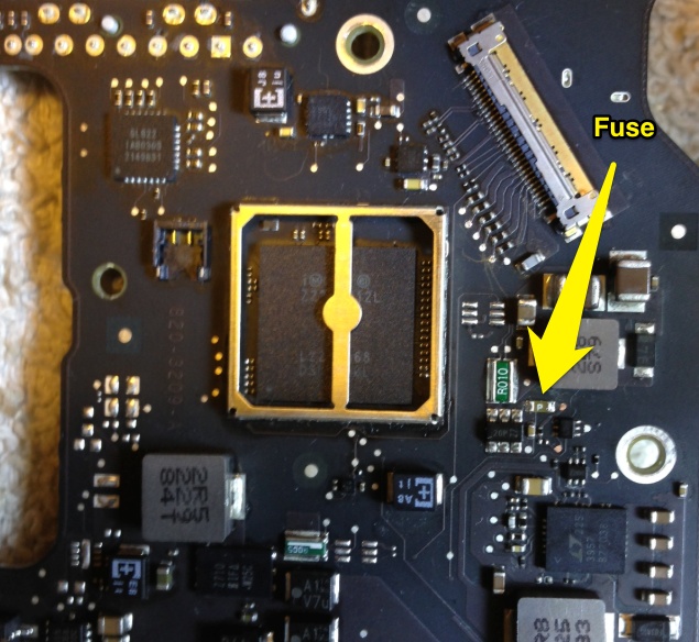

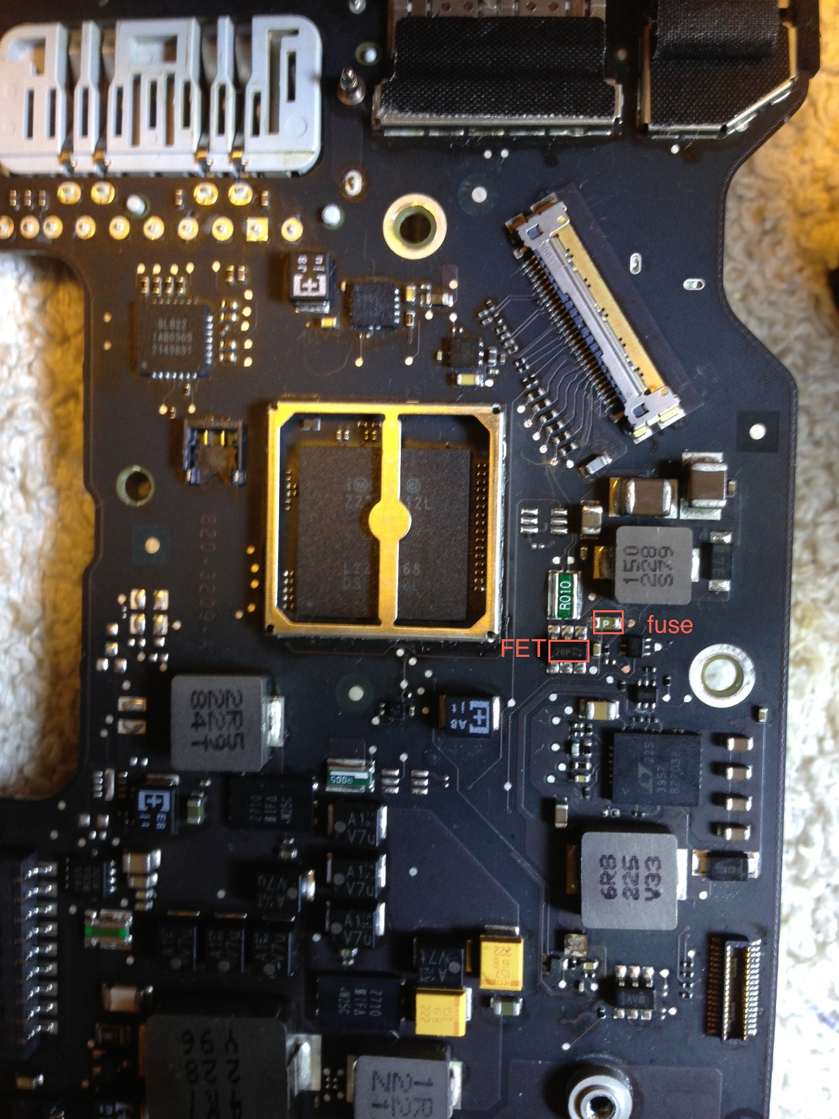

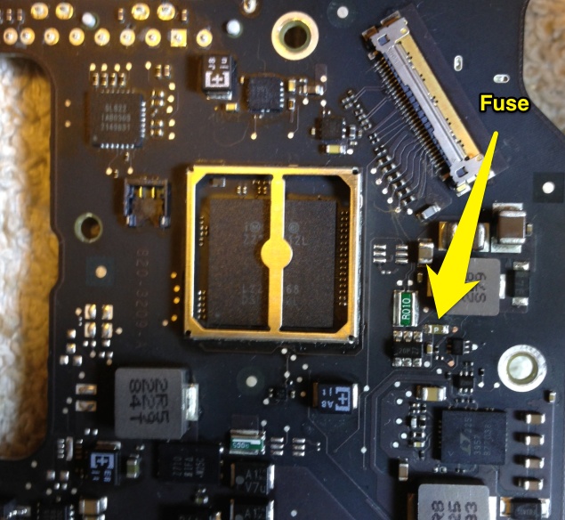

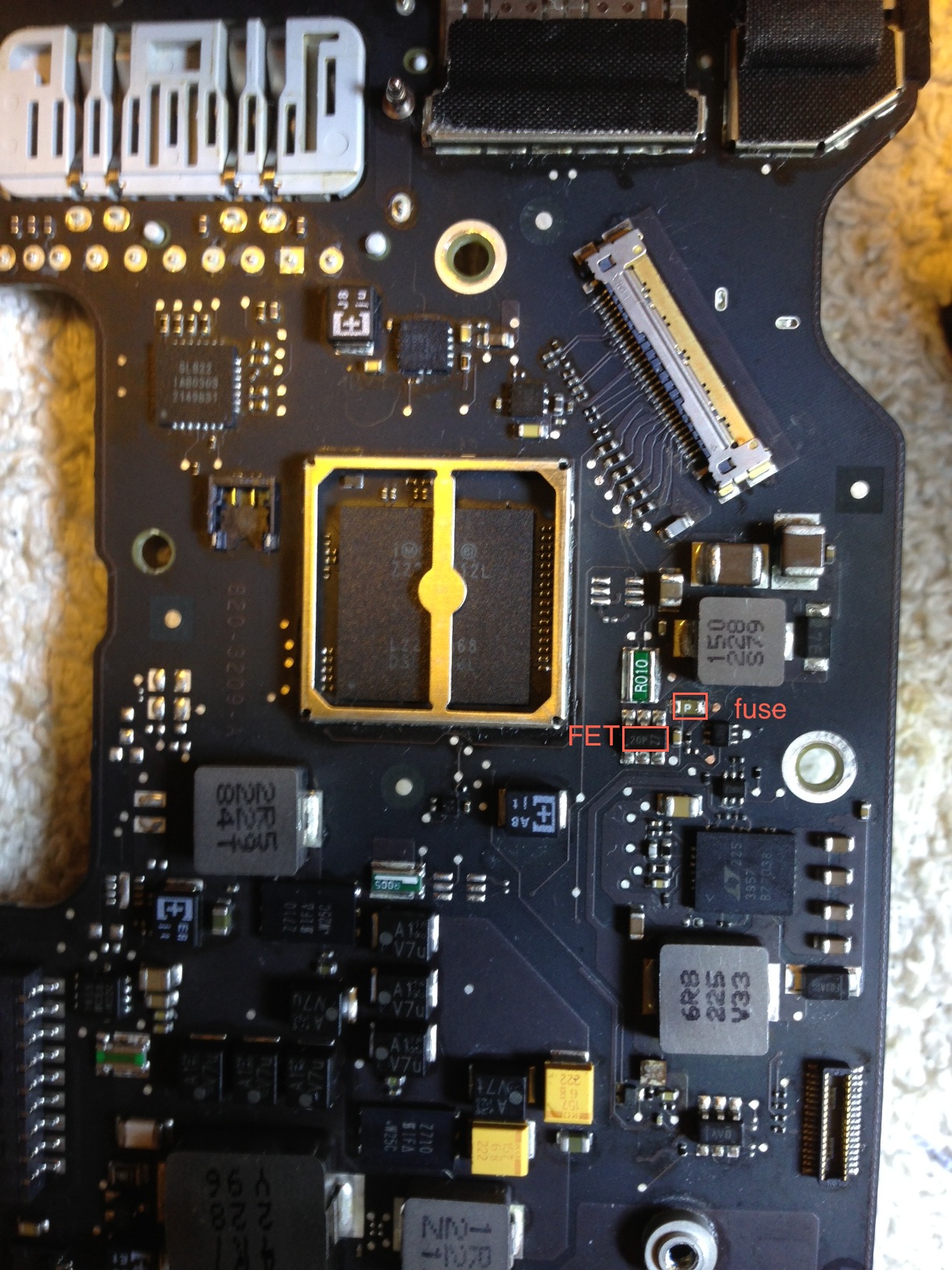

I have actually found the fuse. Its marked with a P on it. I have indicated on the pic below. I tested the fuse and it was bad. So i have changed it. The fuse is good now but i still don't get any Backlight. I think the FET might be bad, because I'm not getting any voltage from Pin 1, 2, 5, 6. Pin 3 and 4 both have 7 volts on them.
any idea what to look for next?
Yes acount is new. could you please email it to me at astrobeh AT yahoo.com .

See below. It has a "P" on it like it seems all of the other Macbooks 2011 onwards have.
edit: I see you found it. Was reading oldest to newest.
[url=http://s22.postimg.org/3w58tr5hp/bga_readings_healthy.jpg]Image[/url]
[url=http://s22.postimg.org/pu1pnjki5/bga_readings_bad.jpg]Image[/url]
Yes. That looks like the boost diode. That feeds into the 2 caps above it which smooth the waveform. Even with non-boosting WLED driver you usually get 12V on the cathode (the end with the line on it). Trace back in the schematic from the fuse through the FET to the inductor and then diode and see where the 12V stops. That same 12V also feeds the enable pin of the WLED driver through a 301K/100K resistor divider. I have seen those resistors fail before.

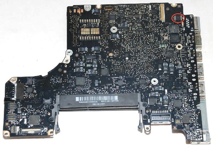

The fuse on the 2008 is on the back. I know I uploaded an image a long time ago but the thread is so large it may be difficult to find. I am traveling right now and don't have access to my imac but if you post a picture of the back I can point out the fuse.

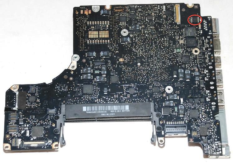

I believe it is the component highlighted below. Looks like it has a P or an F silkscreened on top. Picture is too blurry to be certain.
Yes, its P,i checked it with multimeter, and it has signal from the other side to the other,i'm bad in english grammar about technology,anyway thank you for your reply, i'll try to change that fuse, maybe its gonna work 🙂

[url=http://s24.postimg.org/l64li8xq9/backlight_schematic.jpg]Image[/url]
I also noticed some values of the resistors which are not really in the tolerance:
R9716: 87,6k
R9715: 94k
R9714: 15k
I dont really know if that makes a difference.
My multimeter also has quite some difficulties to correctly measure R9731, but after some time it says 300k.
Could you help me pinpoint the broken part?
Thanks in advance!
Dadioh, I'm running out of ideas right now.
I just changed the WED driver, tried to measure the outer balls of the BGA LP8550 to what they are supposed to be connected to, hooked up my Display, and... nothing... still no backlight. 🙁
Do you have any other hint for me?
Is there perhaps a way to check the functionality of the WED driver? Personally I cannot make much sense out of it.
