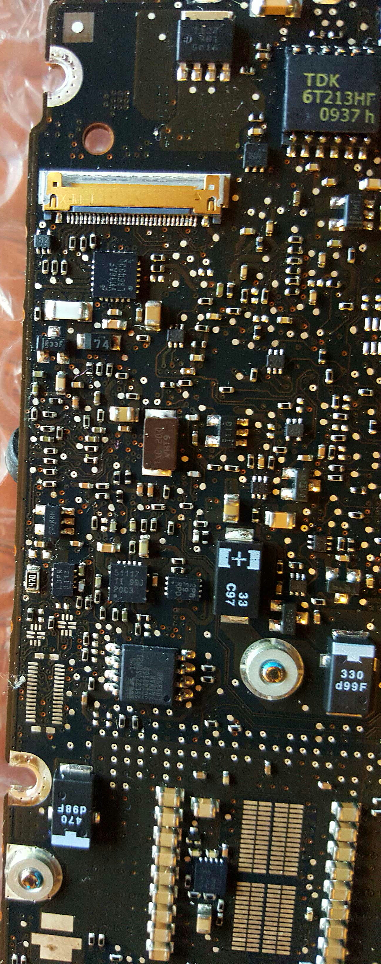

I have my macbook pro 13'' unibody mid 2009 2.56Ghz with no backlight on LCD.
everything works on the macbook pro apart no backlight but if using an external monitor it works.
I am trying to understand how to check some of the common parts that might cause the issue using a multi-metre.

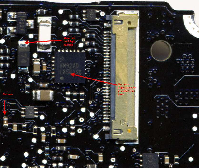

1) The fuse: A very tiny component showing a little dot in the middle located not far from WLED
  • What value should i get when the mac is powered? I get 10.2v
When booting to test I do not not plug the hard drive.
  • I have check for continuity it's not open (so i believe is good)
2) the WLED driver: a square chip located very close to (next to) the LCD backlight cable.
  • How to check it when the mac power off (check for resistance)
  • I am a little bit confuse when reading the serial on the part (VM96AF-L85433Q I think) but on the web they talking about LP8543 made by Texas Instrument.
Is that the same part?
3) also check a part mention around the begin of this thread a part located around the WLED name 74 white a coloured band. I had same value i get on the fuse when power on 10.2v
As soon I i believe what's maybe wrong I plan to buy the part and find a professional to install it for me hoping to save my macbook pro.
Thanks for all your support
Ps: the image is from the user Dadioh.

In particular the WLED driver should be checked for failure. A useful method is to test the resistance (impedance) from each pin of the WLED driver device to ground. Typical values are shown below.
Make sure power is removed from board before testing resistance. Unplug battery or battery connector.
Macbook Pro 13"
Device LP8543 Pin 1 is lower left and counts counter clockwise around the device.
Pin Resistance to ground
1 0
2 1K
3 124K
4 100K
5 0
6 >1M not connected
7 >1M
8 19K
9 0
10 not connected
11 21K
12 >1M
13 >1M
14 >1M
15 0
16 >1M
17 >1M
18 >1M
19 not connected
20 0
21 >1M
22 203K
23 400K
24 290K

If your WLED driver is blown you may measure zero or low resistance on some of the pins that are not supposed to be ground.

Check that fuse for continuity. generally they get surged and blow. Start there as that is the most common problem. If its good then look at the actual led cable connector to make sure pins are not damaged.
Hi thanks for the tips,
The fuse is Ok as I check it with a multi-metre.
The connectors looking very good.
So I wanted to check the WLED driver chip but wanted some advice how to check it

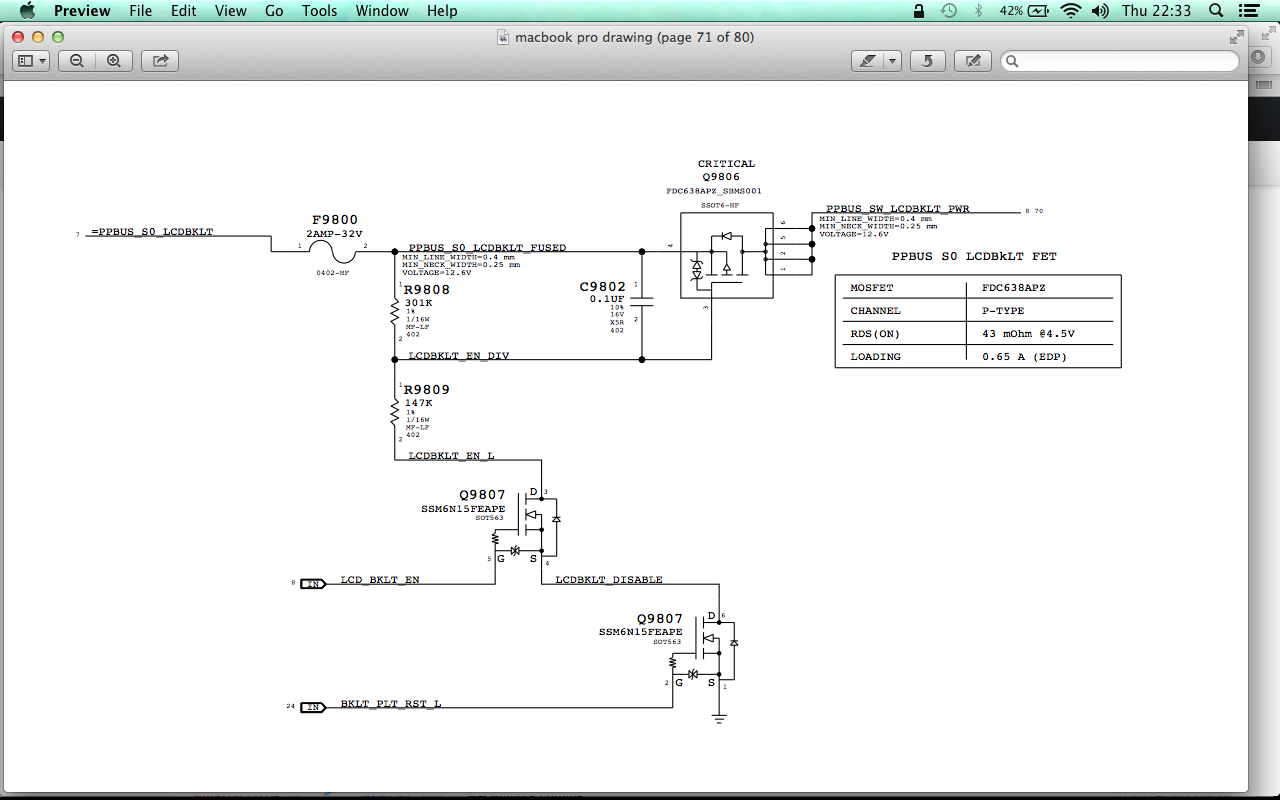

Hi i find the schematic but how to read it... i will post few picture
this a screen shots of the 2 drawing concerning the fuse and Backlight chip
and full pdf schematic of my macbook pro.
  • macbook pro drawing.pdf
If can get any advice what to test next to know what part to change thanks to for help
Hello,so :
1.You wrote you want to find the faulty part and take it to a professional to fix it for you.There's no point to get in all the trouble ,both u and us and then go to technician.We discss things here to learn and fix stuff ,most of the times,ourselves.The technician will get you the same money if you go with the part or not,and tell him what to do.So,i am not sure if there's point answering you,or if i have the right to write this,at all.Anyway.
2.WLED Driver
The results in the first page,i think but i am not sure, are a combination from reading the datasheet for this part,using Ohm's Law ,brain and experience.The part form Texas Instruments is in case you want to replace yours.2 ways to check resistance on pins either on continuity mode or resistance mode (on multimeter of course).
Continuity: Black probe on ground-red on each pin.The meter beeps on pins that are ground i think,so you determine if some of the pins that are not supposed to be ground,are.You can see this on the schematic.
Resistance : The probes the same way and compare your values with these from first post.I dont think they will be the same but huge differences mean there is trouble.(You do both measurements with the charger and battery disconnected.)
3."How to read the schematic".That's a question you dont ask.Literally.You have to watch videos,use you brain and google.Sometimes you have to search for a whole day for a single result.
4.The fuse you checked is F9800 and the part with the "74" on it is the diode F9701 on your schematic.Just to help you a little in what u seeing on the schematic on the pages you posted.
5.If you want to check more parts you need the board view file for your board,so that you can locate the stuff you see on the schematic,to where they are on your board and measure them.If you find the schematic you need a software called "test link drawing program" to open the file.
6.Also you didnt write us how the problem occurred in the first place.
Good luck!

Not for voltage.Check the resistance and compare your values with these in the first page..To test voltage on the chip you have to read on the schematic the correct values for every pin.The voltage is not the same in all 24 pins.

about the reading I have on the WLED:
Pin1: 0 (ground)
pin 2: ~1K
pin 3: ~127.5K
pin 4:~100k going down to 80K
pin5 :0 (ground)
pin6 :1 (on diode 2k reading: 0.933)
pin7 :1
pin8: 23.4K
pin9 :0 (ground)
pin10 :25.4K
pin 11: 25.4K
pin12: 1
pin13: 1
pin14: 1
pin15: 0 (ground)
pin16: 1
pin17: 1
pin18: 1
pin19: 1
pin 20: 0 (ground)
pin 21: 1
pin22: ~74.6
pin23: ~7M going down to 0.42M
pin24: ~0.41M
that the reading I had by having the black probe on ground and red one on the Pin.
