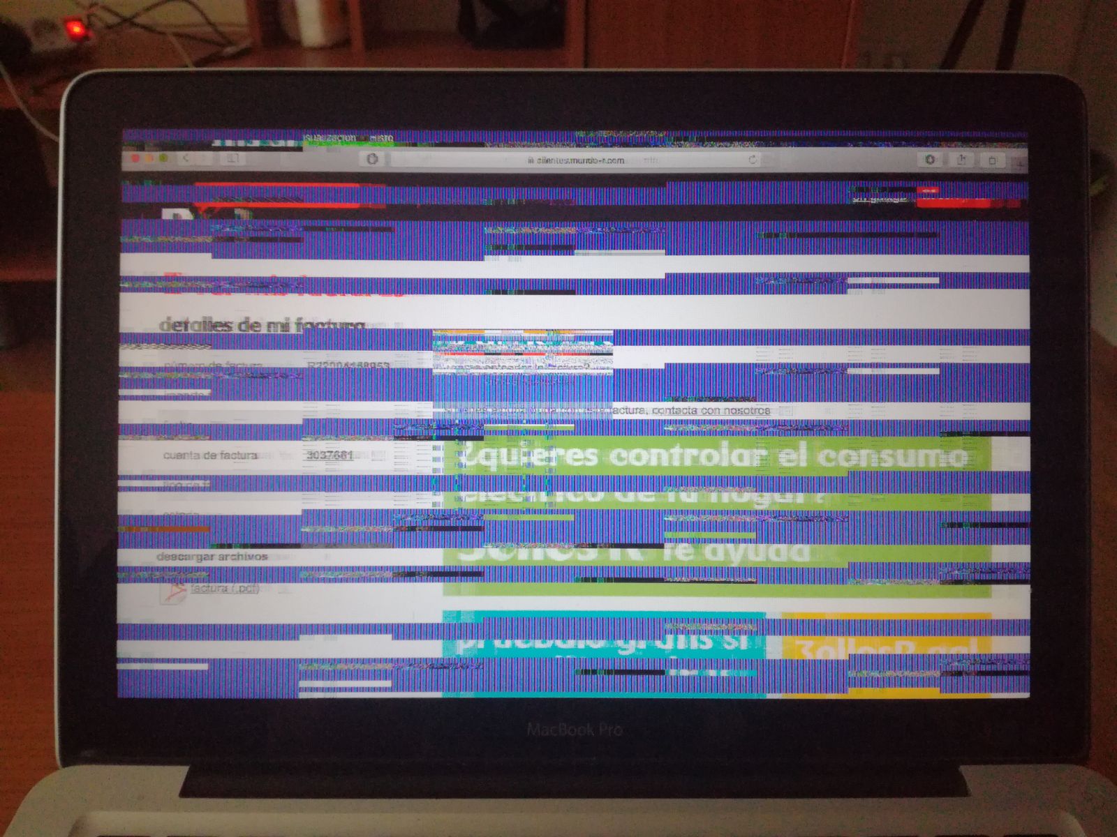

I've been having some issues with my mid-2012 MacBook Pro (A1278) which I just don't know how to solve. I have recently formatted my whole HDD and installed a fresh copy of macOS, which has made my MBP run like the first day I bought it, but these issues persist, which I am guessing are hardware related. Apple diagnostics showed no hardware issues at all.
One of the issues is that the laptop freezes from time to time, and the screen goes crazy, like you can see on the screenshot. This seems to happen mostly at the moment I place my MBP on top of a desk (while it is on), so basically when any sort of contact occurs, however careful I try to be.
The second issue is, a very loud beeping comes from the laptop, again it seems to me it happens when it is on and I am placing it on top of a desk.
Could this be the RAM getting lose and the laptop going crazy whenever I move it? Or is it something more difficult/pricier to fix?

Could be RAM or the RAM slot. That’s what the beeping part suggests to me. Not sure it would be doing any beeping if it was the display cable, display connector on the logic board, or the display itself.
I can see it’s a 13” system in your screenshot, so it’s got nothing to do with a dGPU as it doesn’t have one.
Run Apple Diagnostics through a full test (if it still happens after re-seating the RAM.)

doesn't look like problem with the battery, more like the logic board is falling down, can be also the problem with screen

If you get "3 beeps in a row" -- that's an indication of "RAM troubles".
I think that it could be:
- RAM slot -- intermittent contact from back of case "pressing on" the topmost RAM DIMM (that's why you see it act up when you set it on a surface)
- Also, the SATA ribbon cable that connects the internal hard drive to the motherboard (it's a "known weak" component on the 2012-design non-retina MBP's). The cable "wears" the internal connections go bad, or sometimes it even "shorts out" against the back cover. Although this doesn't sound like a problem that would give you "the three beeps".

With the RAM, you might
- take off the back cover (you need a Phillips #00 driver for the screws, and pay attention to where "the long screws" go).
- gently remove the RAM. Clean off the contacts, then reseat the RAM back into the DIMM slots.
Put the back on and see if that changes anything.
If you're STILL getting the display problems
- Take off the back
- Remove the RAM DIMM "nearest to you" (topmost slot with back off). Leave it "out" for now.
- Put the back on.
- Try to boot and run that way a day or two.
Do you still have the same problems?
If taking out the upper RAM makes the computer "run as it should", then what I would do is:
- Buy an 8gb DIMM and put it in "the BOTTOM slot" (with the back off)
- Leave the top slot "empty".
If that works, just leave the bad RAM slot empty, and go with "what works".

It might be the RAM. It came lose in my computer and there was a beeping with it. As for the screen, I don't know the answer for that.
Macbook pro-13inch mid 2012, MacOS Catalina. 12GB RAM (8gb + 4gb). I checked the battery all good. I removed the 4gb RAM and it stopped beeping and freezing with the weird screen. This worked like a charm.
