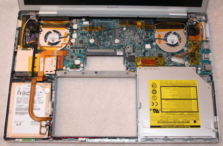

Mine has a small rattling noise, in addition to the roaring chainsaw noise that already comes when the fans throttle up to ~3000 RPM. In the top left hand corner, there is only a fan, and the GPU. I know this because I'm one of those people who just tear down any new computer they buy.

What are you talking about? Fans are on both sides.
