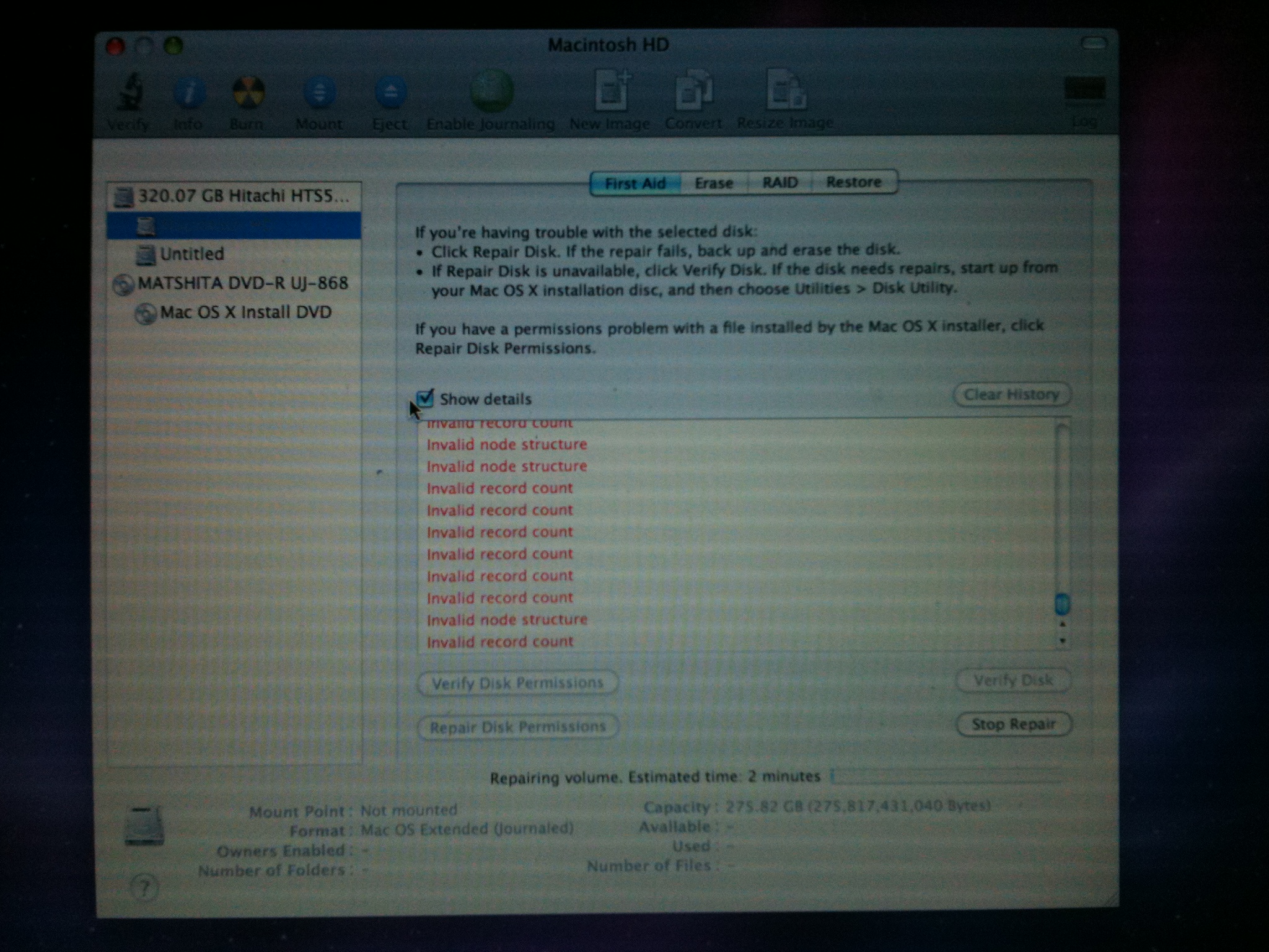

I booted from my install disk and I ran the Disk Repair on my Macintosh HD.
I ended up with a lot of "Invalid Node Structure's" and "Invalid Record Count"
(Picture Attached)
I left it overnight to continue 'repairing', and in the morning after it completed, the software told me that the disk could not be repaired and that I need to backup and restore the harddrive.
Do I have any other solutions? Or am I stuck with just backing up whatever I can and restoring?

No, that's not the correct solution here...
Is this doing an Archive and Install? If I do this will my data and files still be present after the installation?
If that would work here, then the answers to those questions would be Yes and Yes.
However, you need a tool like DiskWarrior to repair your disk. Your other option would be to back everything up and wipe the drive. DiskWarrior costs $99, but it will almost certainly be able to fix the issue (unless the drive is actually failing, but those problems usually just indicate data corruption).
