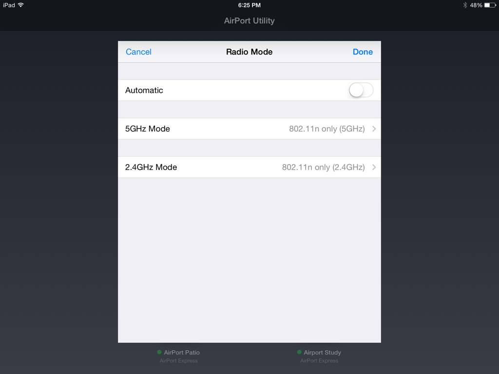

I still suspect something is dragging the airport down into G compatibility mode. I lock mine to N only so it doesn't happen. Try that.
Under advanced, wifi settings, radio mode

Ok, I take that back, I was able to put the router in N only mode via the Airport utility on the iPad. Still isn't solving the problem. I again got one speed test at 50mbps, but can't get it again. Macbook still getting 110-120 every time.
