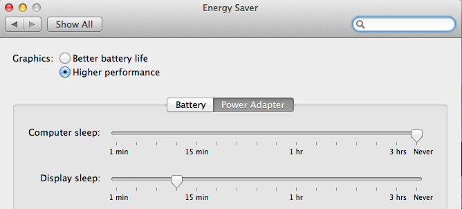

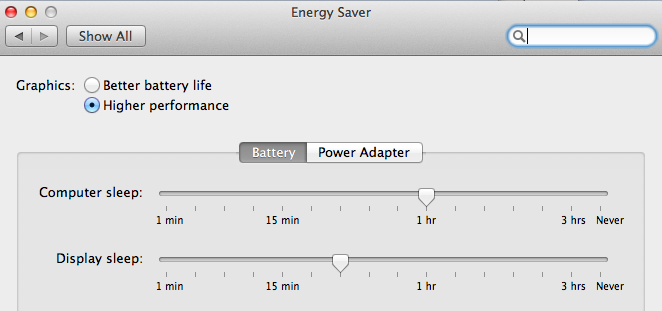

Check in Energy Saver Preferences for both conditions: with the Battery and when connected with the Power Adapter.
Maybe one of them is set to Never.
Or are you using/running a software called Caffeine?
