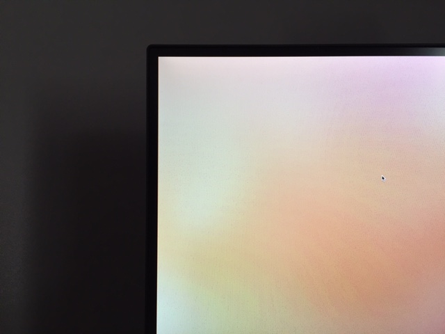

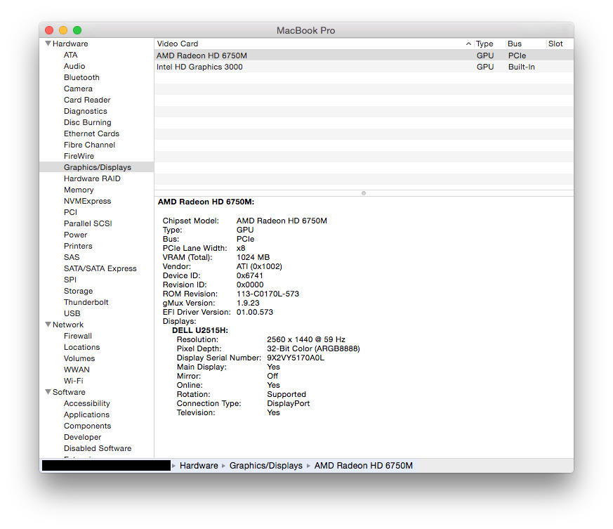

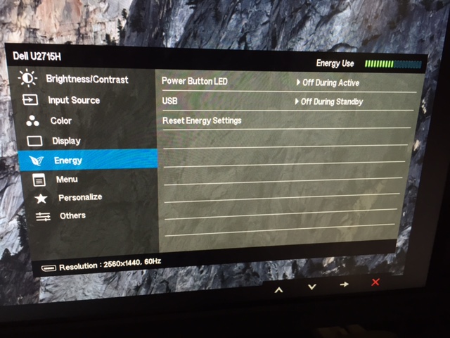

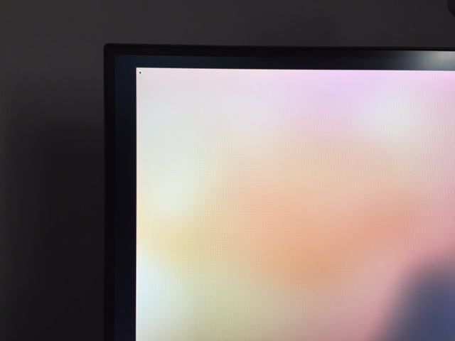

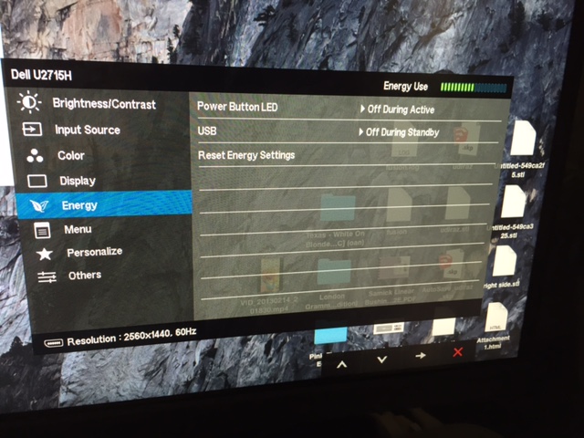

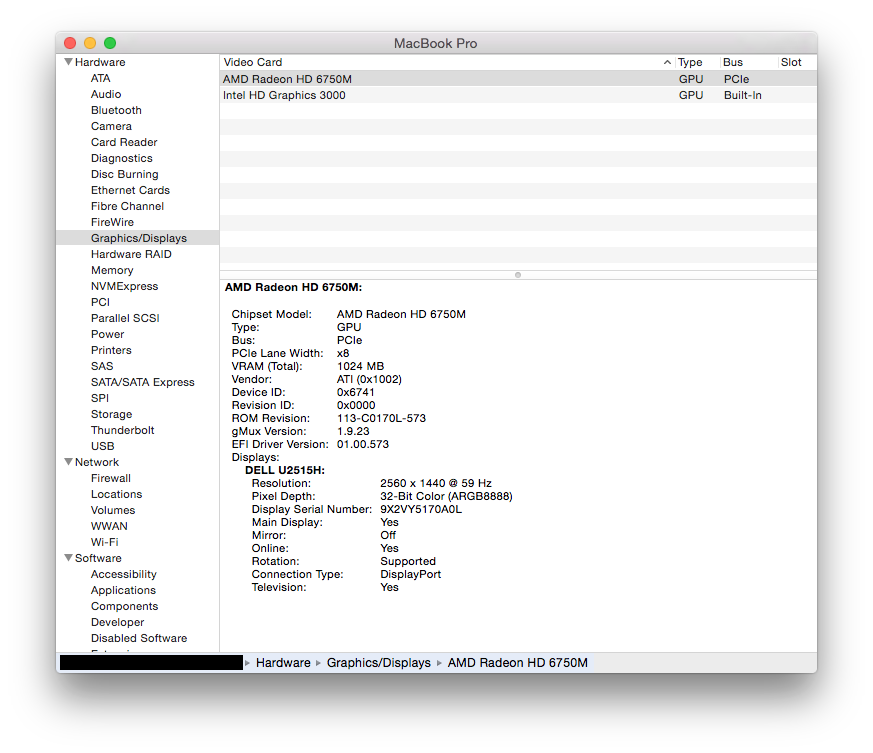

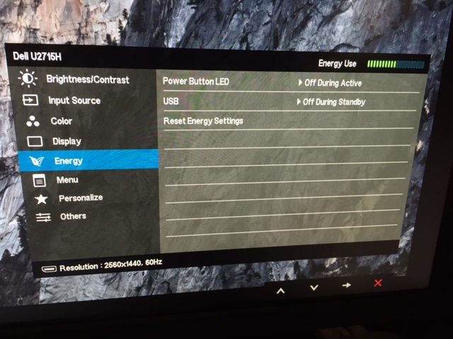

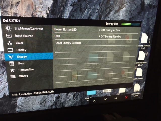

Could either of you post a photo of the problem with the monitor's OSD showing as well as System Information's "Graphics/Displays" section open in OS X?
ok, here are the photos...
Any clue?
- Weird. What does System Information say, and which options do you have in System Preferences?
Try creating a new user and see if it does the same.
OK, I see the same as you on the information screen.
However, first lead it's a SW problem, loading the recovery (cmd-r) and the screen align perfect in the recovery screen...
