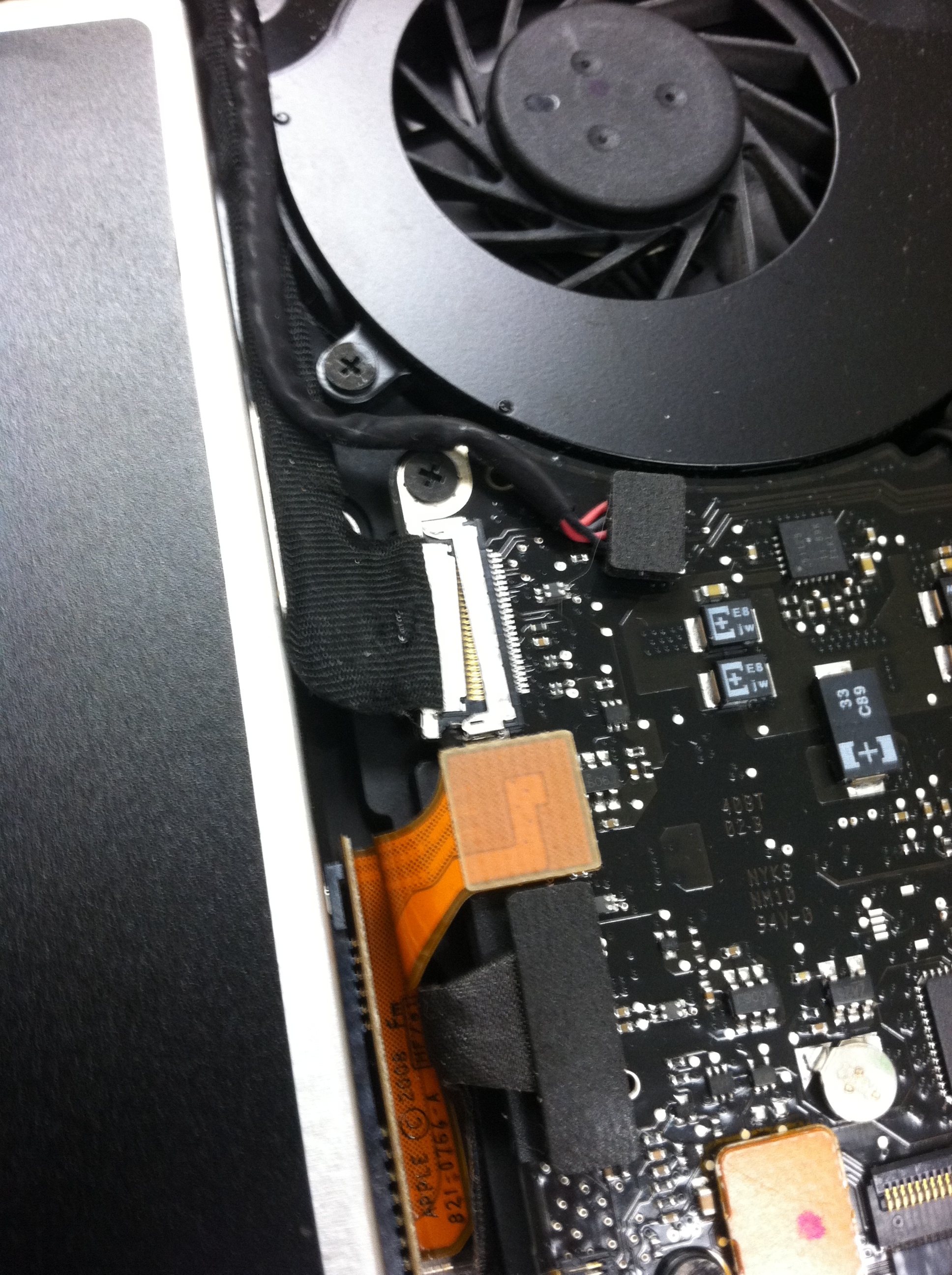

FIXED IT.
being a guy and not asking for directions is one thing... and its the way I am. I did ask for help but my very last resort was to go to the genius bar. I decided I would take my MBP apart, see if anything is obiviously wrong with the machine then pop it back together if I couldnt see anything. After watching a video on how to remove the logic board I took my unibody cover off the bottom. Before I could even put my magnifying glasses on to look at the multiple plug in ribbons I saw it. The cable that runs the isight and bluetooth module was plugged in crooked. So I used my mini flat head screw driver and clicked it all the way in. I was somewhat excited at that point, but wasnt going to get my hopes up. I then decided to check and tighten any screw and or connection into the logic board. I then popped on the unibody bottom, battery and battery cover and crossed fingers and toes. I turn on the computer and see the bluetooth icon in the top corner, then turned on photobooth and to my amazement saw myself smiling back at me!!! My 4 year old MPB was finally working! My office was dim this morning so instantly my keyboard illuminated too!!!! I do still have the issue with the USB hub but its the least of my troubles for now. I am buying a a/c powered hub with multiple ports to see if I can bypass that overage prompt that comes up. Anyways I am glad I didnt junk my computer or sell it for parts as some suggested just because its old. Just because you have a problem and even searched all over the net and still dont have the answer then dont give up! I have a picture of the cable attached.

Good find, that's an easy cable to not seat right, so I'm not horrible surprised. Glad it's working!
