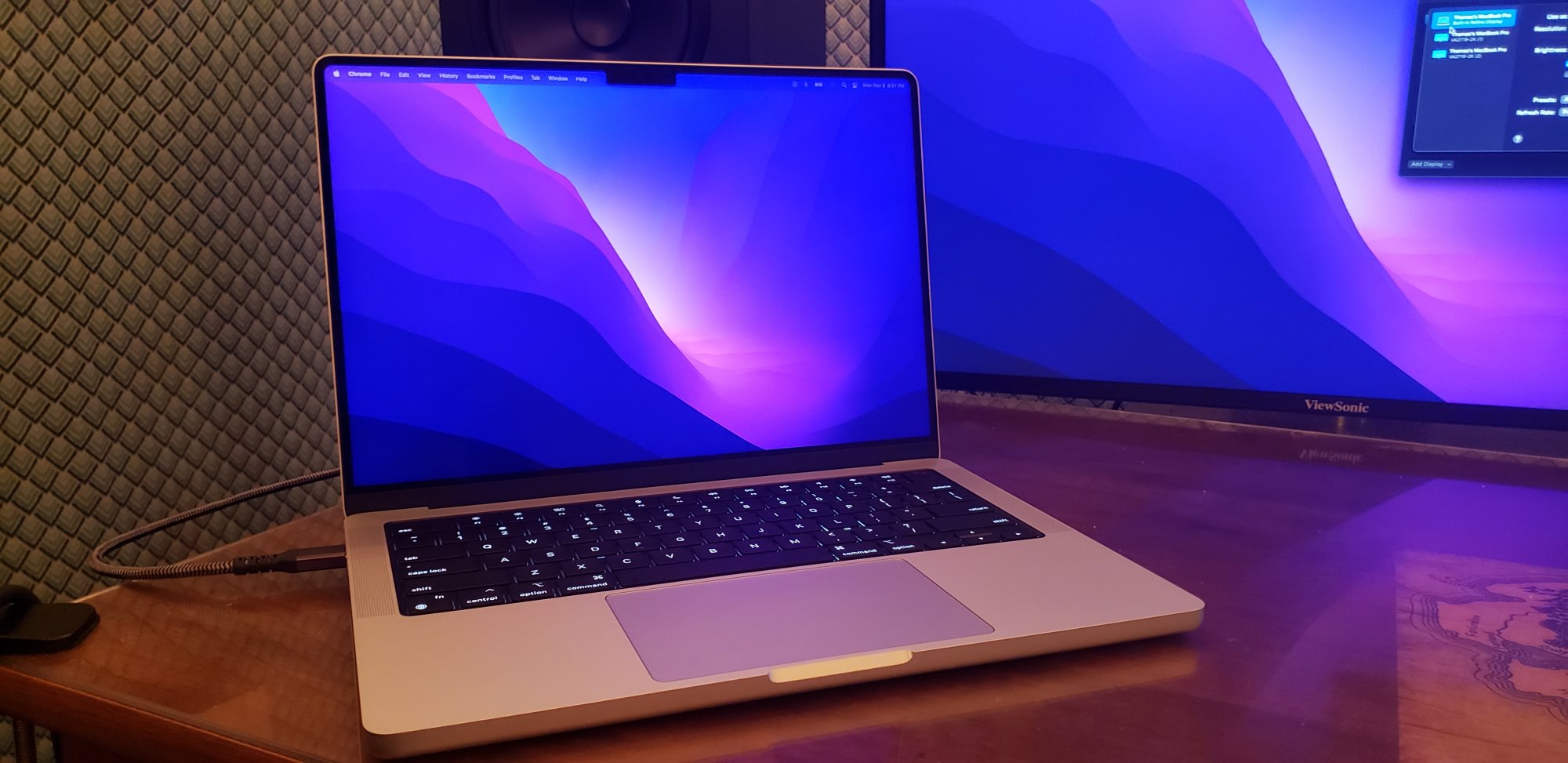

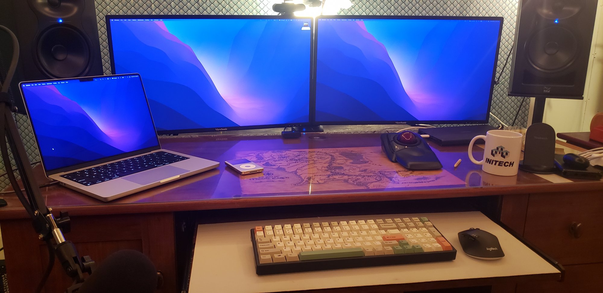

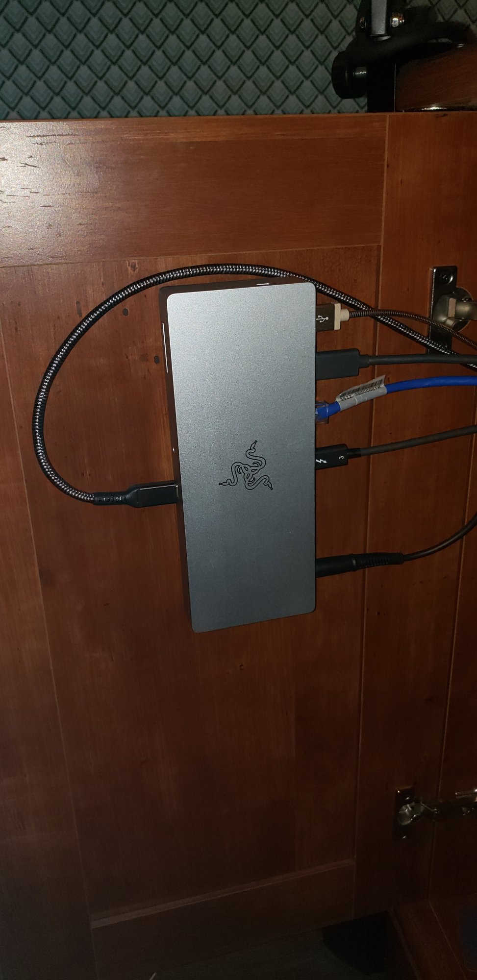

Crossposting due to relevant info re: Thunderbolt docks.
So I really did not get a chance to set it up at all until this evening. It's still not 100% where I like it settings-wise, but I thought I'd share a few images, and a short video.
I wanted this to connect to:
  1. ethernet
  2. 4k Logitech webcam
  3. Audio interface (Mic, speakers)
  4. Pair of 27" 1440p monitors
And I wanted this done with one cable.
Too many people who posted about docks, and docking solutions talked about hooking up one monitor to this dock, and another through the HDMI or a second TB port, and the thought of a spaghetti nest coming off the sides of this machine made me lurch.
But the good thing about Thunderbolt 4 is, that for it to be TB 4, an individual port has to support at least 2 displays. I'll admit, I was nervous, especially with the base 14" M1 Pro (sans SSD, upgraded to 1 TB).
But here it is. And it worked like a charm.
I routed the TB4 cable around the back of my desk to a cabinet, and mounted the TB 4 port to the inside of the door. That way if I ever need access to any USB A ports, there's always one readily available.
So it worked. A one cable solution for the office, and if I need to be on call upstairs while getting the kiddos lunch, it's easy to dock at another second monitor at a PC station up there. Super flexible. Super powerful. Exactly what I needed.
Here's a youtube video of it too; I also use the KVM switch to go between Windows & Mac OS in it.
M1 Pro MacBook Pro Thunderbolt Dock & Dual Displays

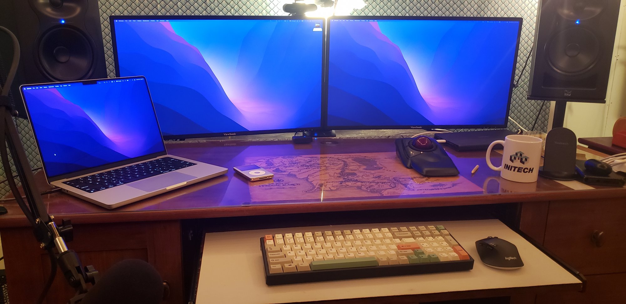

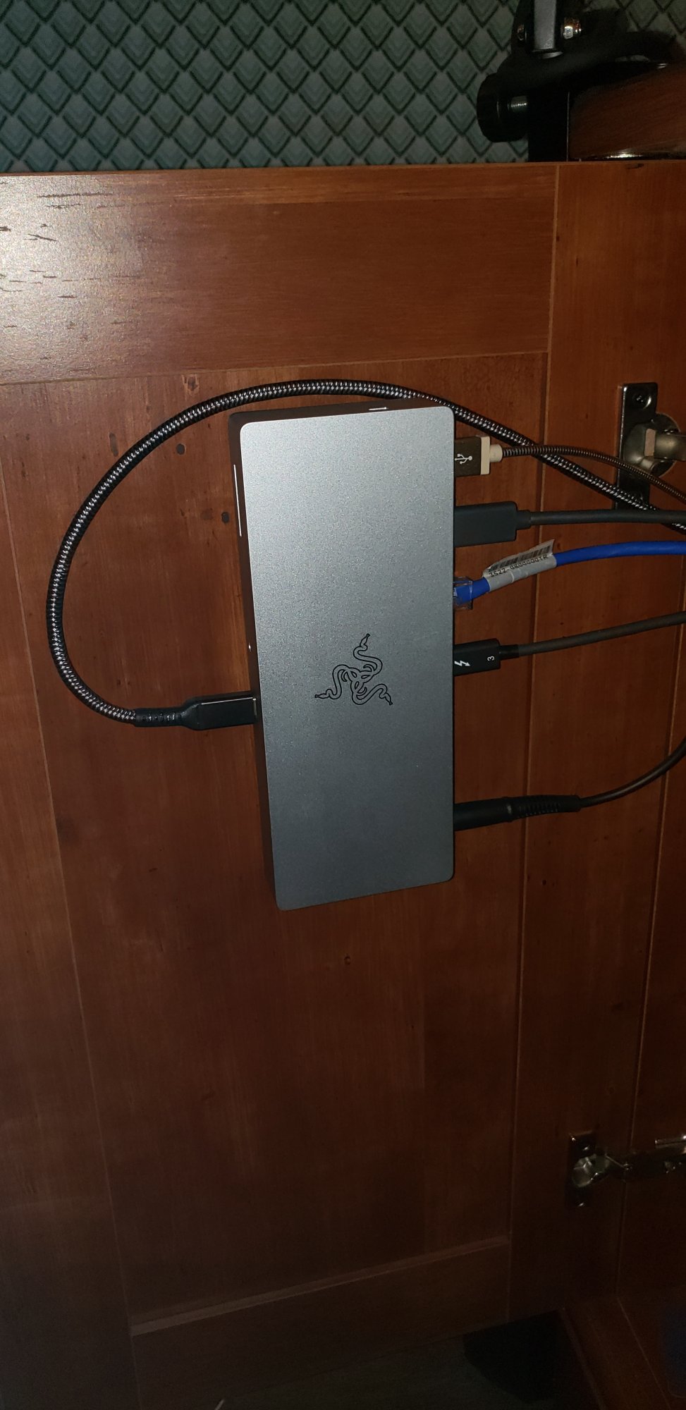

  1. ethernet
Really nice setup, and I like the effort to make it slick and neat.
I appreciate posting, and it is good to know that the Razor docks works well.

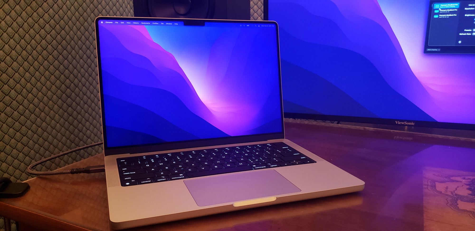

  1. ethernet
glad it worked out well for you, great setup! I've been thru 3 Razer's (2 chroma and 1 Mercury) and all had an issue sending signals to my keyboard (lights up) and external HDD's randomly when sleeping. All three have gone back and now using a Caldigit TS3 plus.
