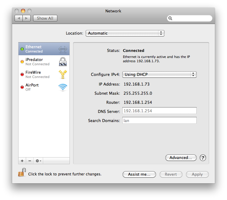

System Preferences > Network > Assist Me > Diagnostics
Are all the traffic lights green?

Open up Network within System Preferences again and navigate to to the left hand blade. Highlight the option that you use to connect to the interent (Airport if you connect wirelessly) Do you have a 169.xxx.x.xx I.P address or a different one?

It says "self-assigned IP" under Airport in the lefthand blade. Does this help?
This means that you are not receiving an I.P address from your ISP. The next question is why?

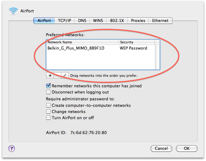

I think it refers to this screen...
Accessible by going:-
System Preferences > Network > Clicking Airport on the left > Advanced
Next highlight each network and select the minus icon.
