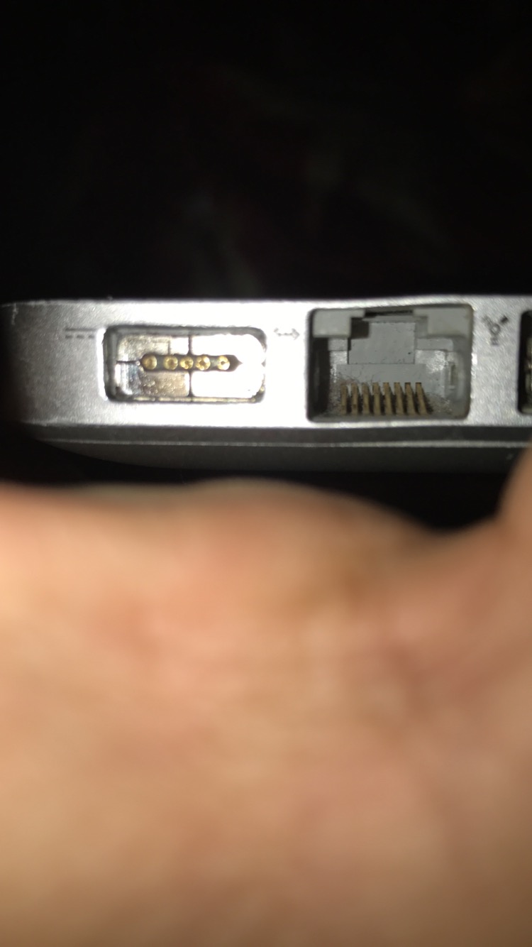

Okay so I have an early 2011 MacBook Pro and I need some help, I've had this MacBook for a while and have had somewhat similar issues that were fixed but I can't seem to find a fix for this. The problem is that my mac won't charge. I'll plug in the MagSafe charger and the light will stay green and on the Mac itself when I click the battery icon it says "battery is not charging" but the condition says normal (somewhat new battery). The light doesn't turn orange unless the Mac is completely shut down. If I leave it off it'll charge but when I turn it back on the light stays green and it'll start to loose charge. I've already tried resetting the SMC and the pram, I've cleaned the MagSafe port and it's nice and shiny, my charger is a real MagSafe charger bought at the Apple Store and it's still in great condition. I don't know what else it could be besides maybe a faulty batttery? I'm making this post to see if anyone maybe has a fix before I order the new battery. I can't post specs but it's basically a fully stock non upgraded early 2011 MacBook Pro running I believe Yosemite, only upgrade was going from 4 gigs of ram to 8

But, I suspect that your battery is not being recognized by the charging circuit, unless you do a power reset (which is what off, then power back on accomplishes)
This could be the battery - or the charger, or - the magsafe board (the internal connection that you showed in your picture)
That board has a sensing circuit that may have partially failed.

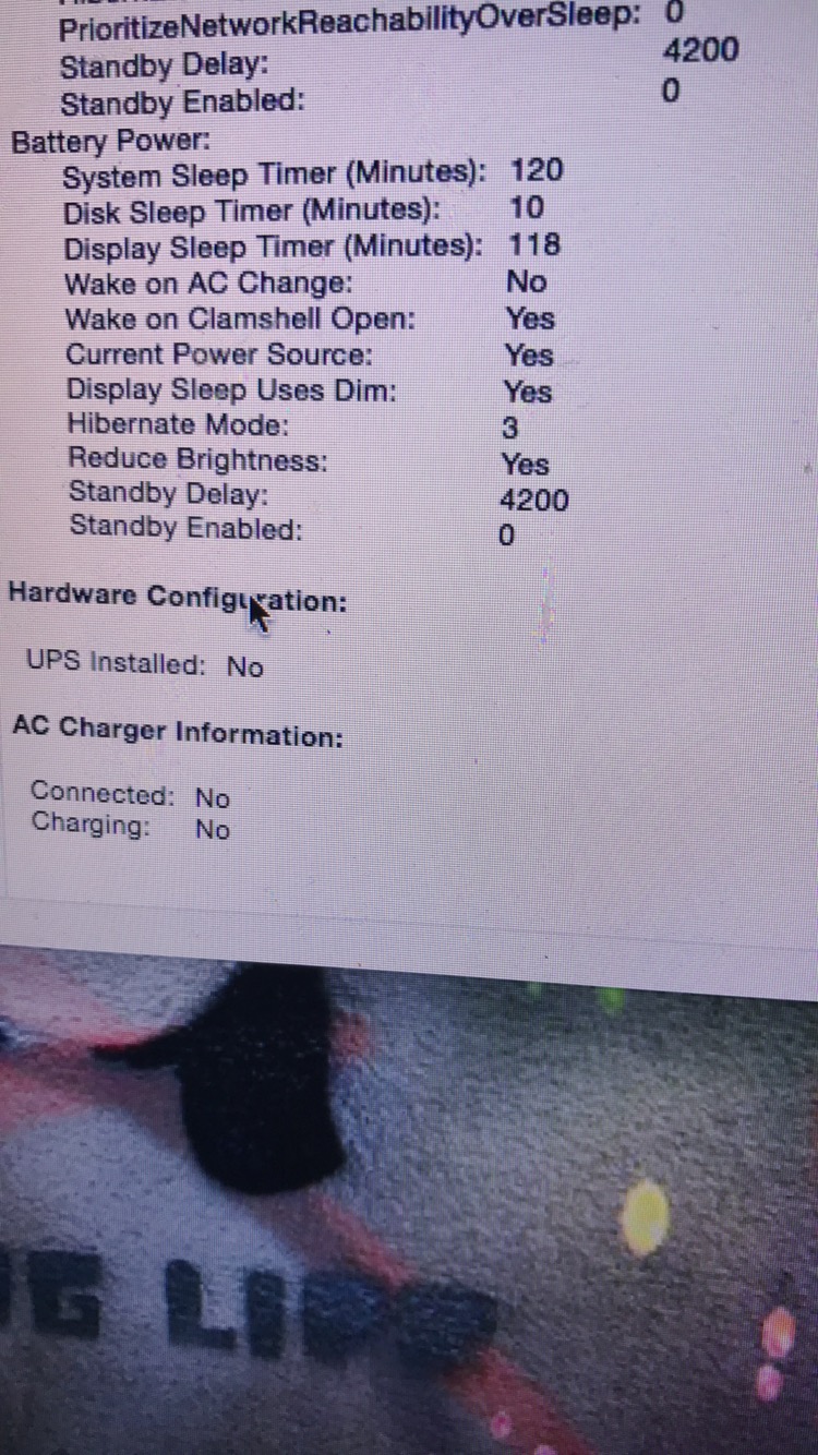

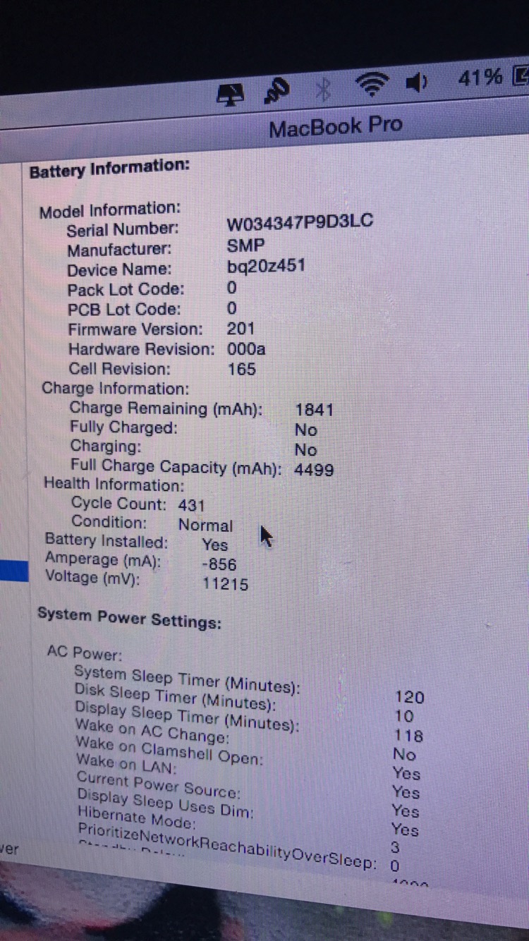

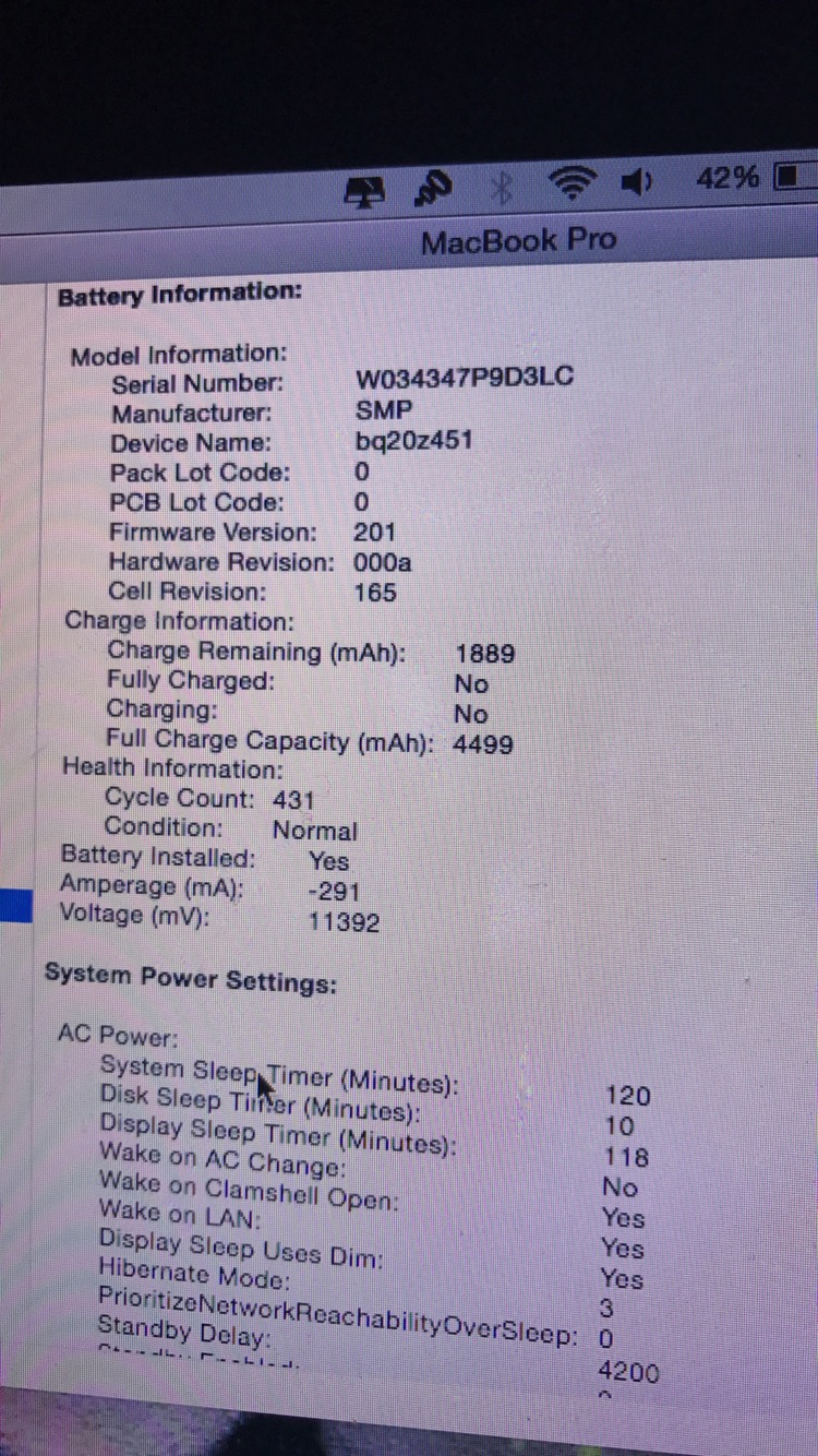

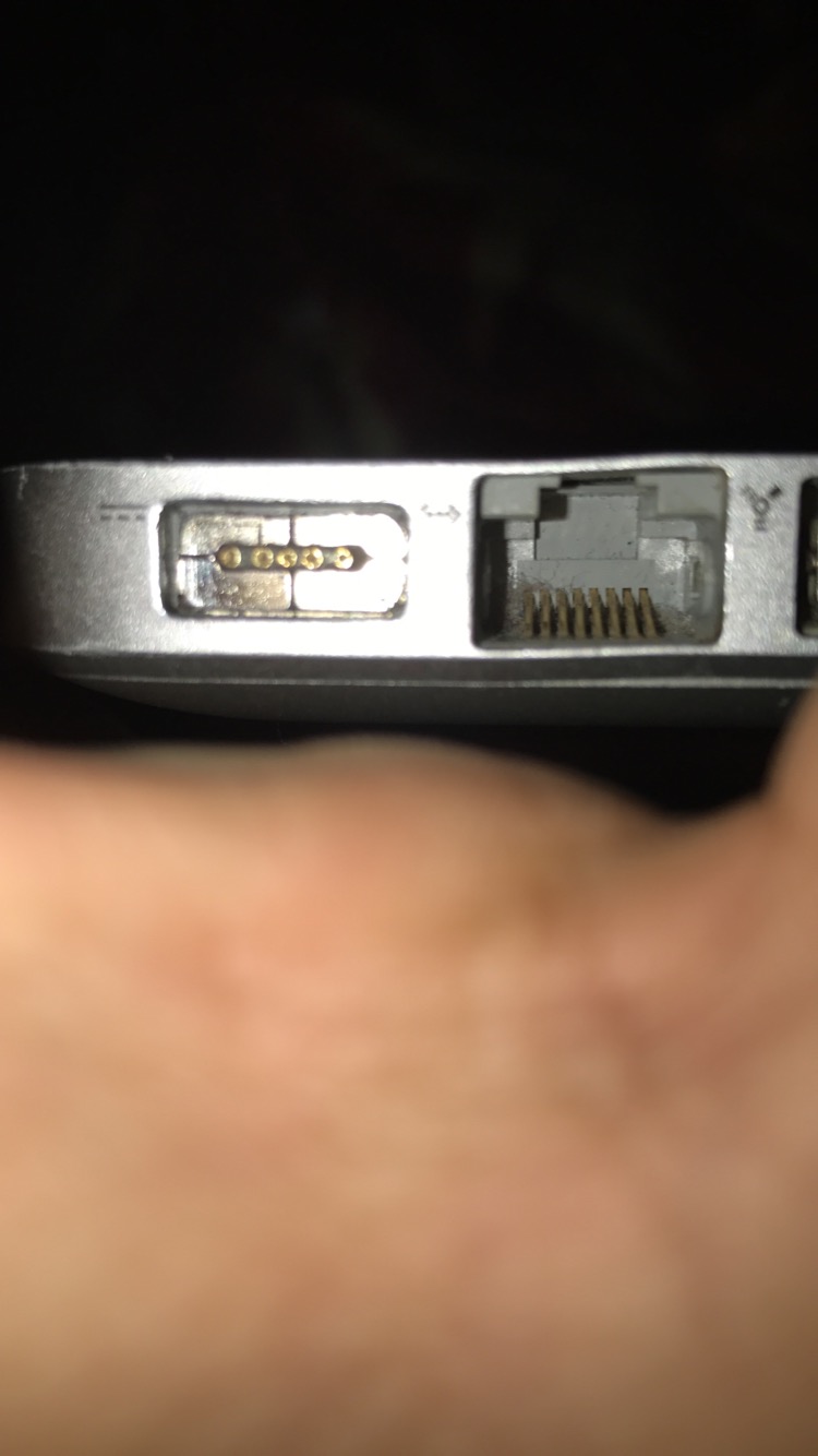

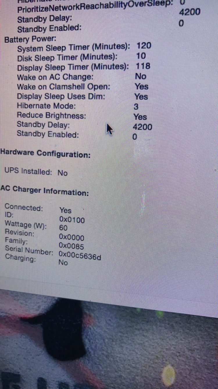

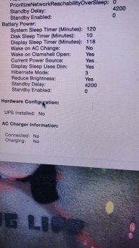

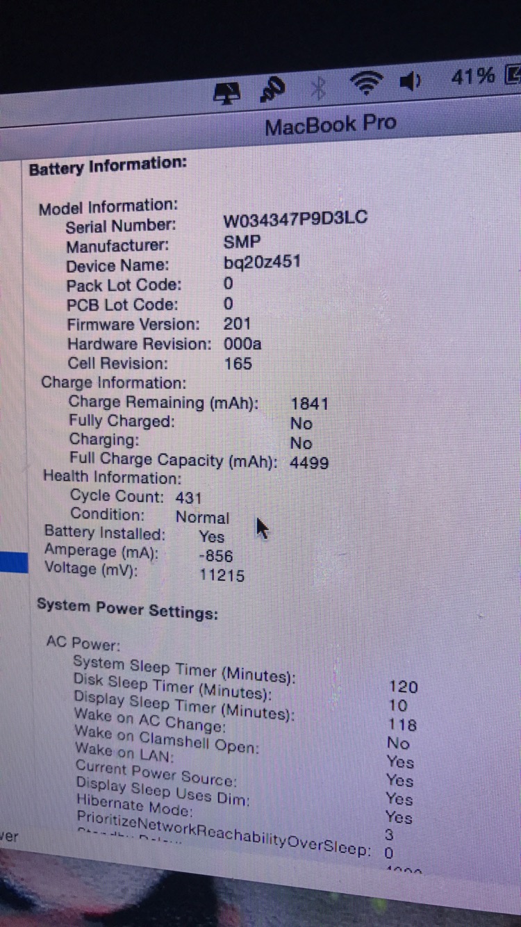

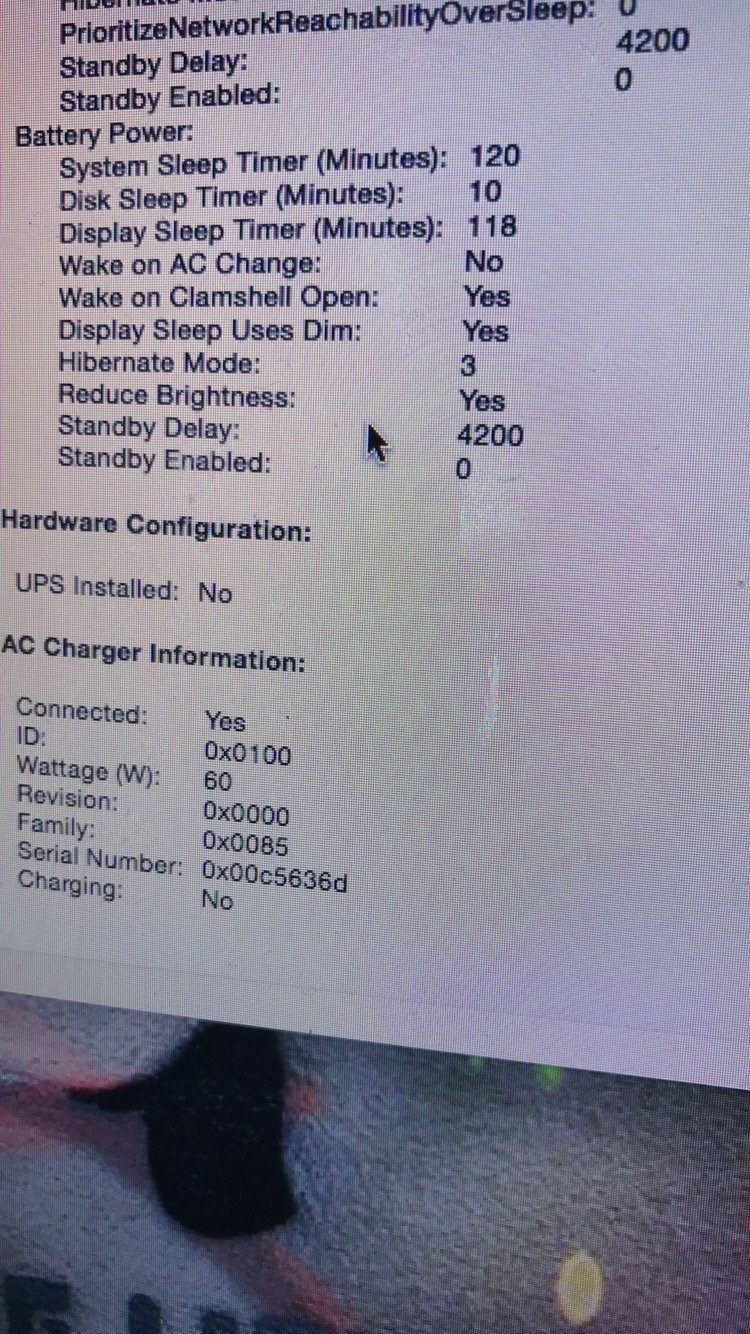

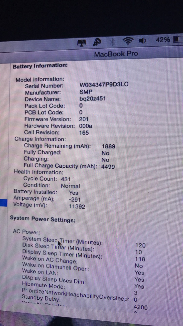

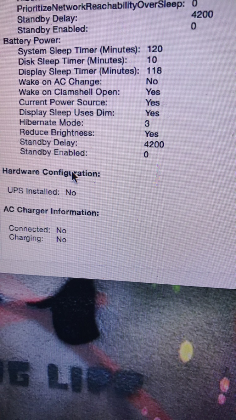

Sorry yeah here I took pictures. The first two Were taken when it was unplugged the last two were taken when it was plugged in

Yes, you should see that plugging in the charger, the charger is detected (even shows the lightning bolt on the battery icon in the top menu), and the battery is well down in its charge, yet no charging is taking place.
The battery is "OK", not great, but OK.
Your laptop detects the charger, and it appears to be part way to showing as charging.
But, the charging circuitry isn't doing that final step automatically.
I am suspicious of either the charger (easy to try a different charger - you just need to find one somewhere, maybe borrow one to test? Or a display MBPro at an Apple store, etc) That's by far the easiest thing to try.
If a different charger does the same, then I am pretty sure it will be the magsafe board. Not too expensive, and not hard to replace.
The battery will be the most expensive item. I would suggest that you try charger and the magsafe board first.
My bet is on the magsafe board.
If you tell me that is a 13-inch MBPro, then I can tell you what the Apple part number is for a magsafe board - if that will help you. Makes it easier to find, eh?
