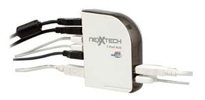

I have the Nexxtech 7 port powered hub, works great with my mbp, was only about $25 @ radioshack.
