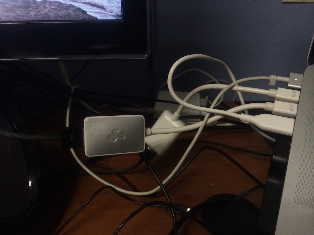

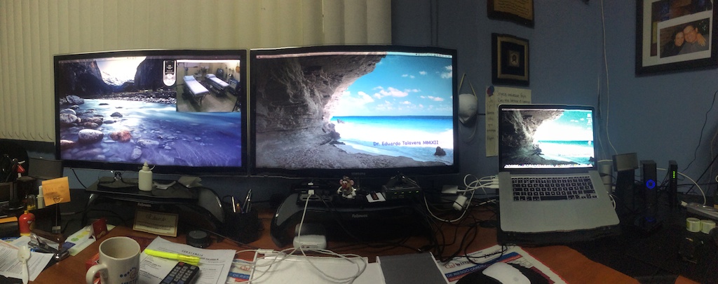

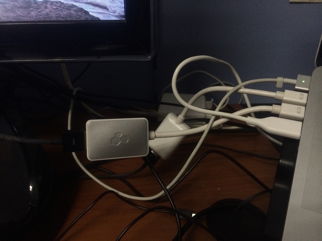

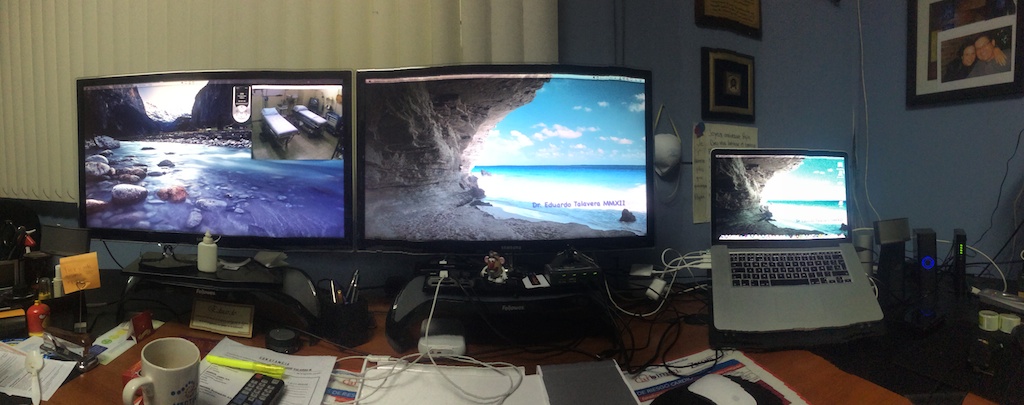

MBPr with two external monitors
Running two Samsung monitors at 1920x1080 connected through the MBPr thunderbolt ports with an adaptor thunderbolt to hdmi so i can connect both monitors.
I cannot do 2560x1600 because my monitors won't allow it.
But it handles them with no problem. Usually from 12 - 16 programs open at the same time.
MBPr 15 inch 2.6 Ghz intel core 7, 8 GB Ram, 512mb SSD
