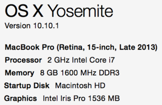

My specs:

Don't think it's a hardware problem.
Your rMBP does not have a dGPU, so a graphics card failure is impossible.
Try doing a clean install of OS X.
I think Yosemite may be the problem. I would switch back to Mavericks, but have you tried everything like doing a safe boot, resetting the pram, running hardware test etc.?
Back up your data and try a clean install of mavericks. If you that doesn't work, you will need to contact apple for warranty work, no matter how difficult that may be in your local area.
