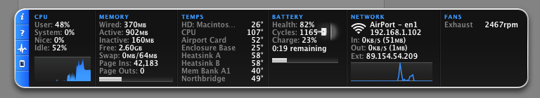

Okay I'm pretty sure this is NOT normal. I bought this MacBook in 2009 and it's been running great! Until 2011 that's when things started to get HOT.😕
I explain! Whenever I'm on YouTube Tumblr (with Gifs) etc the MacBook temps start to rise at insane levels like shown bellow.
This is Celsius NOT fahrenheit!
I've cleaned up the fans and replaced the thermal paste.. and it's still happening!
I thought the laptop would shut it self off to pervent damage when it reached 100º but no it's still going and I've seen this guy going all the way to 117º when using iMovie! I have to shut it off otherwise I'm affraid the logic board and the processor will melt!.

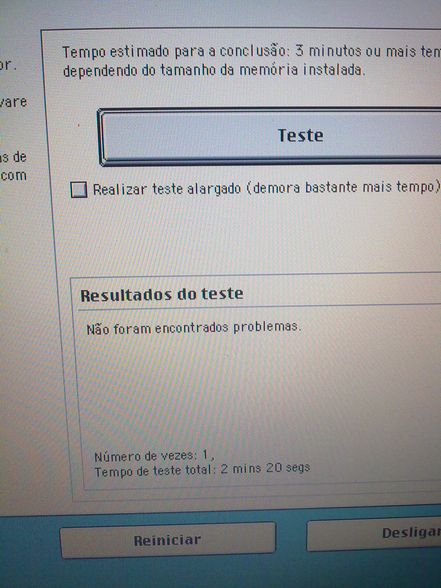

I've ran AHT and this shown up!.

Problem solved! I re-applied thermal paste on the processor, cleaned the fan blades runs a lot cooler now 😉
And AHT does not give any more errors
