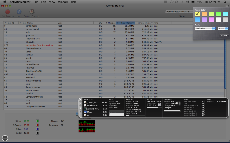

So I left my computer on last night, and woke up in the middle of the night to hear the fan running insanely loud - sounded more like a motor than a fan. Shut the computer down and left it until morning. When I boot up the computer now the fan starts almost immediately when the OS comes up. This is how the running temperature currently looks.
Question 1: Looking at the specs in the pic above -- does the CPU temperature look normal for the amount of system resources being used? I had no programs open at the time the picture was taken.

Looking at the graph, you have about 100% CPU usage (out of 200%). You're sorting by memory usage, though, so we can't see what's chewing up your processor time. Also, with that much processor usage, yes, it's normal for the machine to be hot.
Looks more like a print job that is not finished or something - is it a HP 1400 printer that is using 99.5% !!!!!
Kill the print job and start again.....
