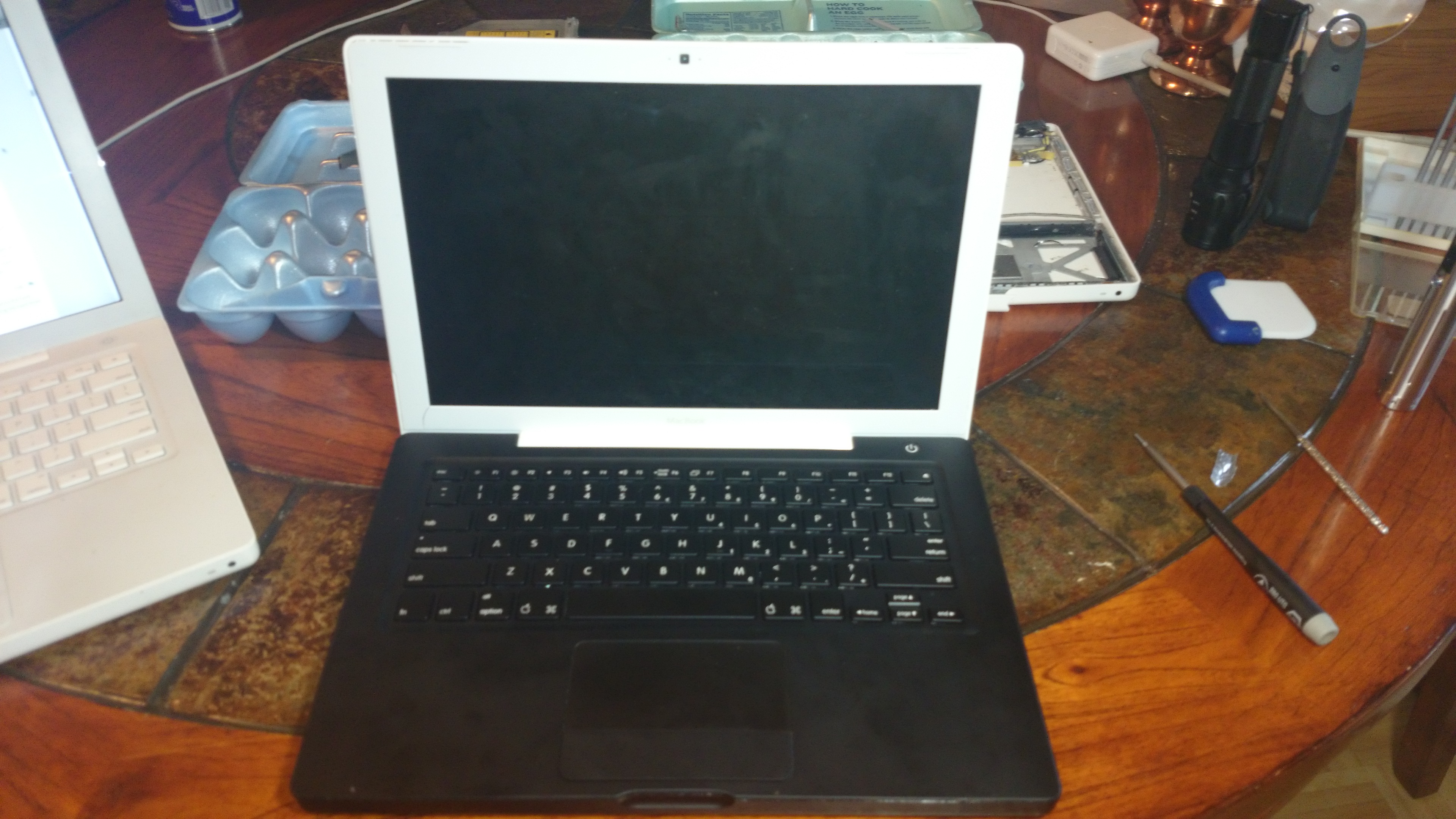

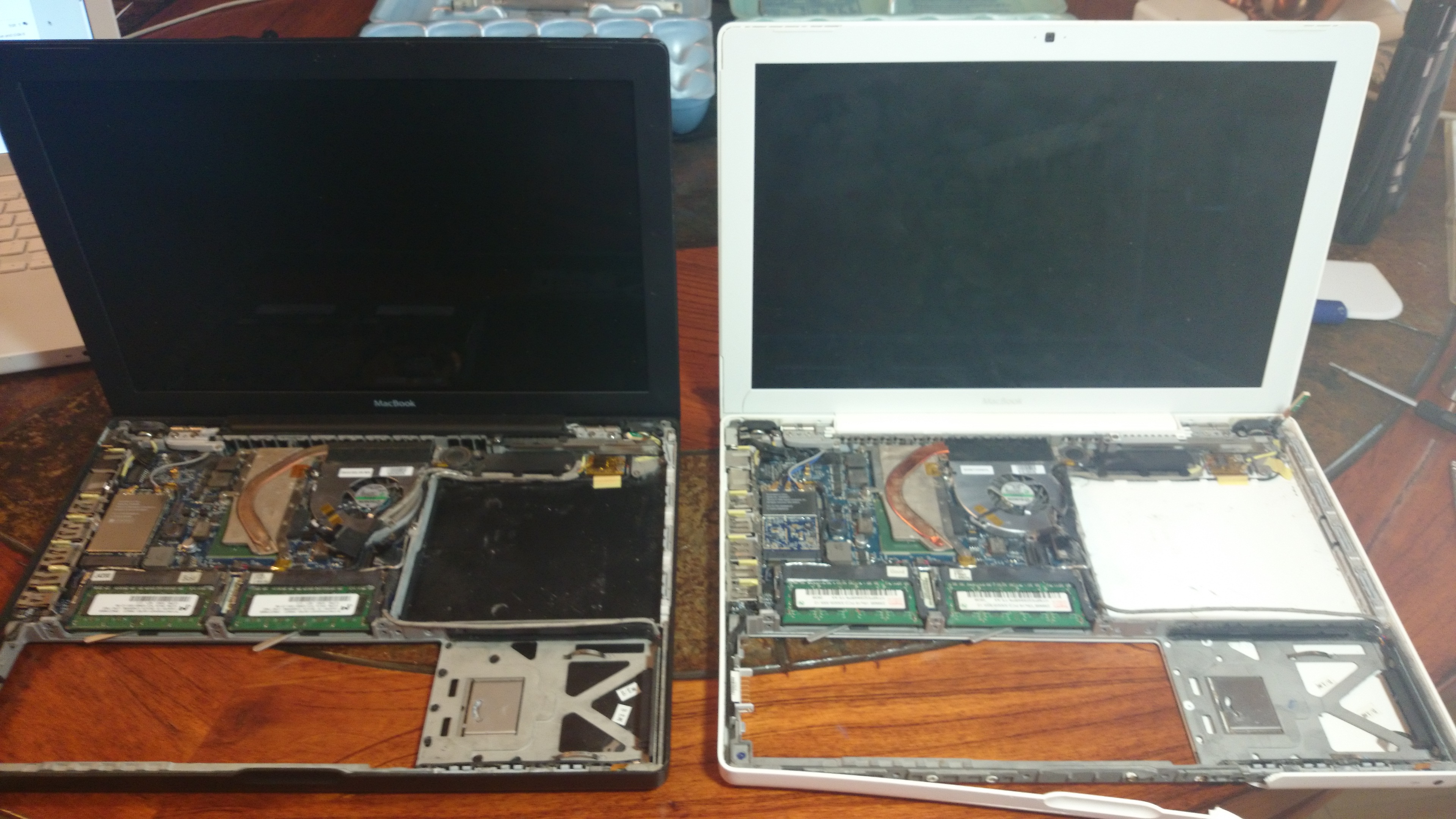

Swapping LCD panel didn't work for me.
This happened with my nephews macbook and he asked if I would try swapping the entire top panel since he got another macbook (one black and one white). Anyway, I swapped and it still goes dark after startup exactly like it did before. I guess I will try the other mentioned fixes. It was very disappointing when this didn't work out since I thought this would be a little harder, but complete fix. I also would like to mention the ifixit instructions...amazing! 🙂

Interesting looks...
Pity the swap didn't fix it, did you manage to determine if the fault was in the display or in the main unit? (by trying both the black/white and the white/black combinations)
I am giving up on it.
I think it is something wrong on the mainboard and that is above my tech level. Although, I am still open to suggestions by anyone out there. They will probably go in the closet at my sisters for years. 🙄
