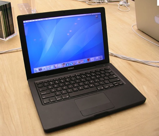

Also I attach a photo of the model I'm taking about - just to make sure🙂
It doesn't matter what model you buy on eBay. They'll send you whatever they have in stock. It is well accepted practice in this industry to sell compatible models, and to post product pages/ads for every single different model that goes into a machine.
