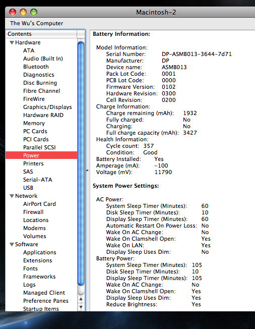

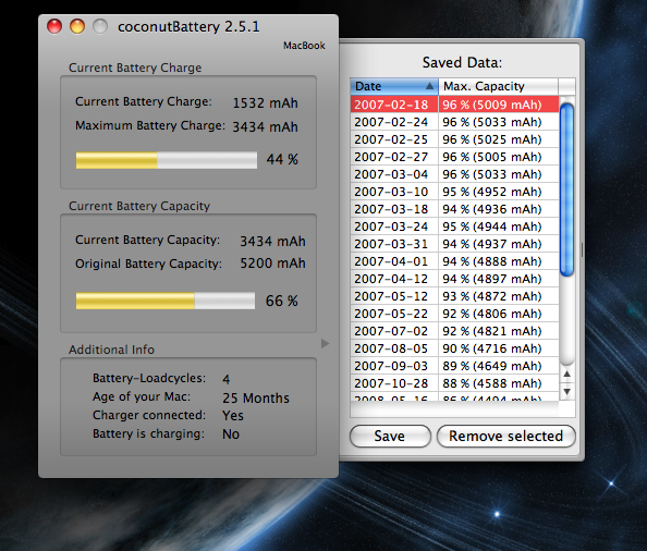

weird thing is it only happens when its on batt power. so now i'm thinking i have a shot batt? the meter says 44% but I only get 2 lights, is that right?
check it out
Just an aside, but 25months, and 4 cycles?
Yikes, that's killer on the battery...gotta unplug it every now and then, at least once a month IMO and kill it a bit.

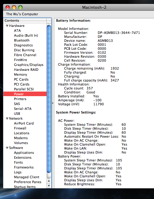

what about the batt meter? when i press it at 50% it only lights up 2 dots. Does this sound correct? or does that not even matter... the next step would be to use the MB with it plugged in to see if it shuts down by itself. if it does not then i guess i got a batt issue and a new one is in order

did my own testing.
left macbook unplugged and it shuts down at 48%. Press button on batt and it blinks. Plug it in and let it fully charge up again.
Once gone green let it stand for 2hrs and powered it back up. Batt level says 100%. Used it unplugged and watched level go down by the minutes. at about 40% it shuts down again.
Plugged it in and let it charge back up over night and let it stand there for the day while I went out.
Tried again and at around 40% it shuts down...
but when i get the batt info it says health is "good" as you can seen from my prior screen shot. i don't know, new battery i guess???
edit - when left plugged in (A/C) it has NOT shut down so...
It is a battery issue - sounds like you should "invest" in a new one..
Apple have a battery warranty extension in place but the normal cut-off is 300 cycles although it might be worth asking them........

Unfortunately, your cycle count is over 300 so there's a slim chance Apple will do anything for you. You're probably looking at purchasing another battery.
