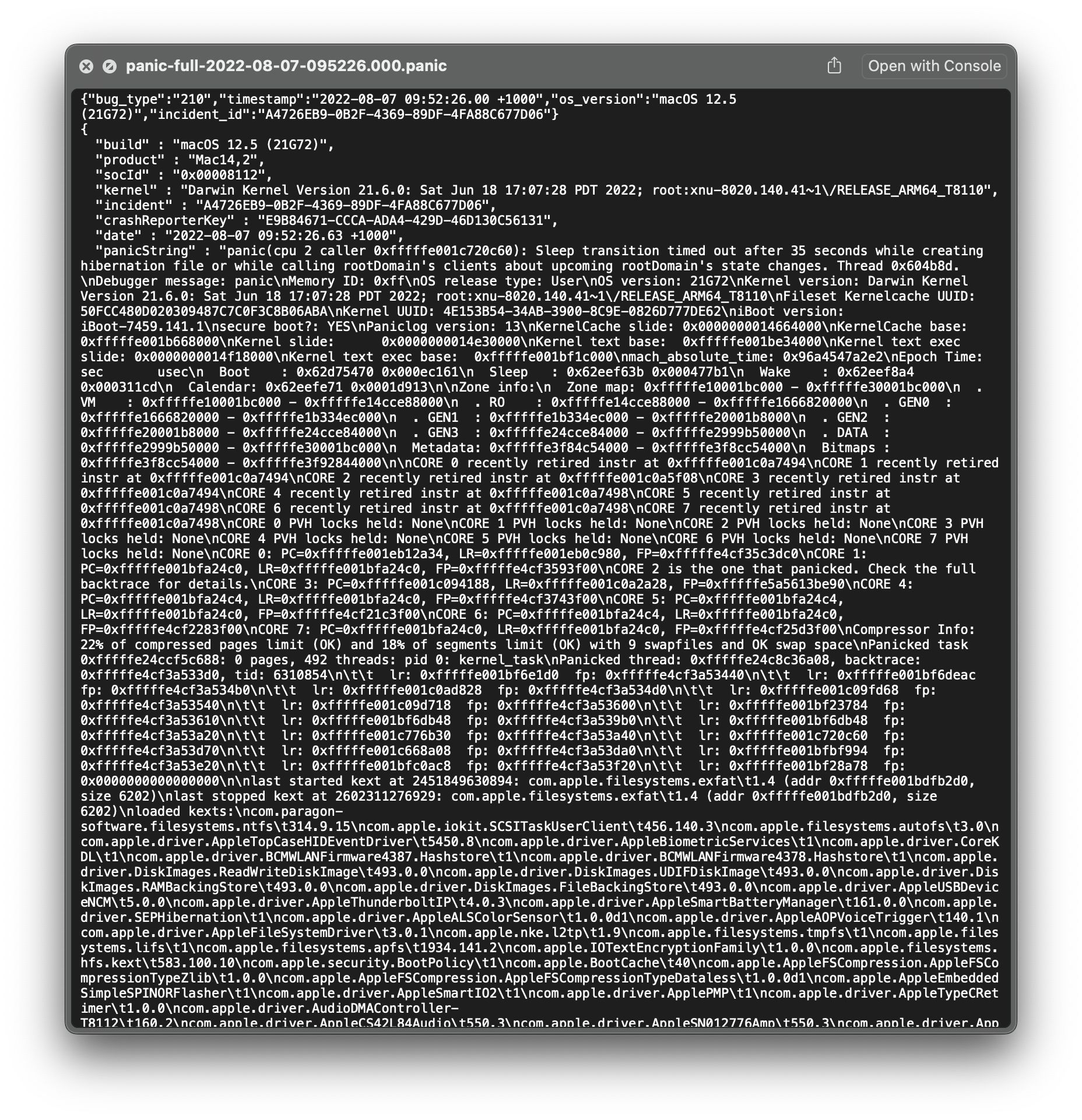

Not sure if this helps?
It sais sleep transition timed out after 35 seconds etc

It does. You should contact Apple.
Written that you might try:
Starting your Mac in Safe Mode and run it for at least 10 hours to see wether that stops the panics. The only thing I see that is not an Apple driver is the Paragon NTFS Kext that's loading - which has caused various problems previously on M1 for some people. If you don't suffer the problem while running in safe mode, start with deinstalling Paragon.
“bug_type 210” indicates its relation to encrypted storage and secure boot capabilities.
A future software update may solve the problem, and you could use
sudo pmset hibernatemode 0 standby 0 autopoweroff 0 to see wether this improves and reduces the number of panics after a normal boot. FileVault and secure boot effects this problem probably too - meaning that additionally turning off FileVault might help, etc..
If you want you can run Apple’s hardware check to have some additional information when contacting Apple. Arrange to bring it to the next Apple Store Genius bar or certified partner store - or arrange a send in - and let them check it.
Personally I simply would get it replaced under warranty - after making sure that the Paragon Kext is not the culprit.

Again: check running in safe mode - if it’s the Paragon kext, get rid of it.
