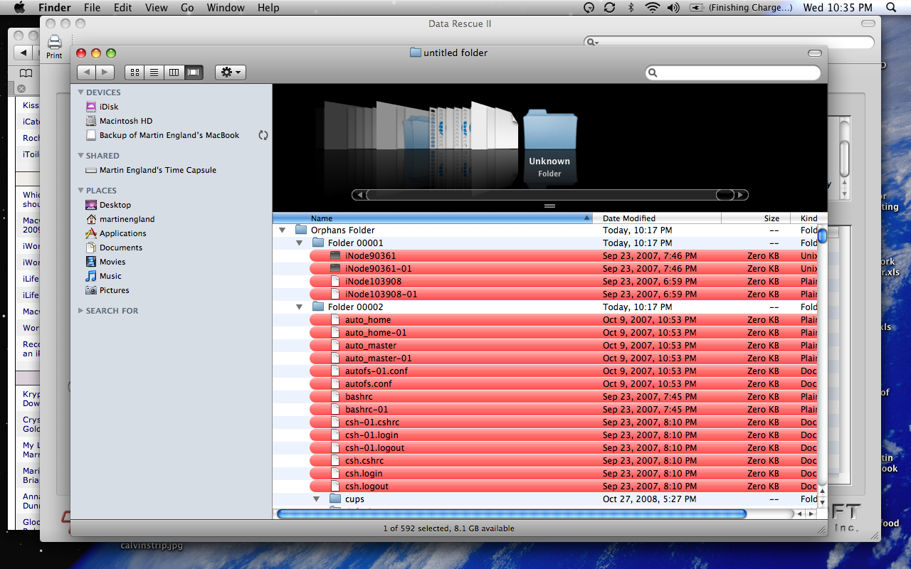

So I waited out the scan, and it came up with "something" recoverable, but it looks like this on the screen and I have NO IDEA what it means or what to do next. Anybody??
